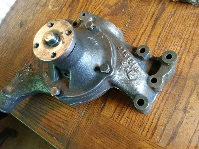

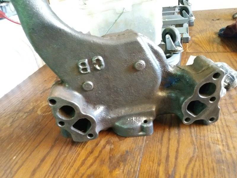

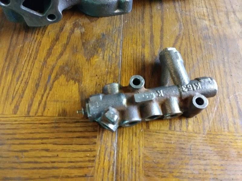

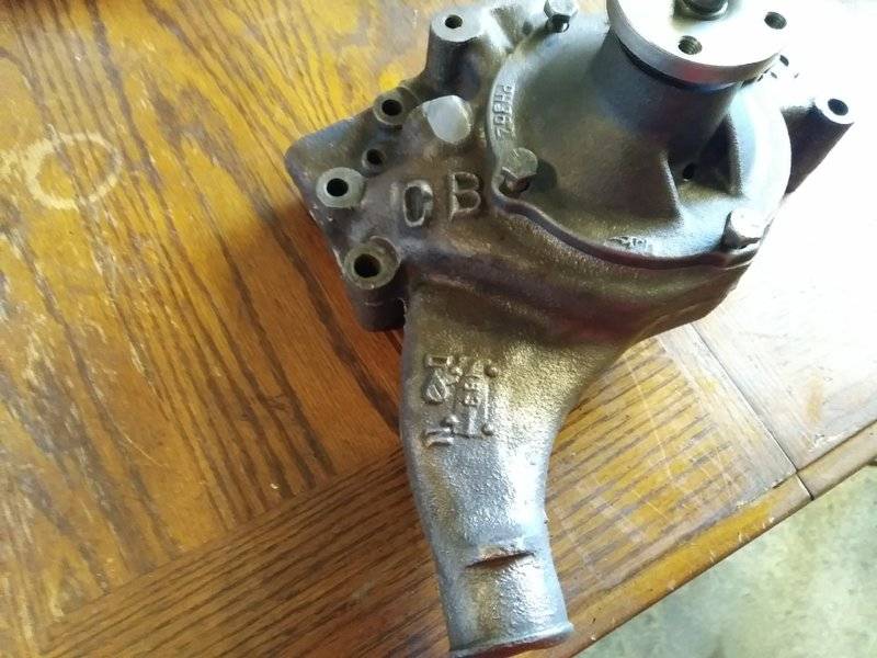

Yes. Why? Will it disintegrate after 5 seconds or something?Your not gonna use that pass. side water pump housing, are ya?
I knew that but wanted the motor home pump because the inside of the housing is like a sewer drain compared the car one that just has a little hole for the water to pass through.It’s inlet is on the pass. side, which was mostly motor homes. Cars were drivers side.

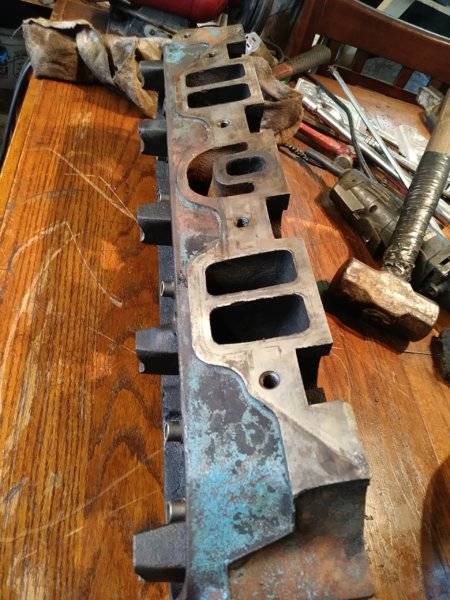

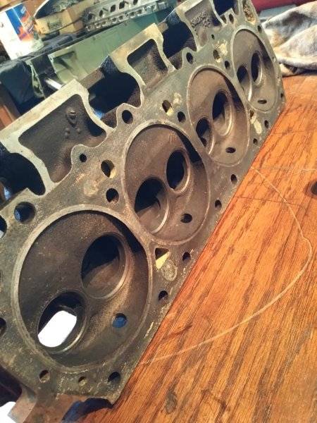

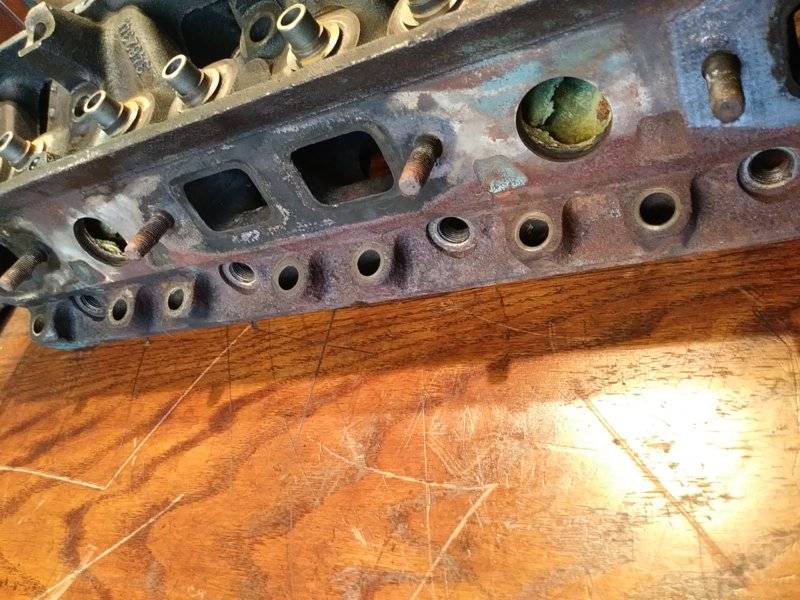

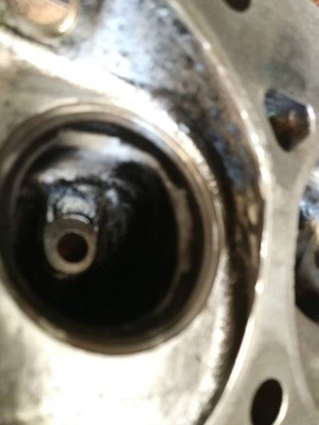

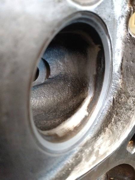

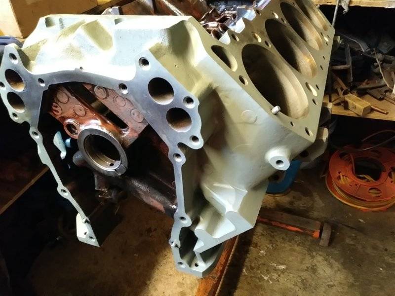

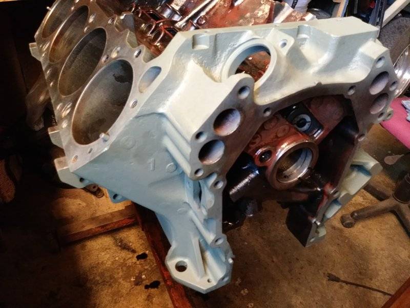

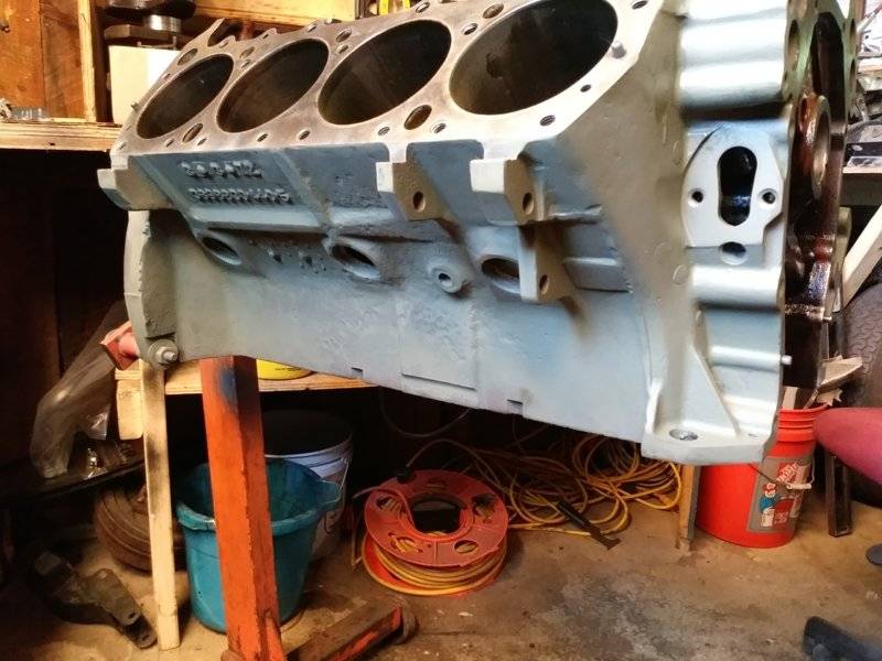

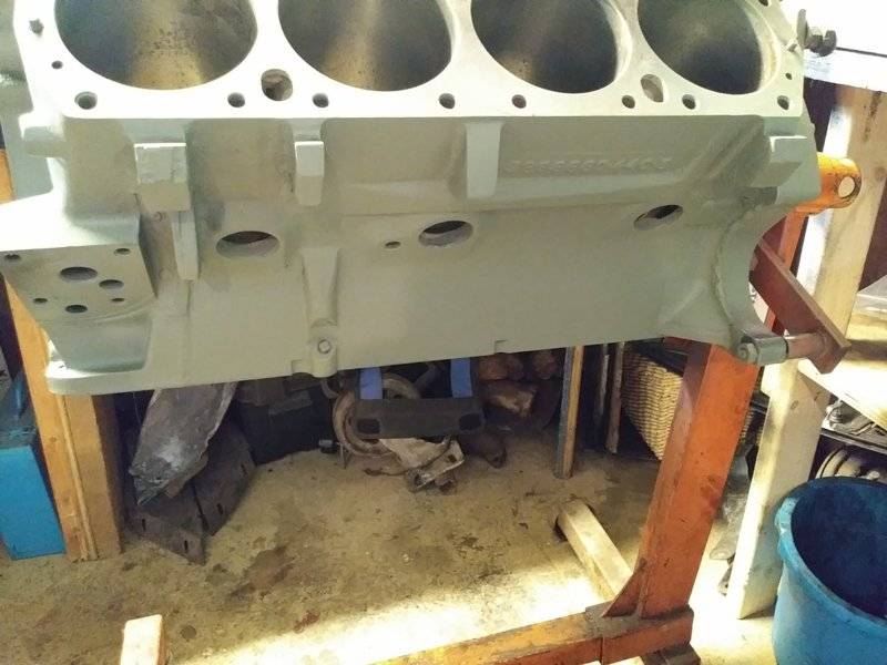

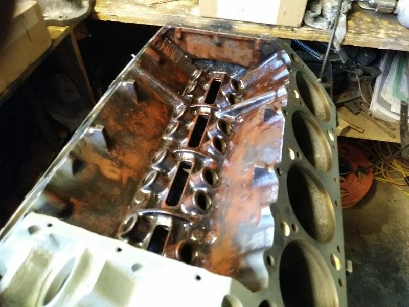

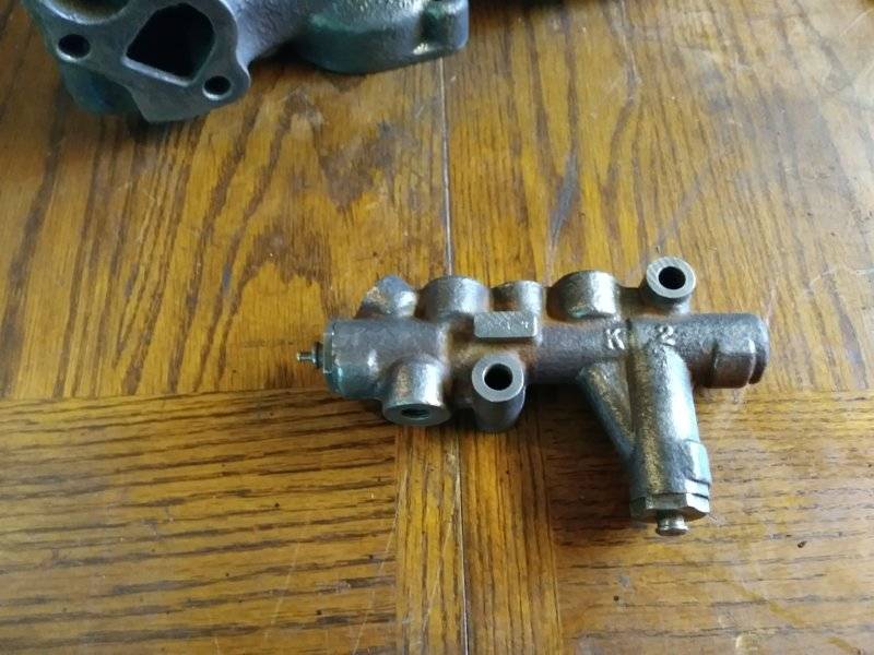

That soup/electrolysis effect, did a decent jobBlock and water pump and valve are out of the soup.
View attachment 611289 View attachment 611290 View attachment 611291 View attachment 611292 View attachment 611293 View attachment 611294 View attachment 611295 View attachment 611296 View attachment 611297 View attachment 611298

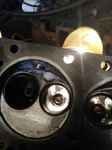

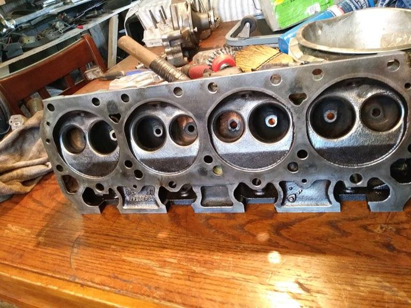

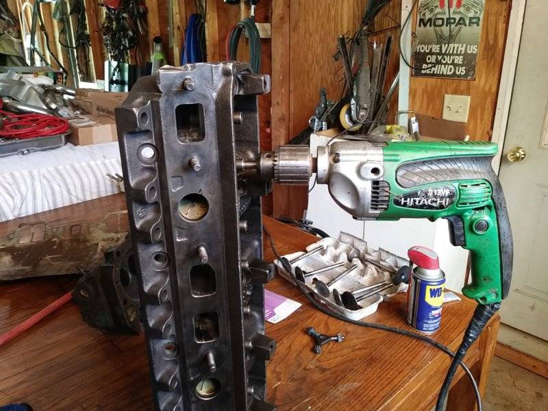

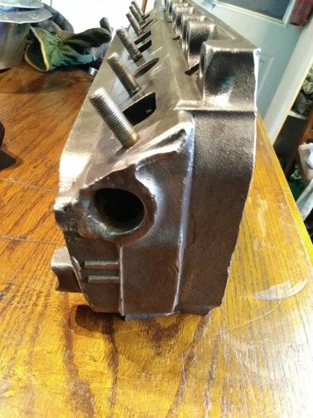

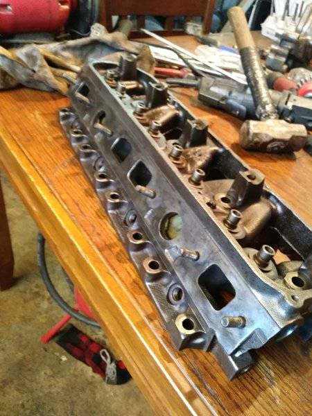

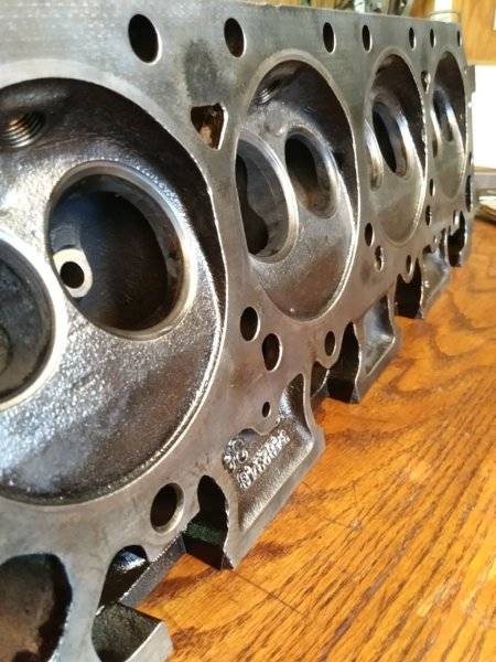

Weld with ni-rod {below} fill in the low spot & grind/file it flatMy bud Rick and I were lounging around the work table in my garage earlier and shooting the breeze when he said, " Uh Oh!"
He pointed to the valve cover lip on one of the heads. It had been repaired at some point and badly. It's the same spot that has the freeze plug screwed up. Anyway there's a slather of weld along the top and a low spot. We laid a straight edge around there and it's a freaking mess. Any suggestions? It's all across one end.

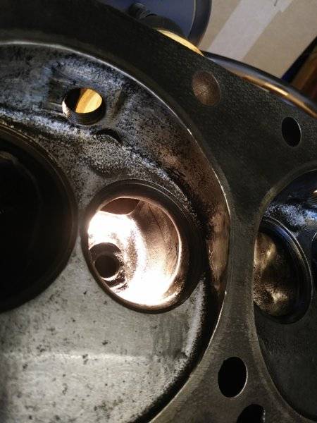

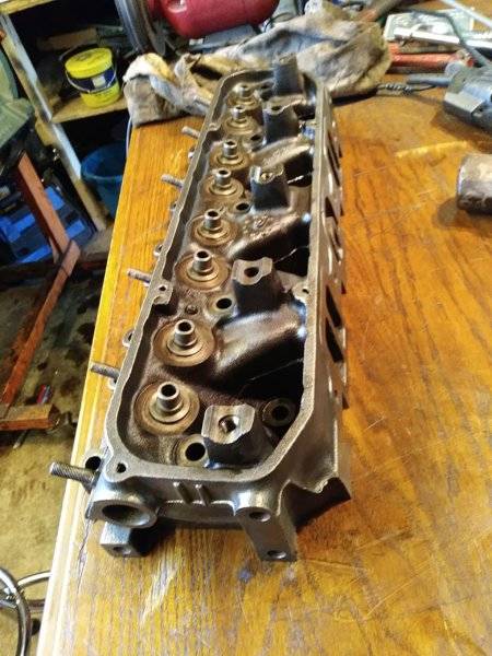

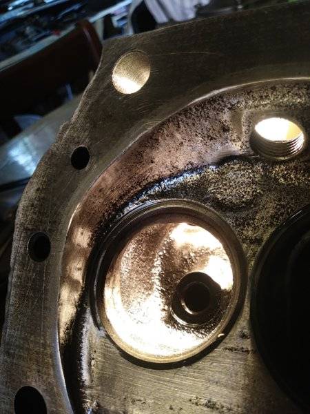

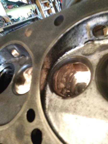

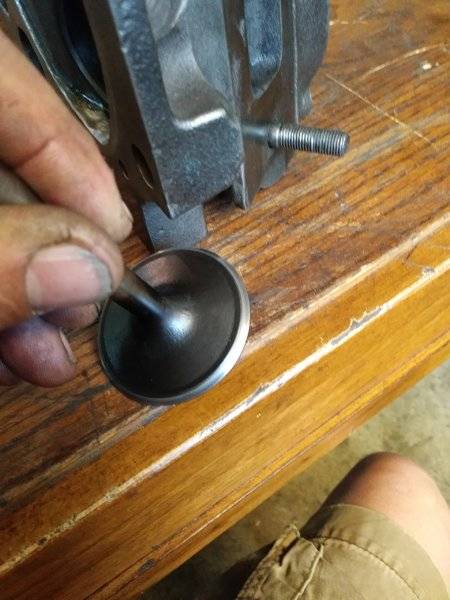

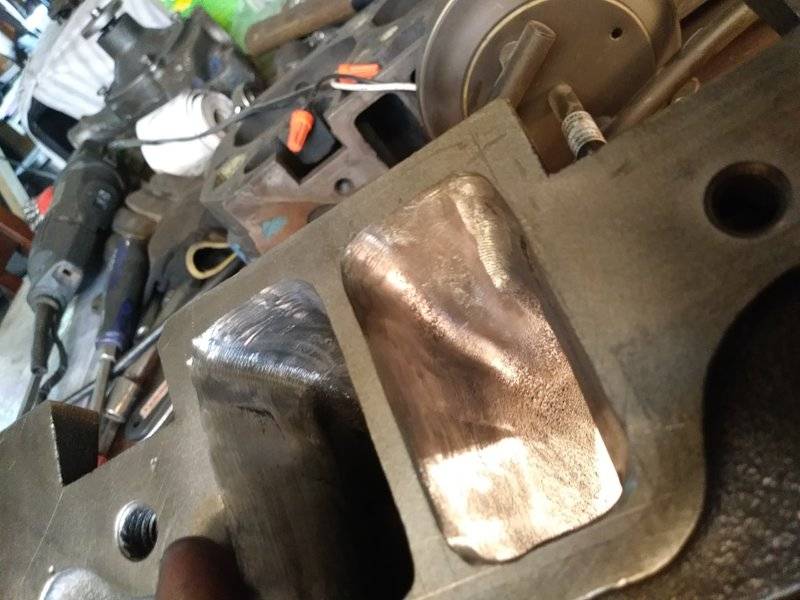

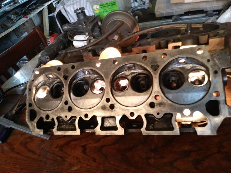

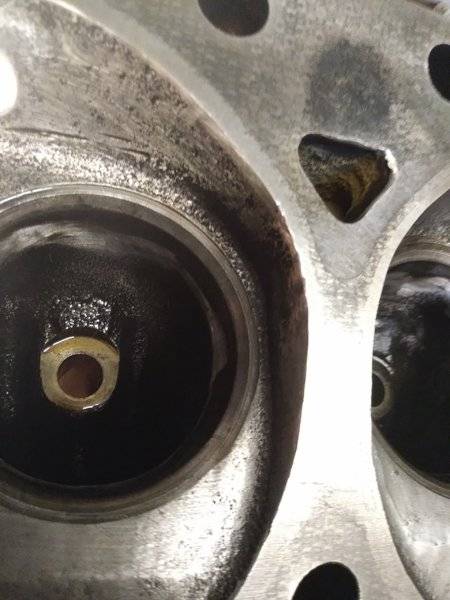

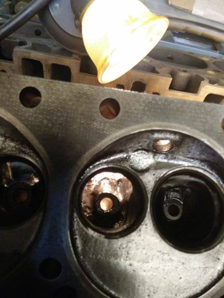

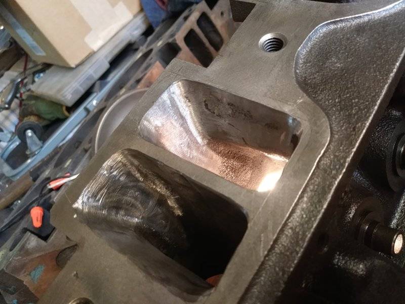

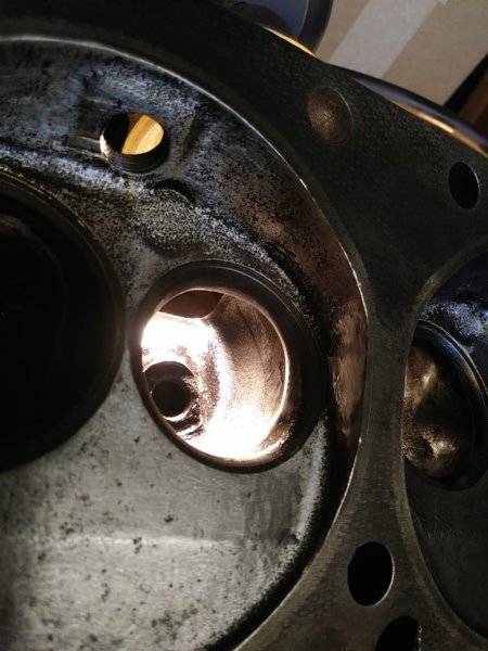

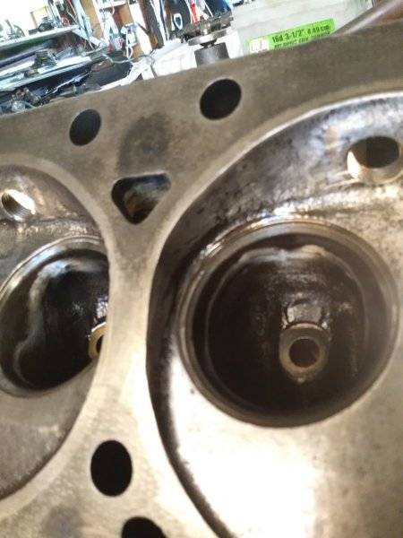

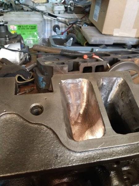

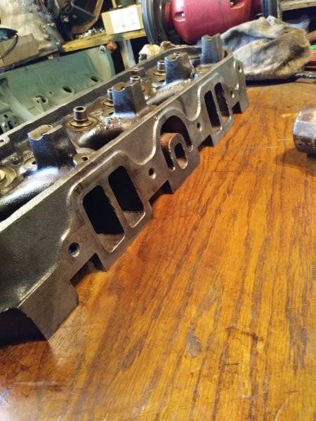

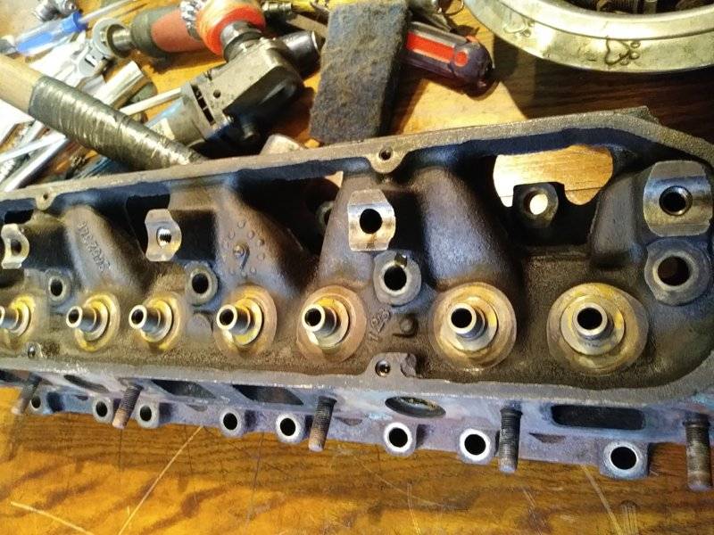

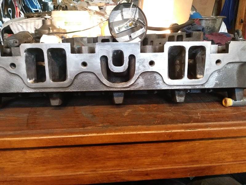

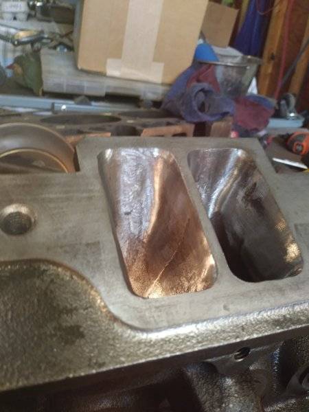

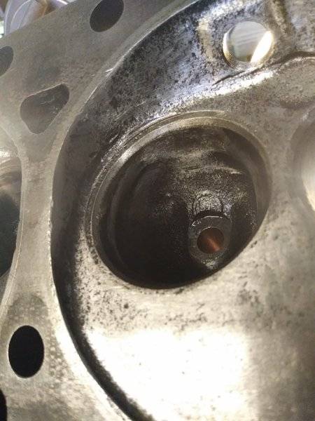

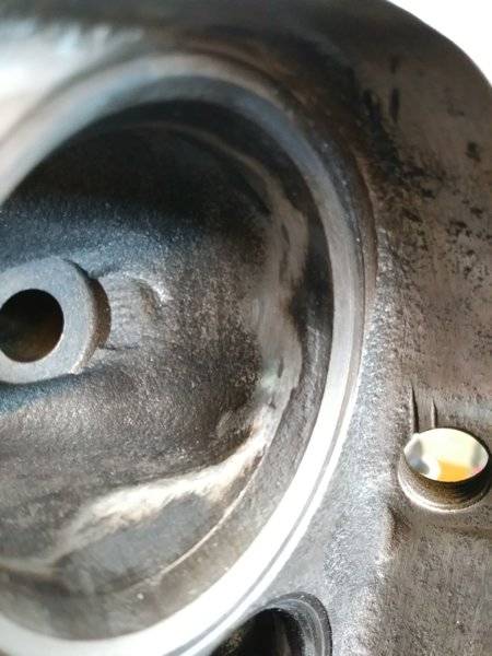

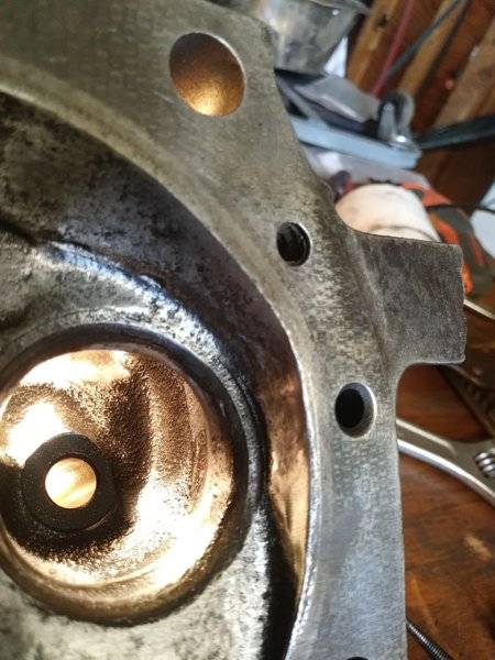

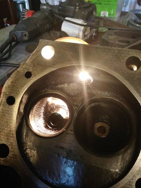

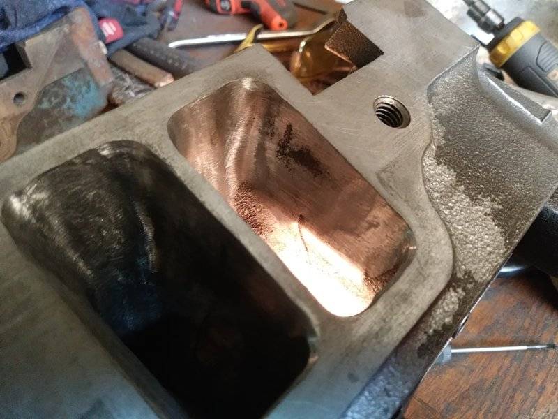

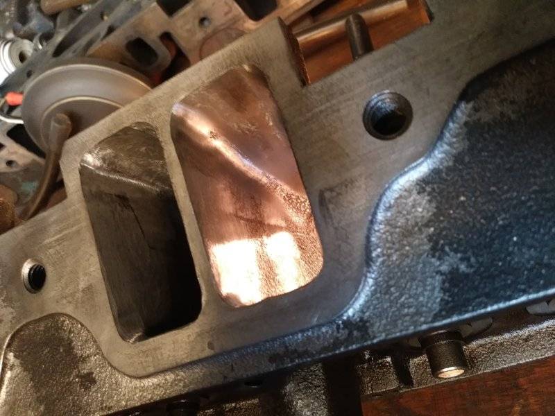

You're doing a nice jobBroke out the porting kit and took a whack at it. Turns out the previous owner did some of it already. Badly. However, I cleaned up his mess, mostly, and went from there. Turned out okay, at least better than it was. I need to get some valve lapping compound and do that and then I can put it back together. I also cleaned up and correctly shaped the water passages and casting crap everywhere. And also the heat riser too..lol. While I was at it I unshrouded the valves too. Pics..

I was contemplating JB Weld and I also have a stick of steel putty. Might give that a whirl too.Weld with ni-rod {below} fill in the low spot & grind/file it flat
https://www.weldingwarehouseinc.com/products/nickle-alloys/ni-rod-99x/
or maybe some JB WELD may do the trick
if you can rough it up enough to stick, then grind or file it flat
My bud Rick stopped by with his 41 Dodge street rod today. His is a 440 with a passenger side WP. He says he just pointed the timing light down in between the alternator bracket and water pump inlet and had no issues timing it. It's around 500HP and runs strong so I think I will be okay.If ya want a factory one, I’ve got ya covered.
