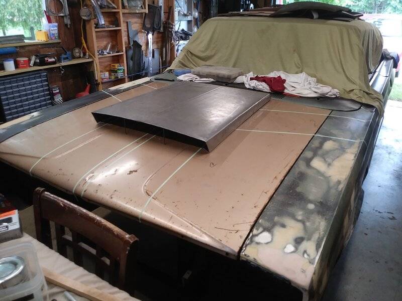

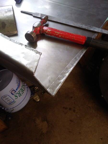

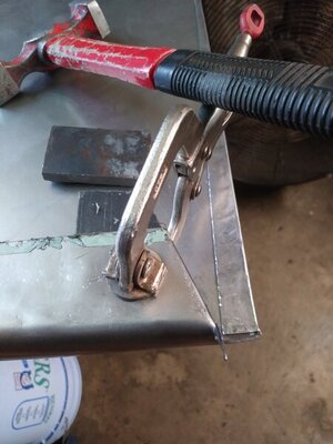

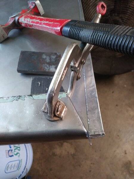

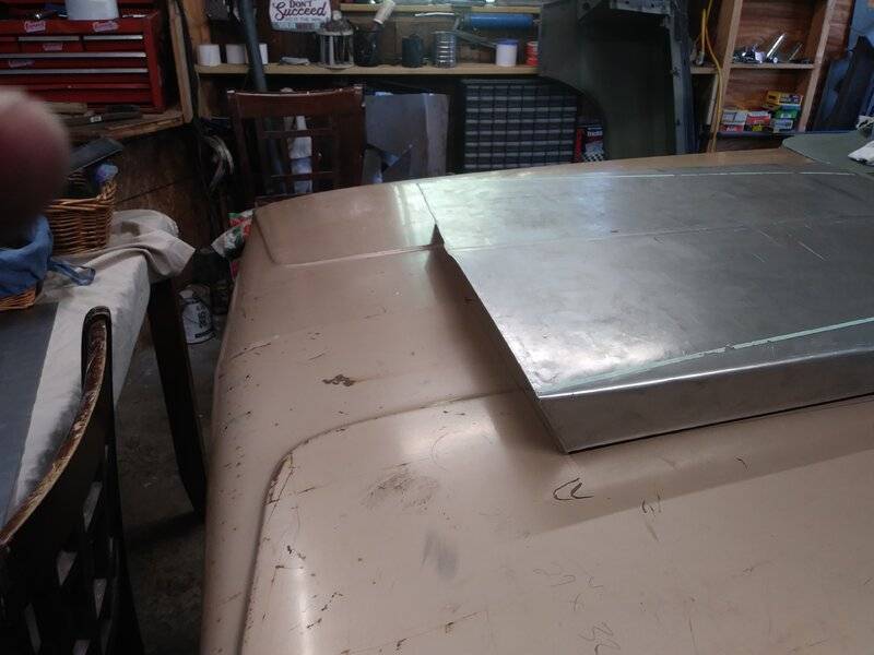

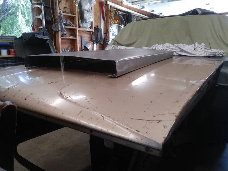

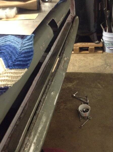

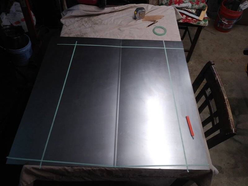

The 1/2" x 70" strip filled the gap nicely. after trimming it worked out well. On to the hood scoop! lol.
Yeah I have this ad saved......just in case....lol.

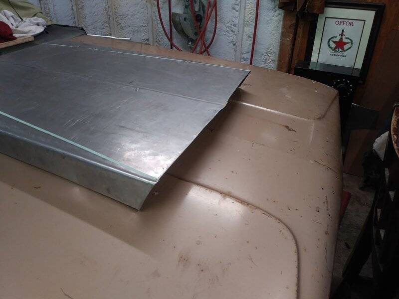

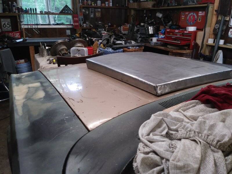

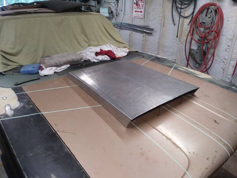

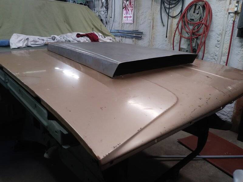

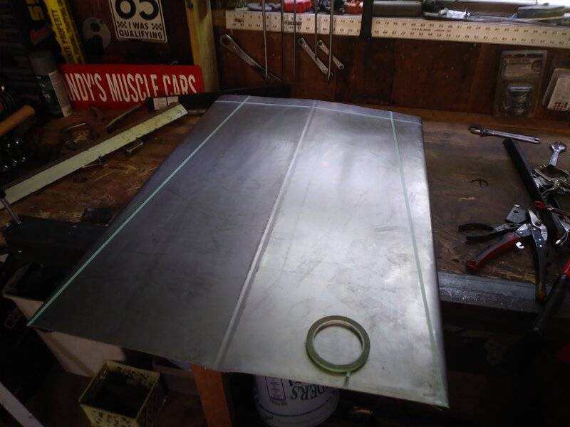

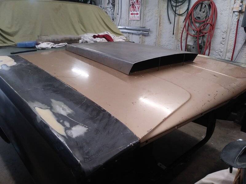

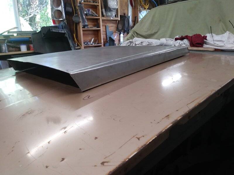

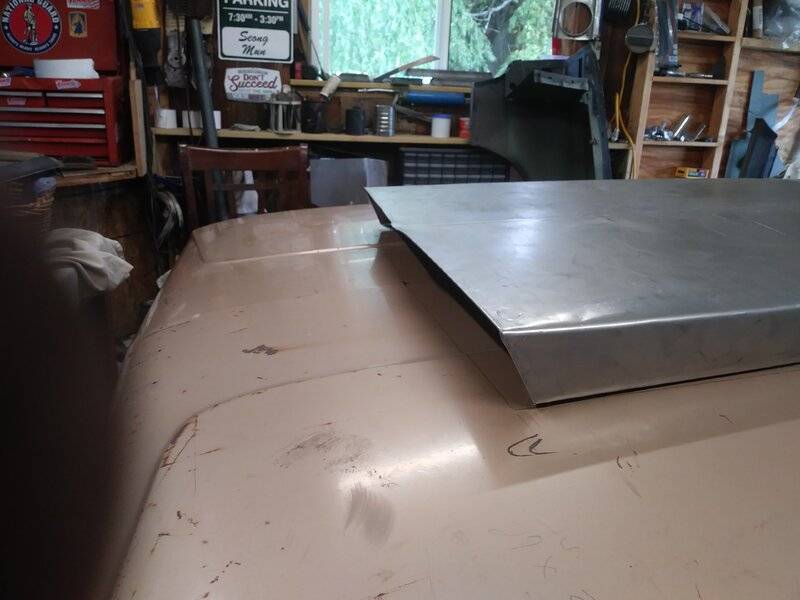

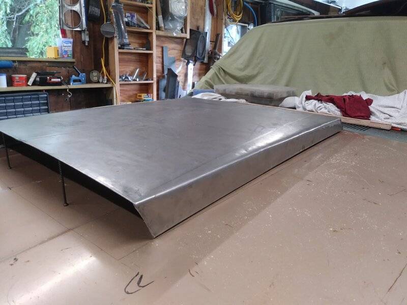

Why not a glass scoop?I'm not happy with it. Will start over.
moneyWhy not a glass scoop?

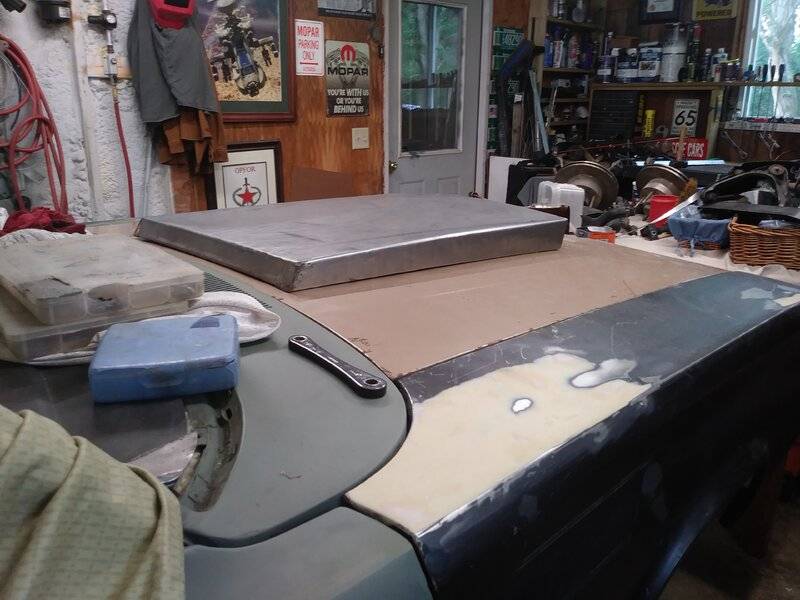

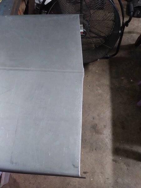

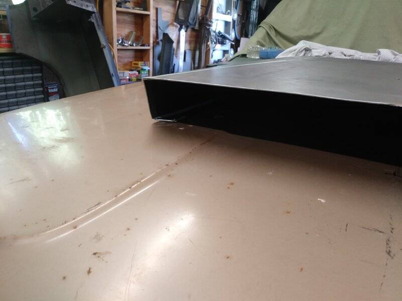

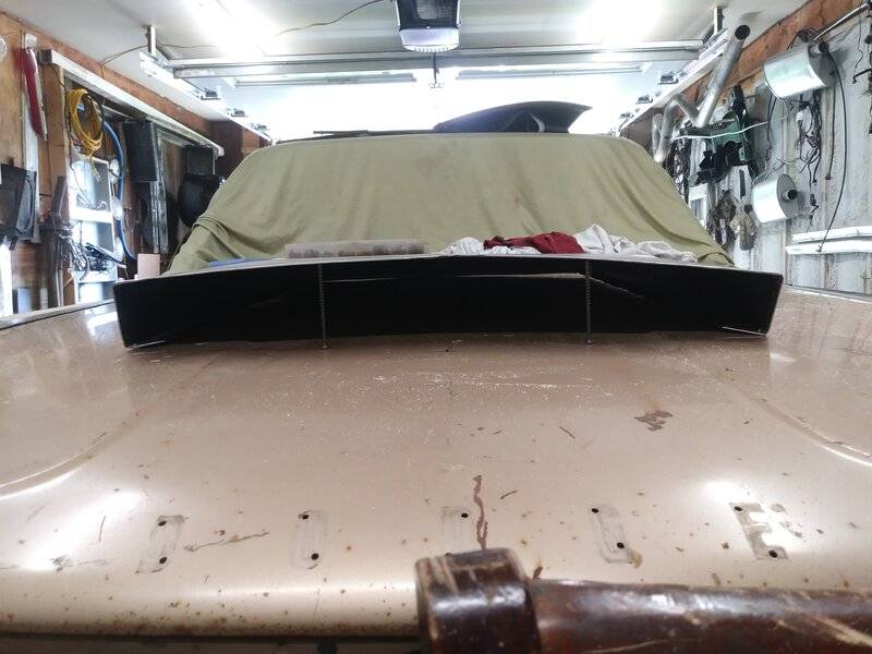

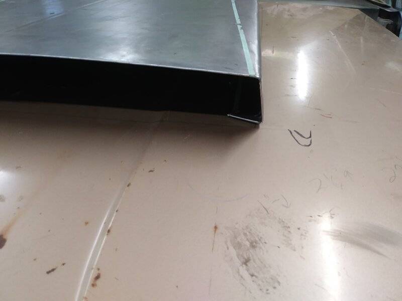

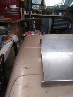

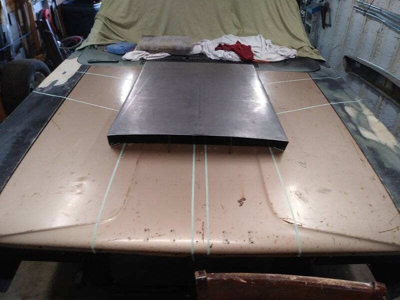

This one is 27" across the front, 24 1/2 the back, 3" tall front center and 1 1/8" tall across the back. So, it's a good deal smaller than the factory Hemi hood scoop. Why does it look so frigging big to me then? Just don't know. Cant decide why I don't like it. Show me yours...lol. I'll compare. Bolt down. I feel like it needs something. Maybe the angled impression on the top of a scoop indented in. Like the Hemi one? Too tall all around maybe?The back on mine is about 3/4 of an inch, but where is it written that it has to be. Will it be bolted or welded in place. If it sit good on the hood, I'd keep it. You did a good job. Your car follows no set rules and that is a good thing. The scoop looks very close to mine and is a sweet finishing touch. Fill in any imperfections and go with it. You have some mad skills and this is just another example of that. Well done!! The strips will really pull it together.
