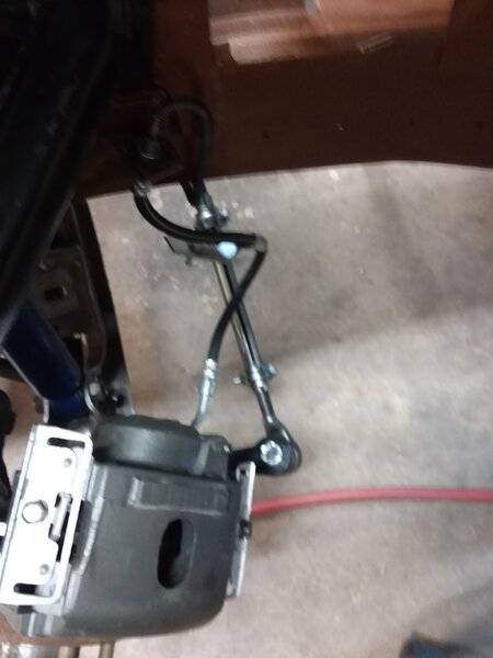

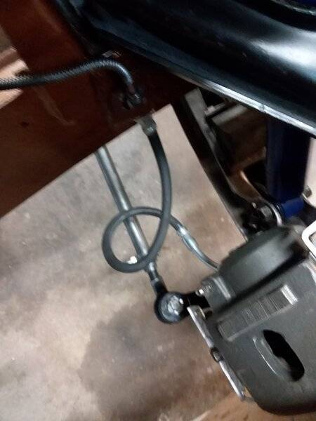

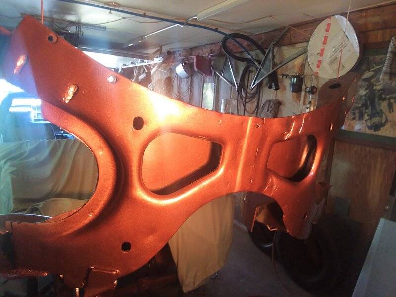

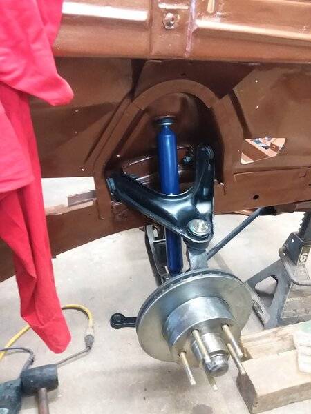

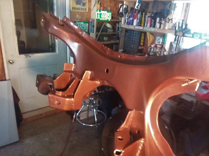

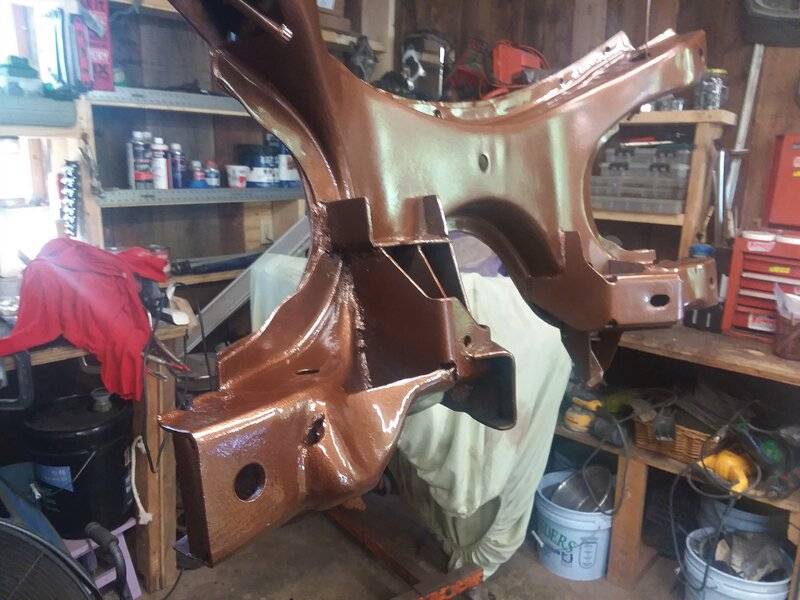

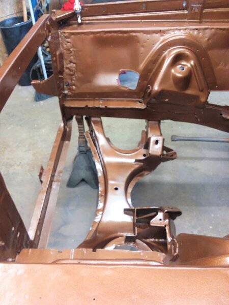

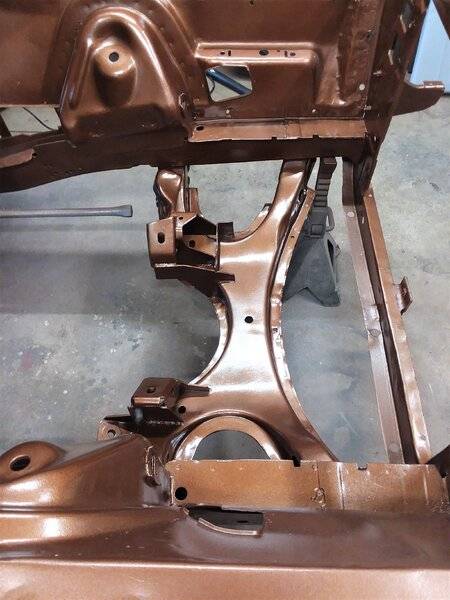

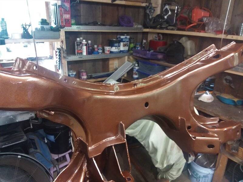

Shot the K Frame today.

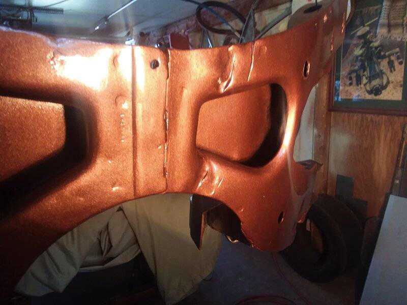

Beats me. Got beat up at some point in it's past...also one of the reasons for the close out panels...

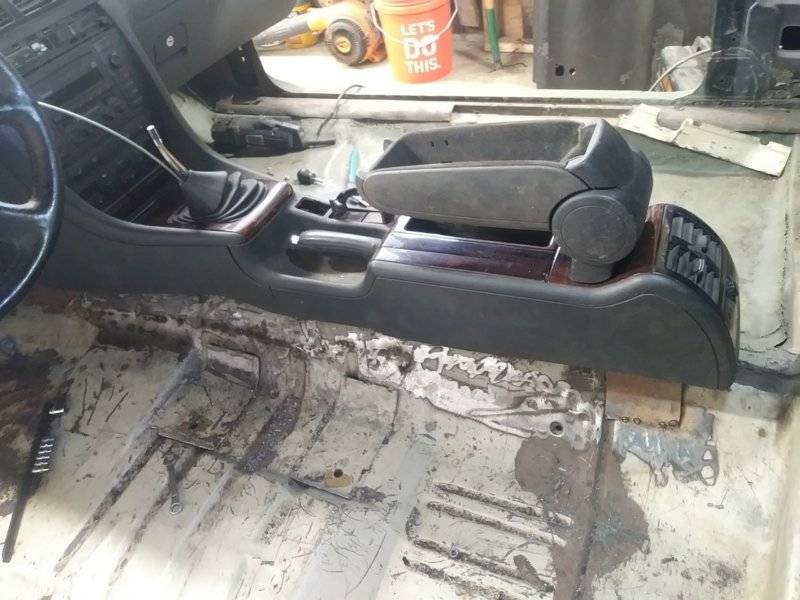

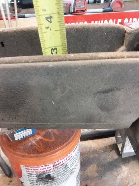

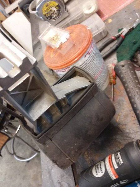

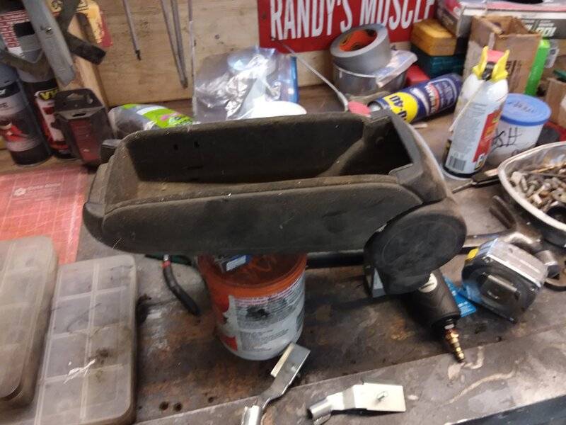

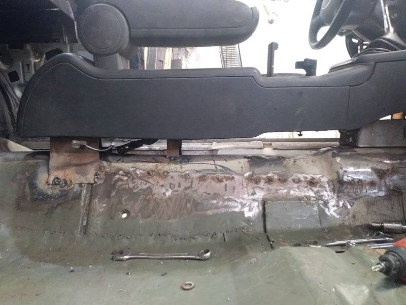

I have been trying to solve the whole Audi gauges ( Pulse) running on info from 1967 sending units ( analog). So today, while rummaging around for this and that I located the Audi center armrest/cubby that I had not intended to use.
My idea is to place three/four small analog gauges inside the thing angled towards the driver,
Yes and no. Yes the speedo is pulse but I solved that with a tranny speedo gear unit that converts it to pulse. There are no pulse sending units that are compatible with a 440 big block and the Audi computer.. The gauges in the Audi cluster are smaller than I can find replacements for that are analog. So, this is the easiest and least expensive remedy. If the speedo gear doesn't work i'll replace the speedo with a GPS operated speedo.So forgive me if I forgot from earlier posts, but don't you have to solve the pulse issue for other functions (like speedometer)? Once you do, won't the operation of these gauges also fall into place too?
