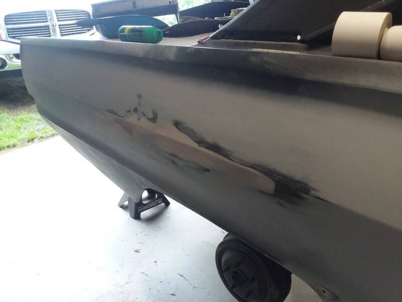

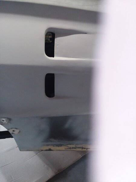

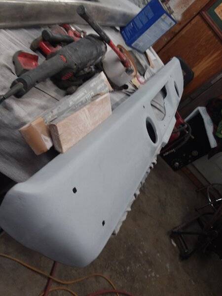

Got some bodywork in on both sectioned bumpers. The right set of side scoops and the right quarter. Bought a gallon of sandable high build grey primer. Got a quart of glaze filler. Took delivery of my new towable backhoe.

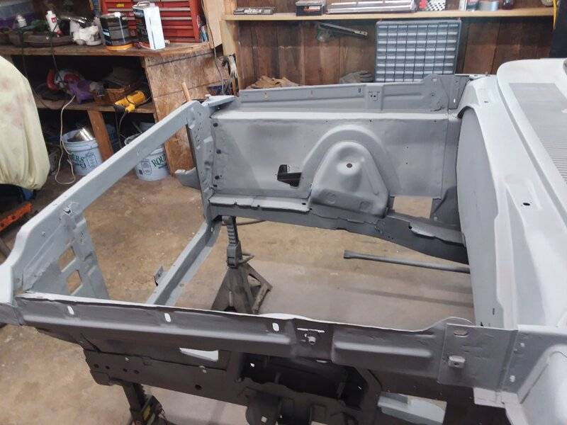

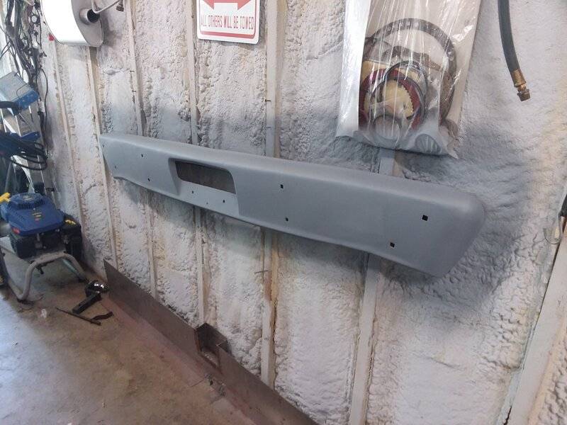

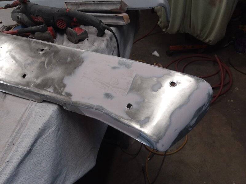

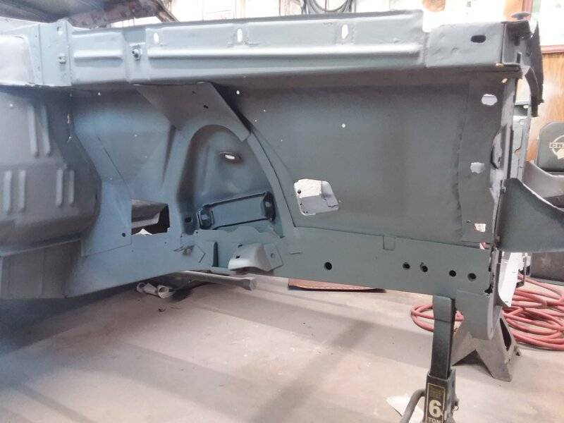

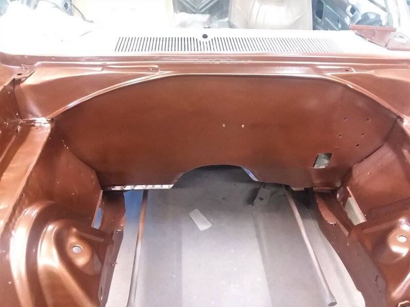

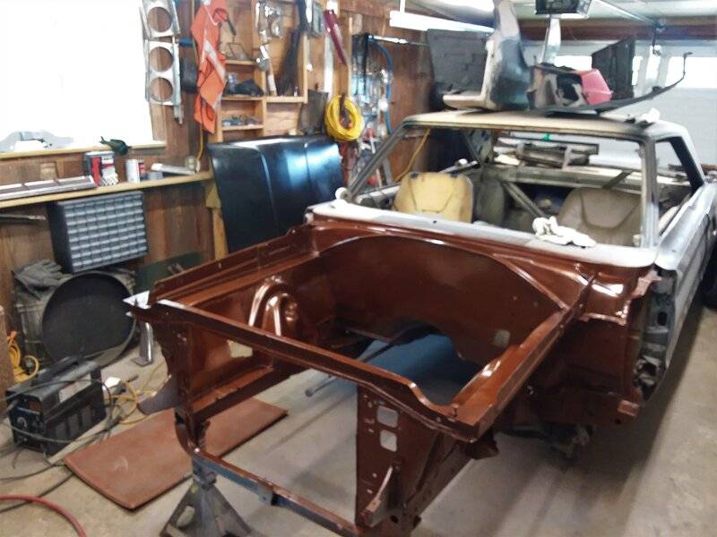

Got a set of chrome Allen head bolts w/ washers for the intake mounting. Sanded down and primed the front bumper ends where I deleted the turn signal holes and sectioned it for length and shape. Sanded down the engine bay, firewall and inner fenders on both inside and out. Getting ready to spray on high build primer, prior to putting color on there....again...lol. Did some finish sanding around the right side scoops and the right quarter.

Ghost: If you haven't already, take a look at the mounting of these for accessibility. I had a situation where a customer of my Father-in-law had used Allen head bolts on a big block Chevy intake. They were a royal pain in the arse to get at, whereas good old fashioned hex head bolts would have been much easier.

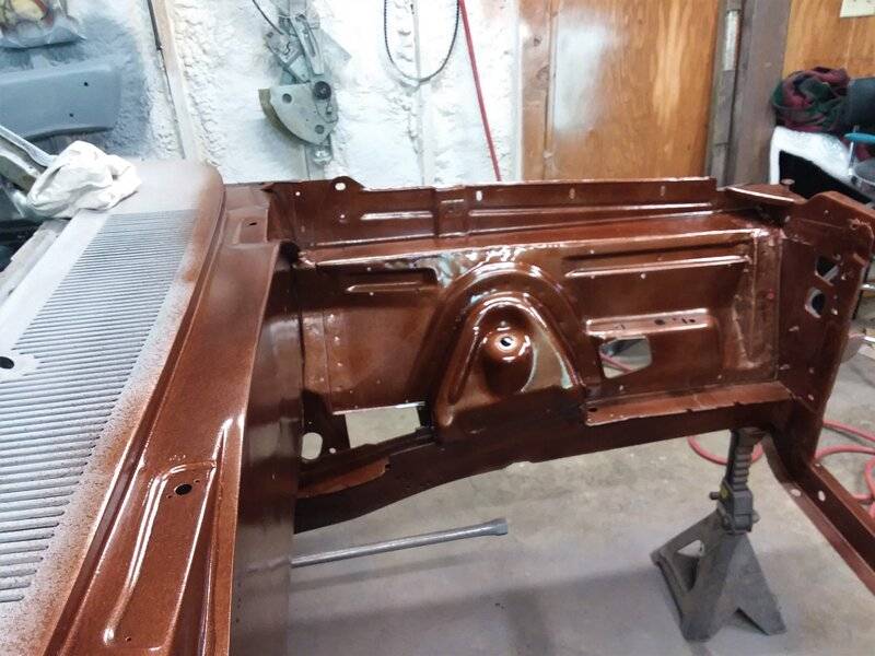

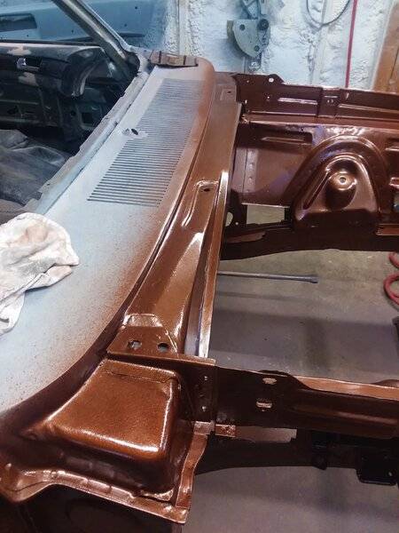

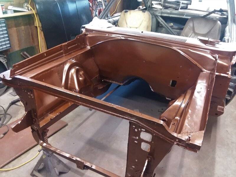

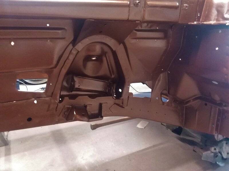

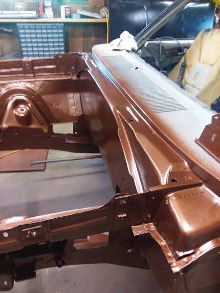

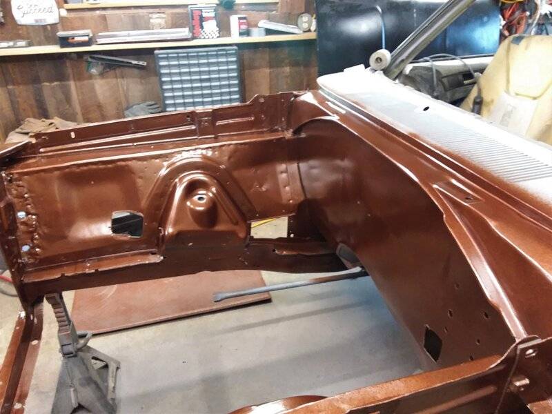

Sprayed grey primer, blocked it and sprayed first coat of color. Got a few minor runs to wet sand out before the second coat goes on but all in all i'm happy with the look and the color. It lays on much nicer when the primer is all the same color too..lol.
That wiper motor divot delete turned out great! Smooth. I'm also pretty jazzed about the way the front bumper turned out...

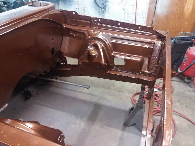

Second coat, with the gun adjusted correctly to put out a finer spray. Came out much better.
I'll let it dry for a week then wet sand it and then clear coat it. Then wet sand it again and then polish. In the meantime i'll get the K Frame painted and the front end parts painted and prepped to go together.
