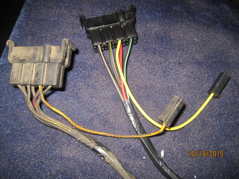

Old vs. New
Yep, the M&H stuff is great, I replaced every harness on my 73 that was available with new ones from them. Just remember, inspect and compare them with your originals, even though they are new, mistakes happen. I had some weird stuff happening after I replaced my wiper motor harness, and things were not working right, so after looking at my original harness and the new one, I found the new harness had two of the wires in the reverse position, once switched everything has been golden ever since! It was very nice to have all new wiring and they were easy to install.

Well good news the harness came and it was really well made. Bad news is I ordered the wrong part, my fault. I actually needed just the wiper motor harness. I thought it was all one big harness. But I guess it's a bit of good news since the new harness was only 40 bucks.
