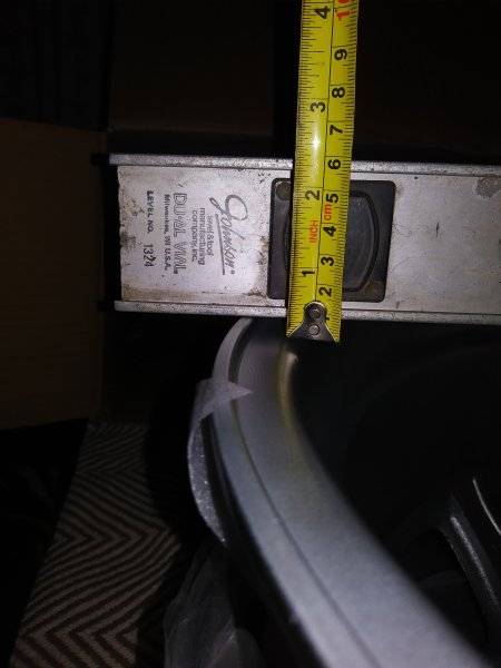

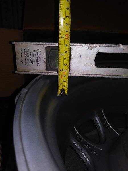

I can help but I am at work. I'll pull 1 out of the box when I get home but all mine are 17x8 w/4.5 in. backspace. If nobody has chimed in yet, I'll add any info you need from mine.
Also, I'm not 100% clear on what your asking me to measure. Assuming depth of the rim ID, actual ID throughout the inner rim, and OD of the mounting face? This correct?

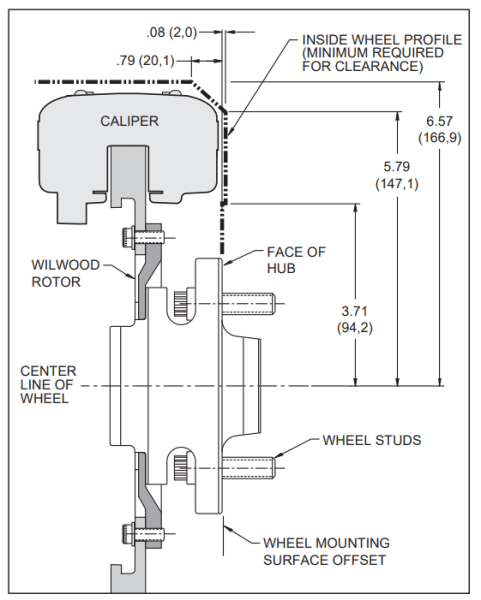

Here's a wheel clearance diagram from Wilwood's 11" brakes ---- let's use it to locate rim measurements.
The place to start is the where the rim sits on the hub face.
What is the inside diameter of the rim here (extend the face of hub to rim)?
Does the inside diameter of the rim vary (get smaller or bigger) as you head to the rear seat of the rim.
If so, where along the rim width does the diameter change.
What is the diameter of the rim at the rear (before the rim lip starts)?
Ideally, the diameters front (@ face of hub) and the rear (before the lip starts) are the same ...... possibly a little larger at the rear.
Make sense?

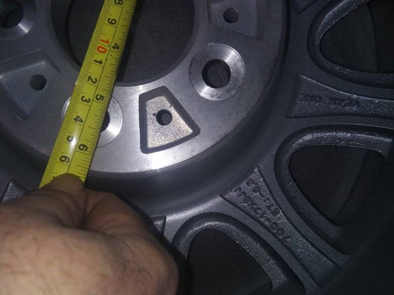

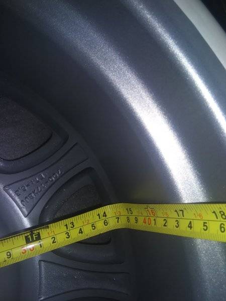

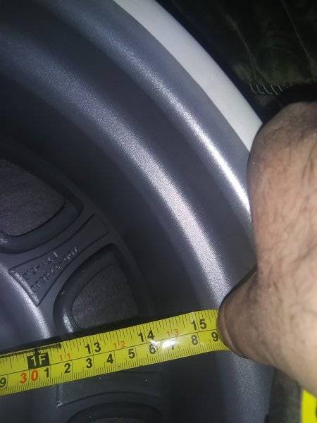

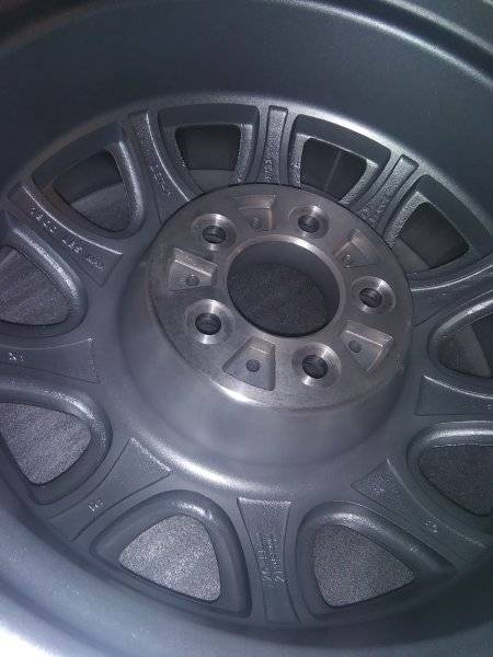

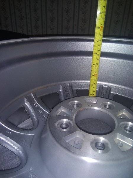

Its easier to photo than to explain. Let me know if you need more info but it looks like a safe combination. Also note I measured inside the second step near the outer lip. I cant get an accurate measurment deeper than the mounting face but with these details it looks like the brake setup will work w/this wheel selection. Again, all mine are 4.5 BS. Good luck!
Its easier to photo than to explain. Let me know if you need more info but it looks like a safe combination. Also note I measured inside the second step near the outer lip. I cant get an accurate measurment deeper than the mounting face but with these details it looks like the brake setup will work w/this wheel selection. Again, all mine are 4.5 BS. Good luck!View attachment 1412804View attachment 1412805View attachment 1412806View attachment 1412807View attachment 1412808
Assuming you lay a straight edge (yardstick) across the back of rim -
1. Is the measurement 4.5 or 5" from hub face to bottom of straightedge?
2. What are the measurements from the bottom red line to first, second and third red lines?
