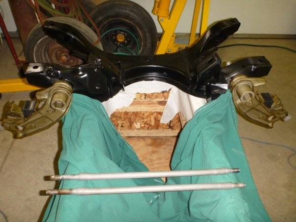

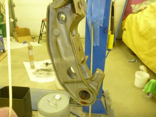

I've used the resto Rick "quasimoline" on my stuff.
Looks pretty authentic and is tough stuff.
I don't build judged trailer queens, but I was doing the front suspension anyhow, so I figured I'd try ricks stuff.
A couple pics:

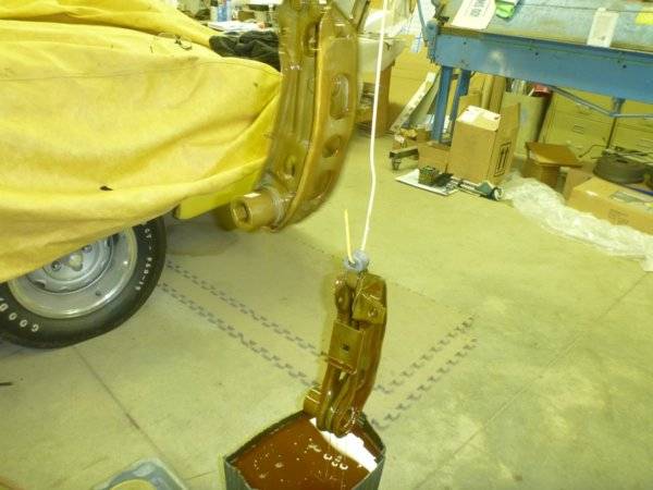

Rust Veto 342 from Houghton. Unavailable in Canada unless you happen to have a father in law that plays snowbird in Florida and he smuggles it across the border. Cost about $500 Cdn for the 5 gallon container. If I remember I dipped 8 times to get the colour I wanted.
