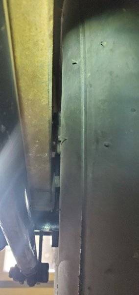

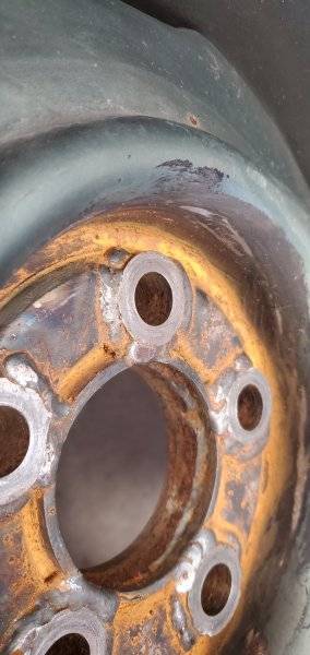

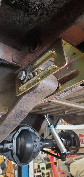

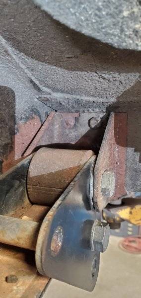

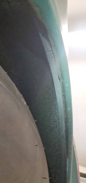

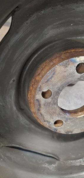

The amazing part is with a slight move of the springs and a rolled fender lip, 10.5x29.5 M/T Pro Bracket radials bolt right on. The front hangers are flush to the frame. Shackles are replaced with sliders. Early on using steel wheels (10") it bent the rear wheel studs. So steel plates were machined and welded to the wheel for greater surface contact. Also added 5/8" wheel studs.

What is the advantage to having sliders?
A standard 9" housing and center section aren't all that great. Modified they are very good. They are also very expensive. A center section alone is at least $1500. When your done it'll be $3500+. This Dana was an 8 lug HD out of a Ford F250 P/U we got for free. I chopped off the ends and brackets. Welded on new ends and perches. Swapped in a spool and axles. Even used the original 3.54 gear. Total cost was around $700. Add another $250 for the new gear. The sliders allow more freedom of spring movement. Much easier than moving the shackle mount when moving the springs inward. Less than $100 at Speedway.

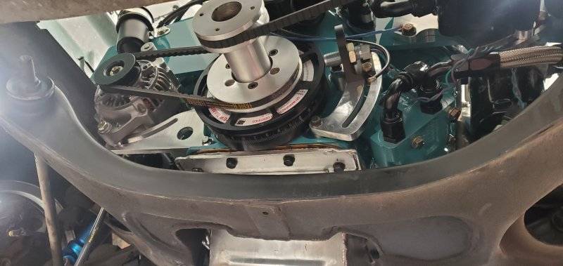

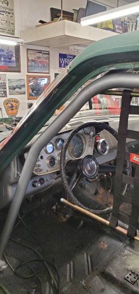

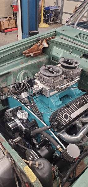

So back to work on the 62. Saturday sanded and painted the updated rollback to cage. Started on the window net. My son had the day off yesterday. Got the engine, trans, trans blanket, headers, starter, driveshaft in. Had to weld the motor plate tabs in with everything installed in the car. Set up the plans for plumbing and wiring. Parts are coming.

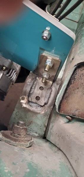

Spent tonight welding up stock seat holes, old fuel cell holes, rear seat belt holes, various bracket holes. Thankfully this thing is pretty solid and not to rusty. It's also a good thing I can still kneel under the cage and in the trunk. What am I going to do when I get old?
