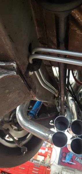

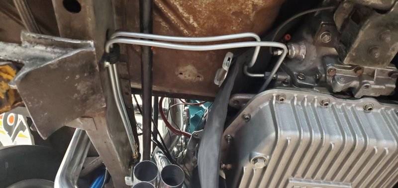

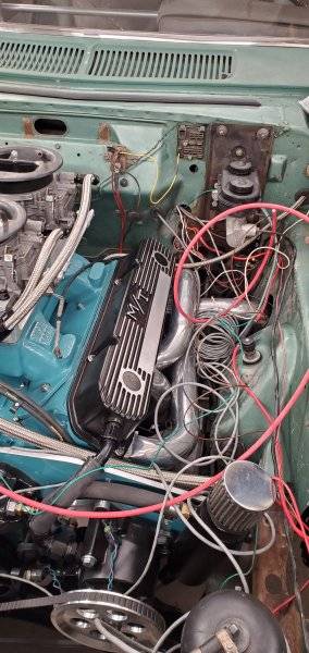

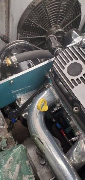

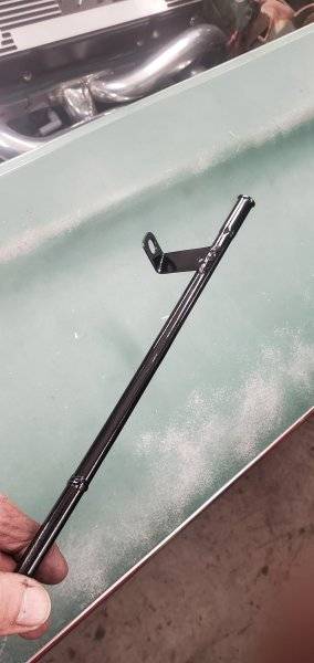

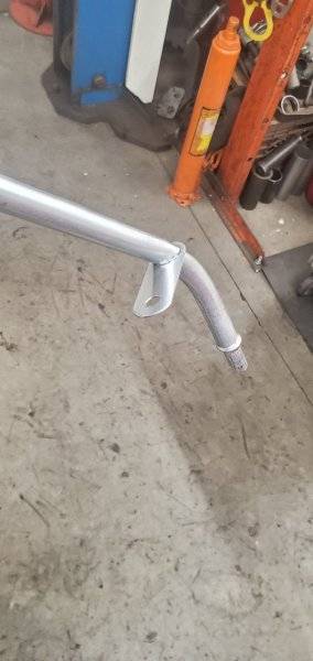

Last couple of days has been exhausting. Heated and scraped all the under coating off. Except the front wheel wells. The car is amazingly solid. Except the front fender dog legs and the lower 1/4's there are no holes. Surface rust and way more factory primer that expected. Also fabbed up a engine dipstick using a O ringed Jeep tube and stick. Straightened it. Cut it down and welded it shorter and added a tab to hold it. Recent the A engine trans dipstick tube and added a tab to make removal easier. Then fabbed up some trans lines. I'm whipped.

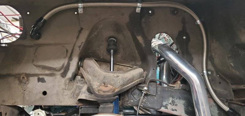

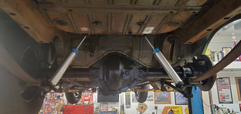

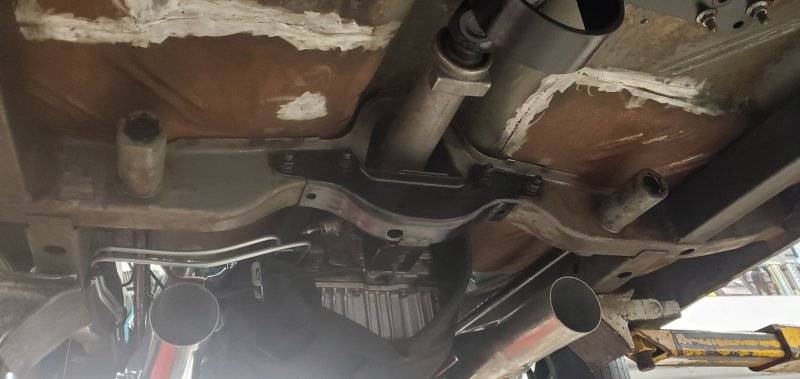

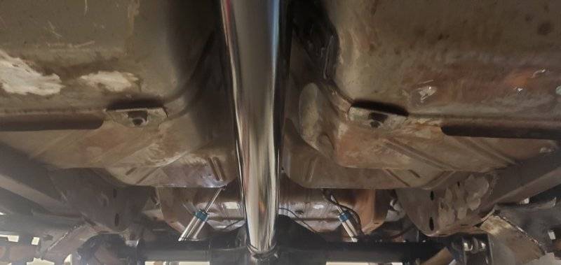

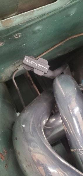

Well today the undercarridge is officially scraped. Saved an amazing 11.6 lbs. A lot of work for not much weight reduction. At least everything is clean underneath. Collectors are on, shift cables adjusted, trans and oil cooling sending units are wired, all the fuel lines are done, trans blanket buttoned up, engine diaper test fitted. My friend Virginia started on the carpet today. Custom cut and gluded jute padding. Made cloth templates for the carpet that will be cut and sewn.

Trans lines look good.. just curious, that's a 2 pump trans? did you find way to run an internal filter? or do you know of a good in line filter? mine got destroyed when i was taking it apart. And.. is that manual pushbutton?

It was originally a 2 pump. The rear pump gears are removed with the race valve body. You can run an internal filter in a 2 pump valve body. It requires a 2nd hole in the filter for the rear pump. You need a 63-65 style filter. Or cut a 1/2" hole in the late style filter. The only part I'm not sure about is if a 62 pan has enough clearance for the filter. A later pan from any 727 will work. I have some laying around.

Ahh thanks a ton! I was kinda curious bout that... The external filter was another thing i didn't know bout 62's... :)

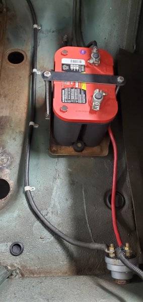

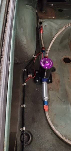

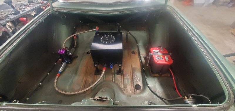

Inside of the trunk and all the fuel lines are done. This was all done by my son. Now I'm into engine compartment wiring.
