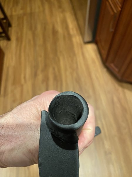

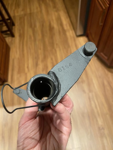

I picked up this z bar a while back for my /6 to 383 conversion. I’ve not installed it yet and wondering if it’s worth it - or should I get another one. Notice the ends are worn and oblong as if the previous user had an alignment problem. New territory for me.
Knew a girl like that once, but have never seen a torque tube bar hogged/worn out like that.
Replace it. Mine wasn't that bad, but after 3 attempts to stop a clicking noise in my 69 RR, I found it. It would literally rock back and forth.
Thanks. I assembled my list of clutch linkage stuff I need to complete the job and this is on the list.
