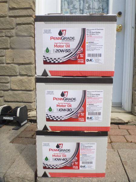

Bee = 10W30, Dart = 10W40 and Bird = 20W50 $600Cdn hit in 3 boxes..
That’s a lot of dough for oil. I know everyone has their favourites, me included, but I buy 5 quart jugs of Lucas hot rod oil for $36 a jug. If you’re open to trying something new I can recommend it with confidence. No flat cams yet..

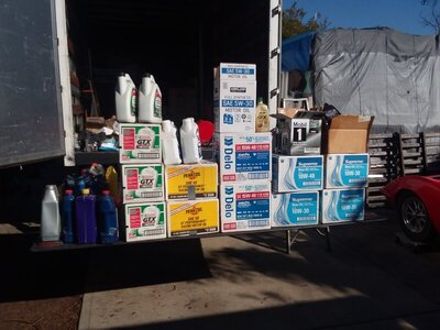

Here's what I use and Valvoline 10/30 Conventional.
Talking with a Penn Grade chemist back when the name was changed from Brad Penn, he assured me it was the exact same formula as Brad Penn and even Kendall from years ago.
He also stated that adding any zinc additive to any oil isn't the best thing to do. These oils are specifically designed and formulated to do a certain job and adding any additive especially zinc can alter the chemistry and could be detrimental.
