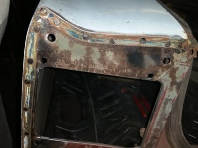

Got out to the shop this morning due to it raining here ( probably all day ) and got the last of the spot welds ground off and the last of the metal removed from the rear of the car and then thought . . . how is this going to look ? ! ? ! ?
So I was off to grab the donor panel and see what it was going to look like . . . I think I'm glad I went this route now ! ! !
The rear of the car will be welded on the normal weld areas . . .
The trunk area of the car will also be able to to be welded in the normal weld areas . . .

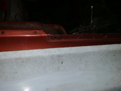

However, the difference in the top portions of the quarter will require some additional thought . . . but I think I have a plan . . .

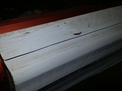

Cut it down the top of the panel on the side to keep my original top section in place . . .
And an angled cut across the back to replace the damaged top area and lean the original top section in place . . .
And the end result is that I will have minimal bondo in the car and a much truer, cleaner looking quarter panel as a result ! ! !
Got a lot of work ahead of me this weekend ( no tree work to get in my way ! ) . . .
After I get everything fitted and lined up, I'm going to weld up all the holes, grind them flush, and get all of this in epoxy primer before it gets put back on the car.

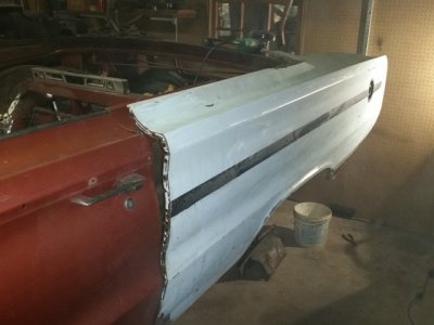

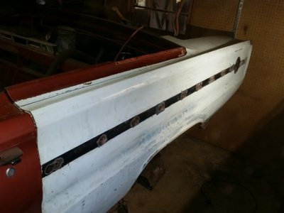

Got the unwanted edges cut off of the donor panel and got it set in place - looking very good . . .

More fitments . . .

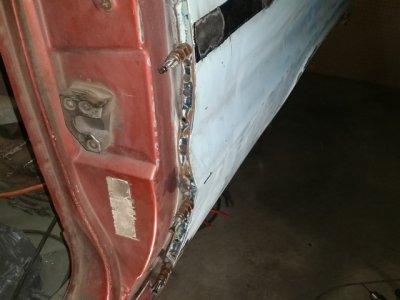

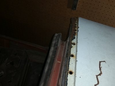

Got the panel fitment going along quite nicely . . . and I like the way it is going . . . the top trimmed and held in place with a cleco . . .
The whole front edge of the panel with clecos holding it in place
So far so good . . .

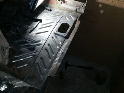

And now for something a little different . . .

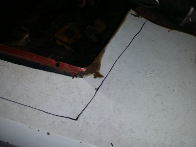

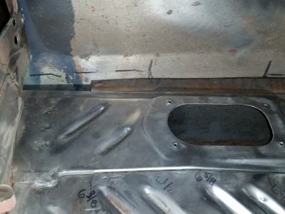

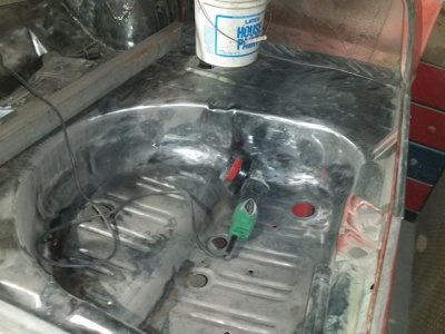

Since the bottoms of my trunk extenders were toast, and I did not like the little "pocket" that gets created when you put then in the original way, I decided it was time to "lose" the pocket and clean up the trunk - this will prevent stuff from collecting in that area, holding water, and rusting the car from the inside out . . .

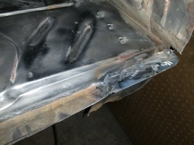

So I bent the trunk extenders up, hammered them out a bit to straighten them out, marked my measurements on the metal and cut it off . . . to get this . . .

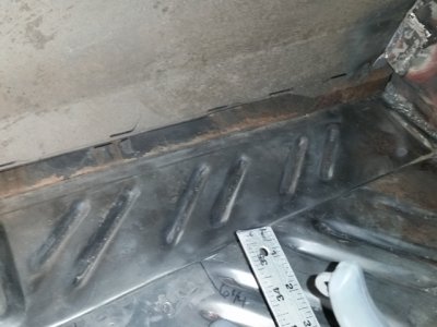

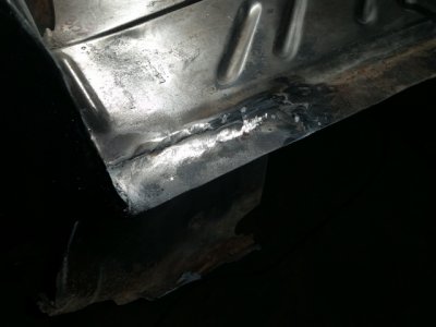

With the panel back in place, the trunk floor will extend to the quarter panel . . . ( got a small hole to fill up front )
And another small area to fill at the back - this was done to leave my "true" bottom edges at front and back intact so I can match to them with the replacement panel.
Underneath the flooring, I will put a couple gussets to help support the panels since they will be open on the inside . . .

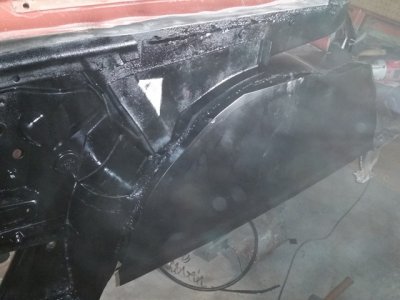

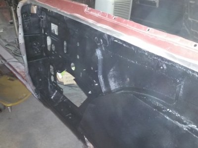

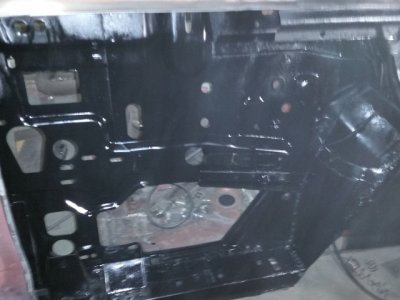

Still got some things that I need to get done to prepare for the reattachment of the quarter panel . . . while I've got the whole side of the car opened up ( and will probably never have this opportunity again ) I took the opportunity yo get some primer in these areas to help protect them from rusting . . . sure can't hurt.
First, I has a couple "open" spots on the filler in my trunk area that needed attention . . . so I patched them . . .
Then the primer was put into the inside of the quarters . . .
Another view
and another
Want to get the inside of the quarter panel in primer too before it gets reattached . . .

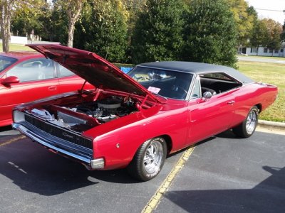

Went to a local car show today . . .
Attended a local car show with the '66 Shoe Box and saw this charger that I wanted to share with the group . . .

Must be nice to even have a car show to go to haha, Winter is showing it's head up here and people are starting to hibernate already.:angryfire: That is one nice looking Charger though
Hey 747Mopar . . . it's a really really dark orange too . . . just the way you like it ! ! ! LMAO
( Did I mention that it is really, really dark orange ? ? ? )

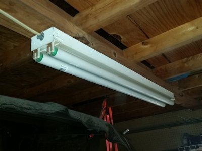

Shop upgrade for lighting . . .
The shop that I have has got (2) 4' T12 Fluorescent fixtures in the ceiling, and they don't provide a whole lot of light.

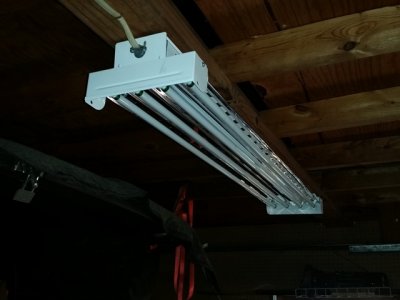

I found a (4) bulb T8 fixture at one of the local chain stores, and a (4) bulb T5 fixture at the other:
The T5 is HO ( high output ) bulb, uses less electricity, and lights better . . . so the T5 was the choice . . .
Here is the T12 fixture as it was in the shop . . .
And the T5 fixture that has replace it . . .
The amount of light that is output from the T5 is night and day brighter than the T12 ! !
( night and day - get it ? ? )
Should make for working in the shop a whole lot easier to see . . . Can't wait to give it a try . . .
WOW . . . I really like the new shop light . . . I can see now . . .
Got back into the shop again tonight and the new shop light is fantastic ! ! What a difference to be able to see what you're working on . . .

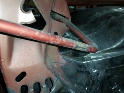

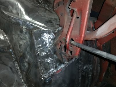

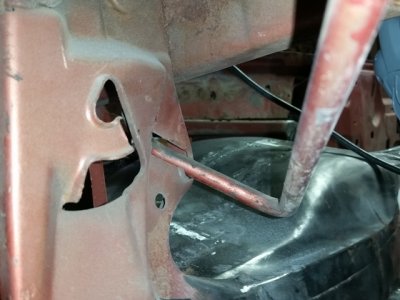

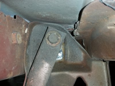

So I got back to work and removed the trunk torsion bars . . . here is a step by step to get this accomplished . . .
Place a screwdriver under the bar so you can pry it out from the hole using the bracket . . .
The bar will either 1) move to the next hole ( as show below ) or (2) skip all the holes and be loose . . . depends ( I had one of each )
If it does go to the next hole, simple pry it again, and again until it is free . . .

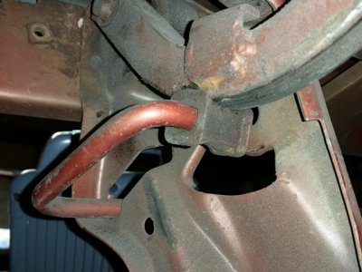

Next we will need to get them removed . . . but first, this is what it looks like on the trunk hinges ( helps when the whole side of your car is removed )

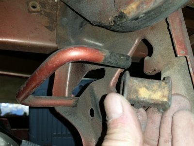

Pull the plastic piece off the end of the torsion bar . . .
Now you have to move the bar toward the center of the trunk to get it in the proper alignment to remove it . . .
The hole in the bracket is just the right size to pull it through once it gets aligned properly . . .
Lastly - to remove the trunk hinges, they are held in place with clips - you'll have to pull them off and then slide the brackets off the post . . .

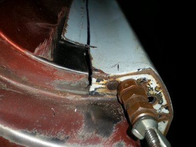

More trunk work . . .

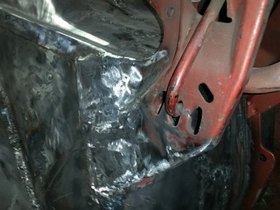

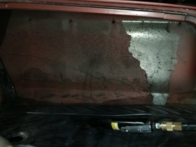

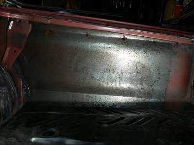

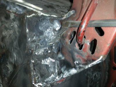

I need to remove the undercoating on the passenger side so I can match the driver side and allow welding to the inside of the panel later . . .
That air-scaler is becoming one of my favorite tools . . . about an hour later and it was cleaned up . . .
And here I thought I was done with undercoating . . . yet another pile of this stuff for the garbage . . . ARGH ! ! !
