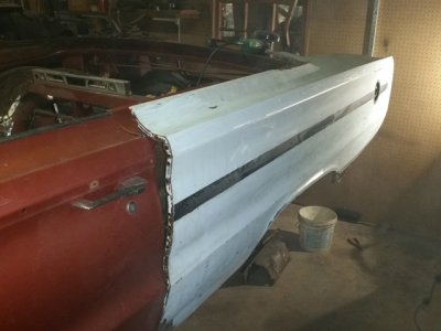

Got out to the shop this morning due to it raining here ( probably all day ) and got the last of the spot welds ground off and the last of the metal removed from the rear of the car and then thought . . . how is this going to look ? ! ? ! ?
So I was off to grab the donor panel and see what it was going to look like . . . I think I'm glad I went this route now ! ! !

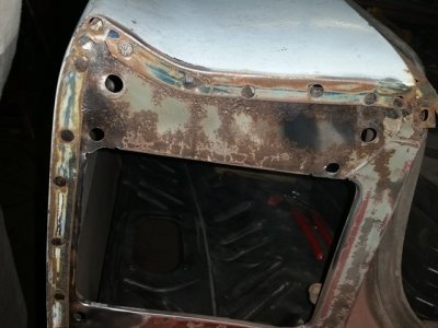

The rear of the car will be welded on the normal weld areas . . .
The trunk area of the car will also be able to to be welded in the normal weld areas . . .

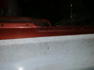

However, the difference in the top portions of the quarter will require some additional thought . . . but I think I have a plan . . .

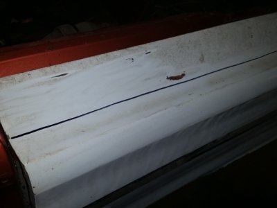

Cut it down the top of the panel on the side to keep my original top section in place . . .

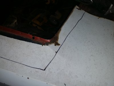

And an angled cut across the back to replace the damaged top area and lean the original top section in place . . .
And the end result is that I will have minimal bondo in the car and a much truer, cleaner looking quarter panel as a result ! ! !
