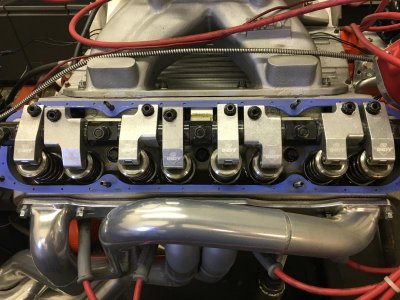

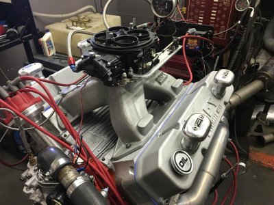

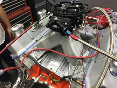

Over a year ago (Ugh) I posted pictures of my 66 Belvedere project and wanted to share an update. Last Tuesday I had the privilege of spending the day with Brian Hafliger at IMM Engines, in Indio Ca to have the motor he built for me on the dyno. I had a pretty tall order as I wanted to be able to run low ten second 1/4 times and still be able to drive it on the street with California 91 octane fuel. The new motor is 496 CI 10:1 compression and made 670hp and 610ft lb tq. Very happy with Brian and IMM as they did an outstanding job. Not sure how to post the 7K RPM dyno pull video (Newb), can't wait to get the motor back in the car and see what she will do. I found IMM Engines thanks to this forum!

I'm with Mike. Please share your combo. Excellent dyno results with 10.1, are you running flat tops or dished pistons and what cc are your heads?

Looks great and makes some nice hp and torque. I want that black Dominator carb ! And yes share the combo with us please. Ron
Hello Mike / Malex /dvw and 383man! Coil overs in the rear with Alston ladder bars, Dana 60, Moser with 456 spool, 31X14.50 MT/ET, 727, 5500 converter, 500" 440, 10:1 Ross diamond Pistons, scat crank, Ported Indy SR heads flowed 370, full roller solid with T&D 1.6 rockers, Isky cam, TTI 2 1/8 headers, Indy intake, 1050 dominator, MSD 6alPlus Made 670hp and 610 TQ on pump gas. Wilwood disc all around. I have a brand new Griner transbrake in the box, just not sure I want to install it with as much street driving I'm planning on doing. I got the new motor in yesterday, few issues with brand new out of the box 1050 Dominator, it fired right up but is not running quite right yet. One more day with it and I should be smoking the tires!! Thanks For Asking!!

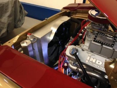

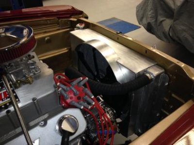

I was running the same temperatures as you, in the 200 mark with the electric fan set up. I switched to a 19" clutch fan and my temps never get higher than 185 now. Since then I have built a shroud, which will help more. image.jpgimage.jpg
malex, just got done looking at pictures of your car and all I can say is WOW! Your car is bad ***! If I could build a shroud like that I would be all over it. I am sure I am just prolonging the inevitable but that radiator and fan was not cheap! Can you please tell me which fan and clutch you have? Also I am looking for that upper and lower radiator hose you have and can not find one, do you know the make and part number for it? Thanks for your help!

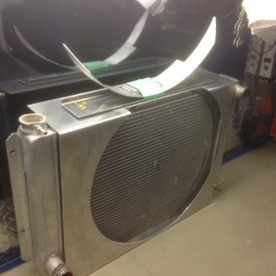

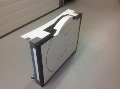

Hello. The fan blade that I run on my Plymouth is #3462186. It actually measures 19.5" across, so it fills your rad area right up. I couldn't see the part number on the clutch but that should not be a problem to match up. A shroud will complete the package for good cooling, grab some aluminum and get creative. I'll attach a pic of my shroud in build stage. I ended up making mine a 2-piece, the bottom detaches from the rest of it, easy to slide into place now.
Unfortunately I cannot help you out with the rad hose part number but I'll have a closer look in case there is something on it.
Here's a couple of pics of my template and then my shroud in build stage. image.jpgimage.jpg

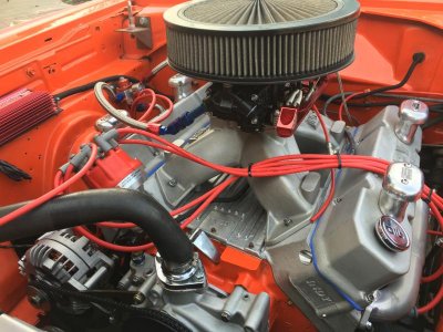

I have the "Be Cool" Radiator and twin fans (and shroud) on my setup. Works great. I posted a picture of my top radiator hose for your information. I can use any hose (with the correct diameter) as replacement tieing into my custom made aluminum tubing section.
