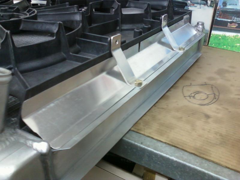

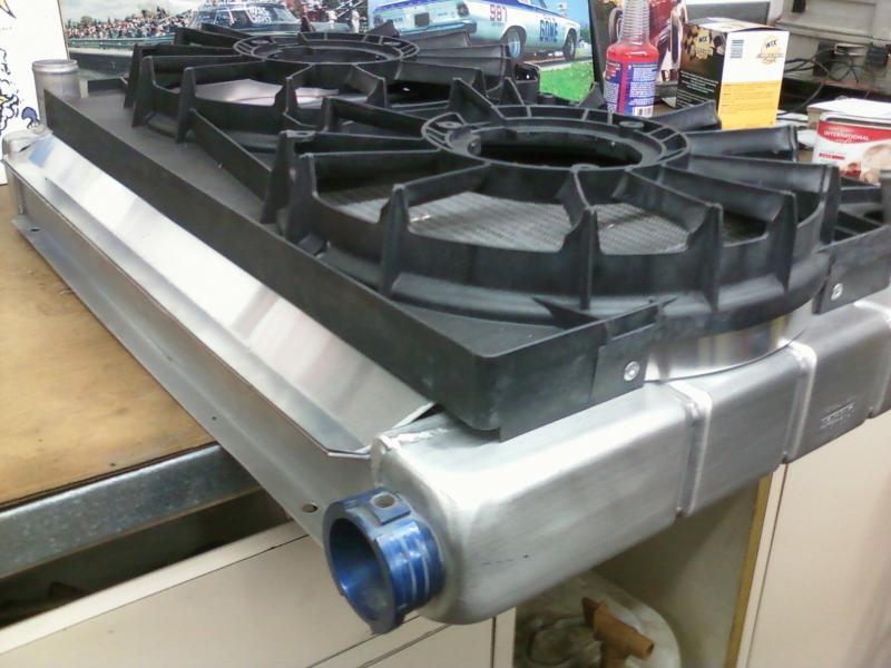

I run a Northern (generic Summit aluminum 2 core) with a pair of fans from a late model Dodge Challenger from the scrap yard. The fans will mount with two simple pieces of .030" aluminum and some 1"x 1/8". Screws are yet to be installed in the pics. Work very well, cheap.
Doug

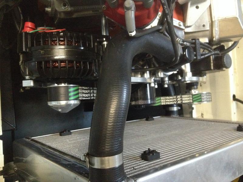

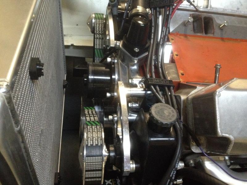

image.jpgimage.jpgPlumwagon I read earlier that you where throwing Belts at higher RPM's... Check out this pulley system by CVF Racing, it's about 1 1/4 inch thick Made In USA !

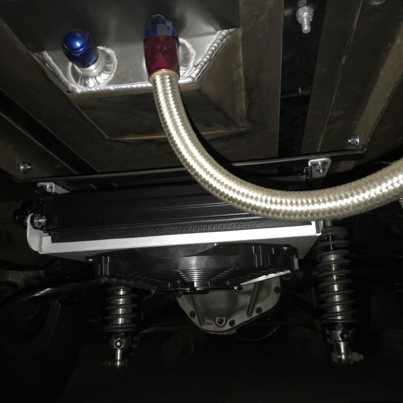

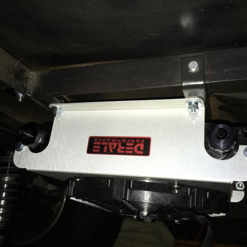

New project completed. Rear mounted Derale trans cooler. Its a 40 row stacked cooler with an 800cfm Spal fan. I ran -6 hydraulic hose line from the trans to the cooler and covered the first few feet of each hose with Thermo-Tec sleeve. Pictures are poor but it was dark when I finished.

Thanks Mike! I ran -8AN fuel to the Quickfuel/Dominator. And sorry those fittings came with a 995CFM Demon/Dominator I still have sitting in the garage. I will try and find the part numbers for you on Summit, and let you know.

Thanks malex! moparcrazy you should easily be able to fit it where I did. Let me know if you want any further details. Not sure I will make it this year to spring fling, maybe fall fling depending on work schedule.

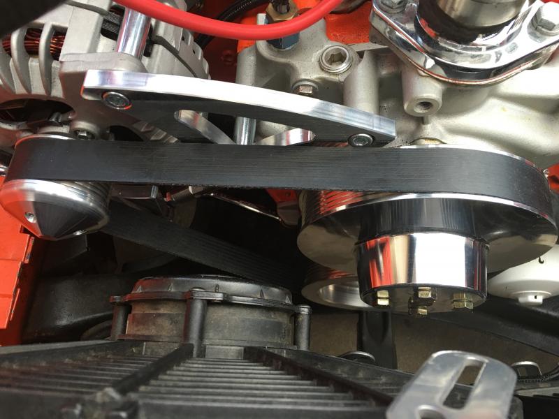

Thanks to moparcrazy, I ordered and installed 8rib serpentine belt setup from CVF Racing. It not only stays on at 7k RPM, it also stopped my overheating problem. Photos are poor, but it looks really nice when running. Taking it to Westech Performance Chassis Dyno in the next few weeks, then should be good for a first test and tune track days with the new motor!
