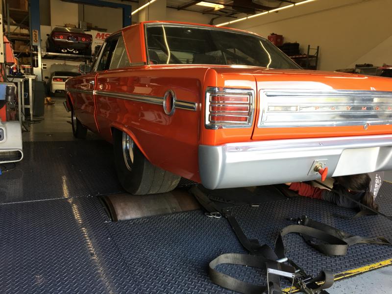

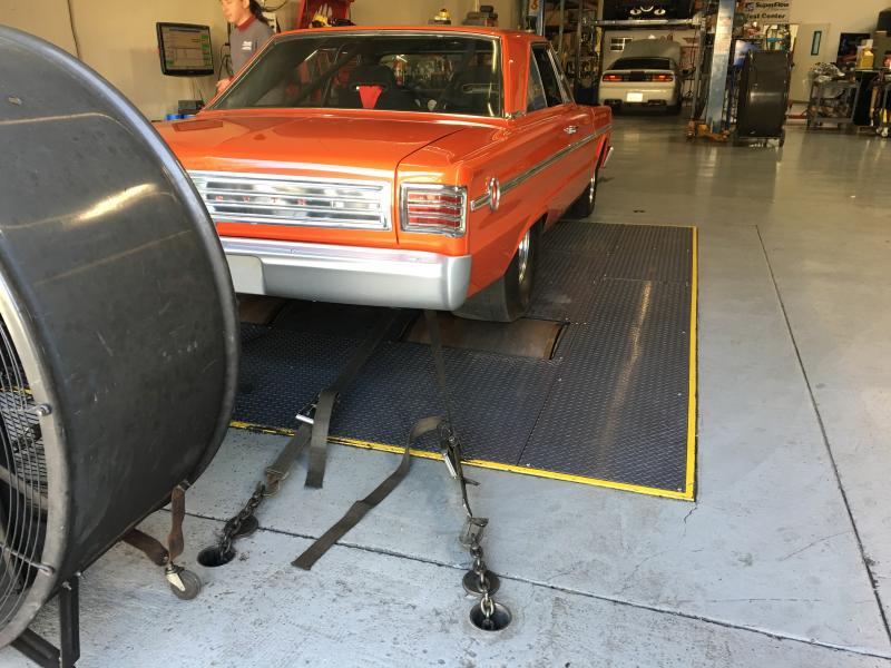

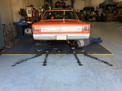

Finally made it to the chassis dyno to get everything dialed in. After a few pulls, the techs re-curved my distributor giving me a little more timing at idle. The Quick Fuel was dead on out of the box with no jets needing to be changed. Air fuel and throttle plates were adjusted and several more pulls were made. Best pull netted 532hp to the wheels, was hoping for a bit more but was told with a 5500 converter the power is just coming on when getting off the throttle at 6500rpm. Street driving after the chassis dyno tuning is night and day difference. Really hoping for 10.50 at street legal drags on March 5th!

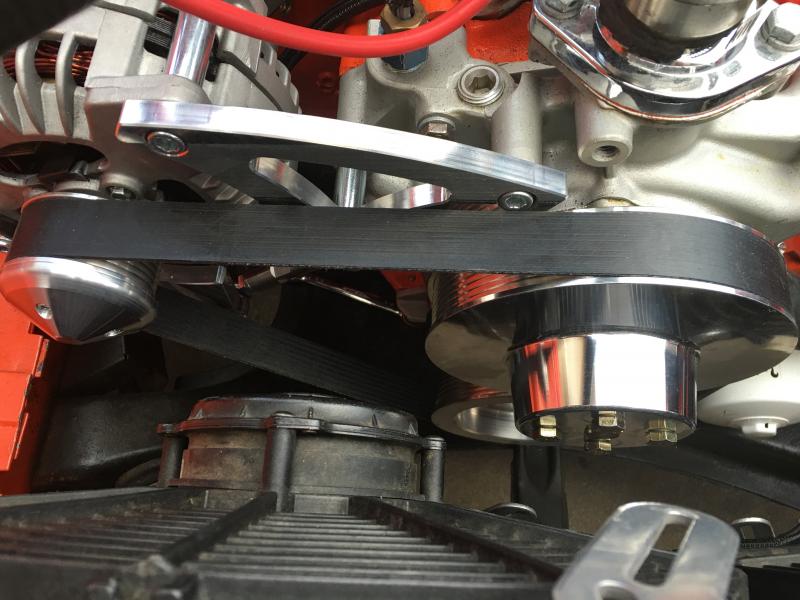

Thanks to moparcrazy, I ordered and installed 8rib serpentine belt setup from CVF Racing. It not only stays on at 7k RPM, it also stopped my overheating problem. Photos are poor, but it looks really nice when running. Taking it to Westech Performance Chassis Dyno in the next few weeks, then should be good for a first test and tune track days with the new motor!
Very nice. I have same set up on my car.
2quick your car is looking great! Doing a great job. Mmissile, just trying to hang with your awesome ride! Thanks for the compliment. Tempest 455, thanks, the serpentine set up has worked better than I expected.

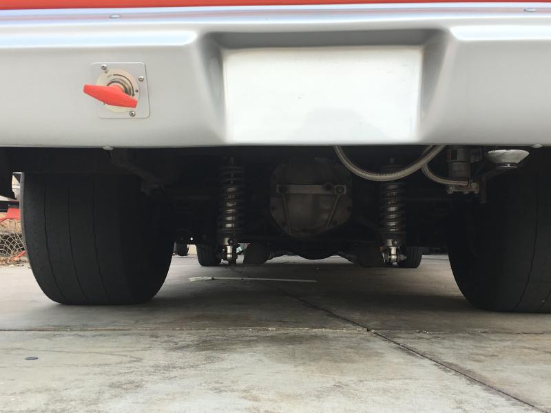

MINI TUBS? Seems big for standard inner fender move alone?
Thanks Mike for the info, that's going to help! 2quick yes it's tubbed, not sure of the biggest tire that can fit in stock fender wells, but the tire that's on it is pretty wide. My car has a narrowed Dana 60 with moser axles and a 456 spool with Wilwoods at all four corners. Good luck on your car it's looking great!

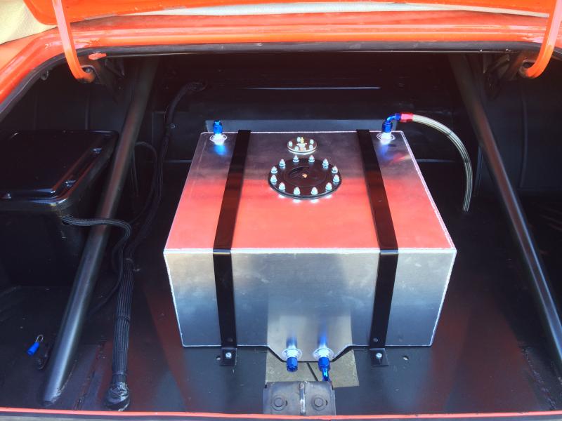

Are the frame rails moved or just the inner wheel well? If you get a minute take some pictures of the inside of the trunk.. How are the Bias ply's on the street?
Here is a picture of my trunk before I finished it. I have no issues with The MT ET Bias ply's on the street. Not sure I would drive them in the rain though! Might try the Hoosier Quick Time Pro next go around. Thanks for asking!
