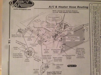

I'm intending to install Vintage Air aftermarket A/C in my 68 Sport Satellite. I want the install to look clean and as close to original as possible under the hood. I recall a thread where someone was saying to not follow the Vintage Air instructions that tell you to run the hoses via in-between the fender apron and inner wheel housing and instead to run them through the existing heater core holes in the firewall. Does anyone have any photos with it installed this way? Are there any special grommets (i.e. 4 in 1 or something?) Vintage Air instructions say to mount a block off plate onto the firewall and route the hoses through the fender removable plate (UCA adjustment access) and through the fender apron/inner wheel housing gap. From the instruction photos, I'm not a fan of their approach.
Comments?
Here's the vintage air diagram
