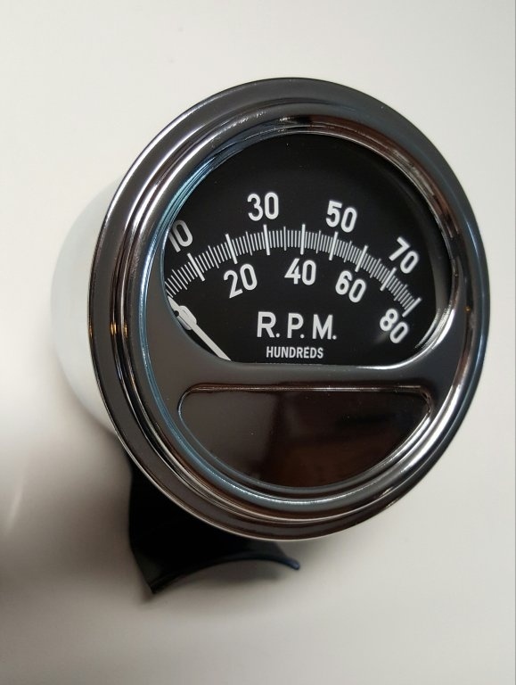

I bought a 3 3/8 tach for my '62 and I'm trying to find a good mounting spot. On the top of the column is too tight. (steering wheel interference) Man, I don't want to drill any holes in the dash. Maybe under the dash would work. Just not real visible. I did see one mounted on the hump.
So, any suggestions and pictures? Please only 1962 - 1965
This is the Bosch that I bought.

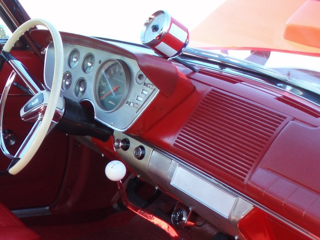

Mounted my old Dixco tach under the top edge of the dash pad. Flatened the bottom of the mounting bracket flange in a vise & just pushed it up under the dash pad edge. It is a nice tight fit without drilling any holes or messing the stock dash up. I had the same tach mounted this way under my dash pad in my 1973 340 Duster for 19 years & it never slid loose.

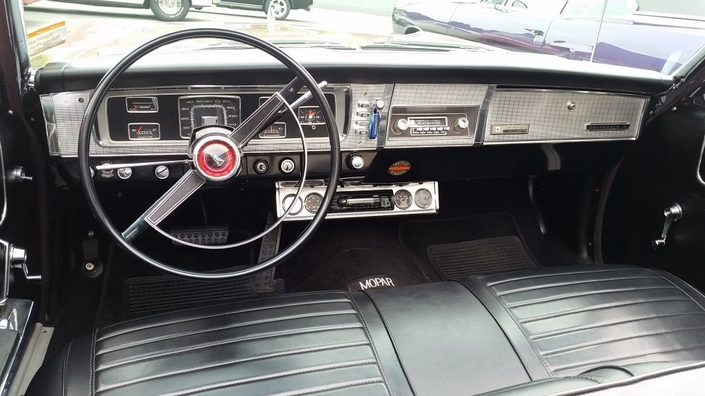

No spit balls here, but here is another idea....maybe the wrong location, but my buddy "MowPar" had a custom made under-dash box made up for his aftermarket stereo head-deck, and some gauges....
Fascia is crafted out of another dash unit from the same model car - 1965 Belvedere :thumbsup:

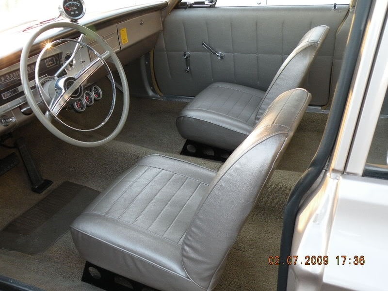

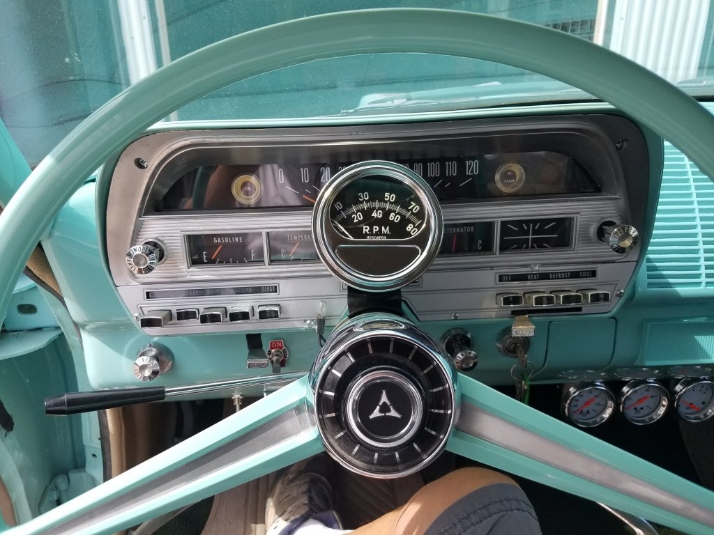

Mine is not real big as its an older Motorolla tach. But you can see I mounted it to the steering wheel and the only bad part is it blocks some of the speedo. Ron

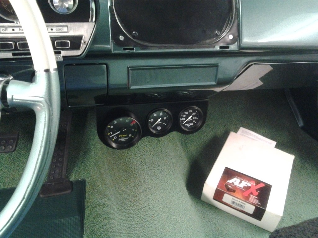

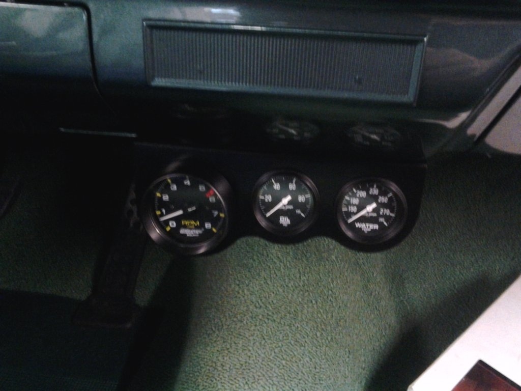

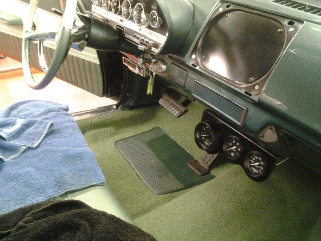

Her is how I did mine. Just made a bracket for the Tach, oil pressure and temp gauges. Used some current holes under the dash. Bent the bracket at a 70 degree mounting angle works great and can see pretty easy.

Just made a gauge mount to mount the tach, oil pressure and temp gauge under the dash. Used current holes under the dash works great.
20160514_090203.jpg 20160514_090229.jpg 20160514_090248.jpg 20160514_090203.jpg 20160514_090229.jpg 20160514_090248.jpg

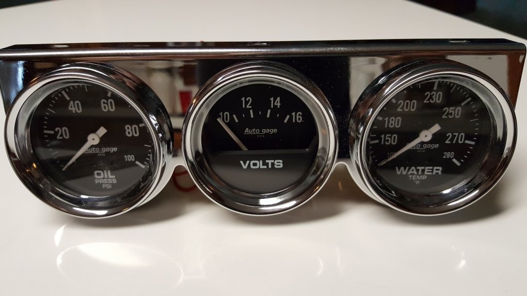

I was looking at that tach! Decided to go with a white needle to match the guages I found. Changed the amp.that came with them to a volt meter. Nice large gauges, nice retro look...

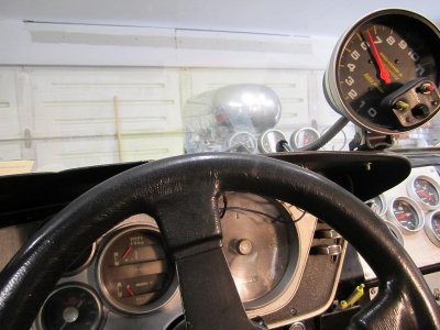

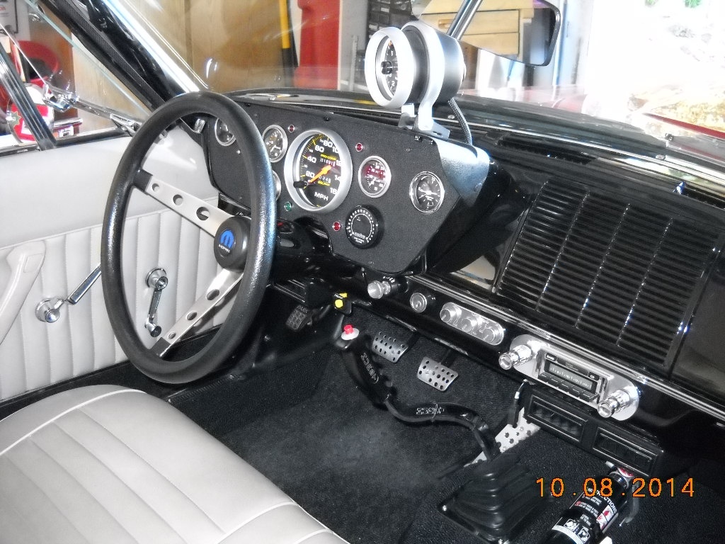

Me likey SONNY ****!! I had the big tach with a hole in the dashpad, I have a hard time looking at ANY gauges when my foot is on the floor,so now a shift light on top of the column and tach is part of the dash.
Some older pic's with the monster tach,and new ones without the tach & cowl gauges than went bye-bye and the new Joe Succi dash pad.

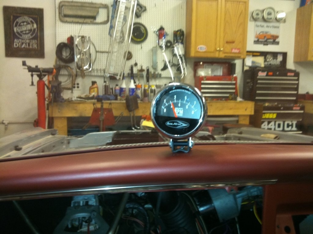

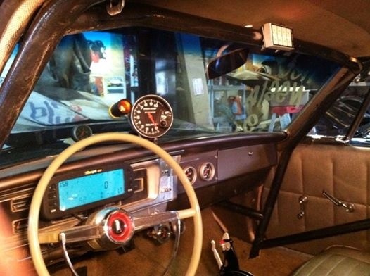

I mounted mine like I did in the 60s. I like the more 'industrial' look of the eyebrow over the gauge cluster, sans padding and upholstery. I guess it depends on whether you want it in your line of sight or not.
