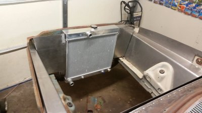

Photos of things. Donor floor, firewall, inner fender, frame rail, and cross member welded in place. Sherman Floor patch panels all welded in, great fit, great quality, great price. Made the small pieces inbetween the front and rear patches from flat 18 guage. Picked up a bead roller and had my oldest help me roll the beads in for the spare tire well area. Then decided to make more work and flatten out the engine compartment. Wiring will all be hidden. Going to use and electric assist master cylinder to lose the vacuum brake booster. The battery is being moved to the huge opening in the passenger quarter and the heater box requires some minor modification from losing the slant in the firewall. Either side of the radiator are cans, the right will be radiator overflow while the left side will be for bug fluid, the fill opening is going to be through the core support. Also building a stockish style sheet metal intake to run a 4 barrel on my poly and hide the heater hoses.

Cute kid. You must be young...those flares are actually 'skirts'. Be glad you're not my age...lol. Enjoying your posts. Terrific fabrication and welds. Keep it up!
Skirts yes, brain fart, thanks for the correction. Almost 32. I was born into a love of mopars, just picked up another for the wife.
