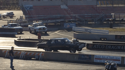

It seems to have really helped rearend rotation and the car squirts forward rather than lifting, separating, and then moving forward. I may still install some mono-leafs depending on how well it 60 ft.'s at the track.

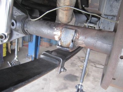

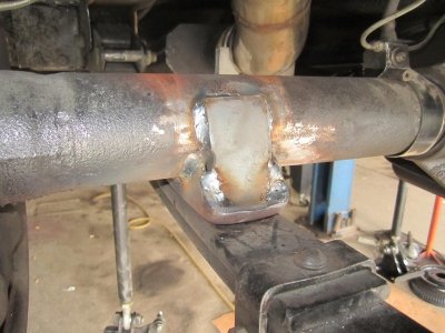

Mine has heavy duty aftermarket perches that were welded on by my chassis guy. He didn't think I need to box them but we shall see!

I had a set "in stock" for 10 years,stock OEM. So a little reinforcement should do the trick...........................I hope:steering:
