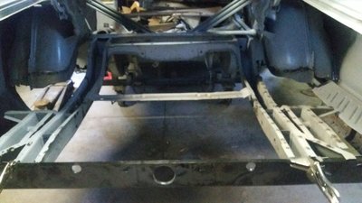

2nd frame rail is attached. now to clean up some stuff with the grinder, a little more welding then SPI primer and then ready to put the trunk pan in. once that is done I'm hoping the car has enough structure to put the differential back in so that we can roll it back up to my other shop and finish media blasting. does anyone have an opinion as to whether it will be wise to put the rear end back in and the car back on its Wheels without a tail panel?
All the weight on the springs from the differential is more forward. So the most weight is near the front shackles were your bracing is intact. That is why we do not need traction bars! lol....
Your issue is not when it is on the ground it is getting it to the ground. So install it in a way that puts the rear end in without stressing the body by its weight. Basically, jack it from the pumpkin....
Or you can get the caster setup from US car tool. For your restoration they would be ideal...If you were closer I would let you borrow mine...
