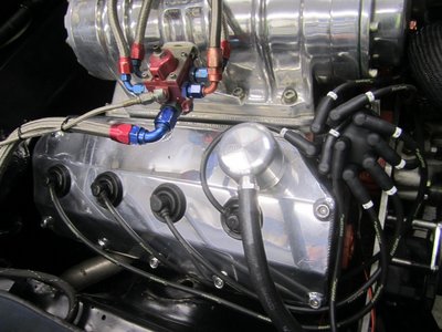

The Doug's Headers are great. They claimed the black paint that they are useing now won't burn off and it didn't! Almost resembles a ceramic coating now that it's been heated. #4 and #6 plugs need to be tightened with a boxed end wrench from underneath unless you bend yourself a wrench to accommodate the task. Another special tool I'll have to make .

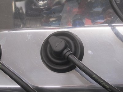

The MSD wires that I bought are Crap!
You install them on the plug once and remove them, they open up and won't snap back on again unless you squeeze the connector with a pair of pliers. I made sure every wire was "snapped" on before the 20 min cam break-in and two of them practically fell off near the end of the break-in. JUNK!
I'm looking at Firecore now...
Very nice outcome! I would call Rick at Firecore and have him make a set of wires.You can give him measurements if you like. I made the change from MSD to Firecore,would never buy from anyone else now.His distributor is a nice piece also!

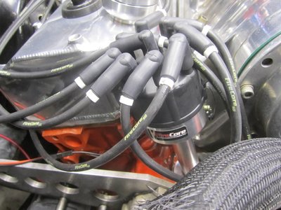

That SUCKS! However, I noticed it says on the box an MSD product. More than likely more **** from China. Just What is good stuff anymore? I agree with HEM-IITIS. I put Firecore on my other car a few years back. As far as the 65..... well I bought a wire set (not MSD) from Mancini. I may find it performs like yours!
The problem is the connector is mild steel, not stainless or a higher carbon with some memory in it. They have some quality to them and are nice looking. Lots of good reviews but they missed the mark on them being able to retain their hold after removing them once. Even if they made the clip longer to go all the way around the "sleeve", then it would retain its shape. Firecore is useing stainless steel ends...

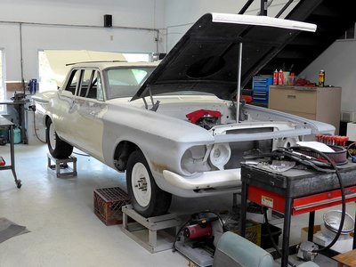

I've been working on the steering column and brake pedal assembly. Time consuming...
Here's a good idea for blasting small parts and hardware. Saw it on YouTube one day.
Changing over to a dual mastercylinder for all drum brakes.
I have lots of pics of disassembly and reassembling if anyone needs them.
Now I'm on to doing the complete brake system. Waiting to install the steering column after that's all done. The mc will have to be removed to bench bleed and it's so much easier to get to the hardware without it in the way.
Thanks for the column pics.I will be removing mine in the near future.I wish to gut all the 3 on the tree stuff,change the shaft to CM tube and do a removable steering wheel:thumbsup:
