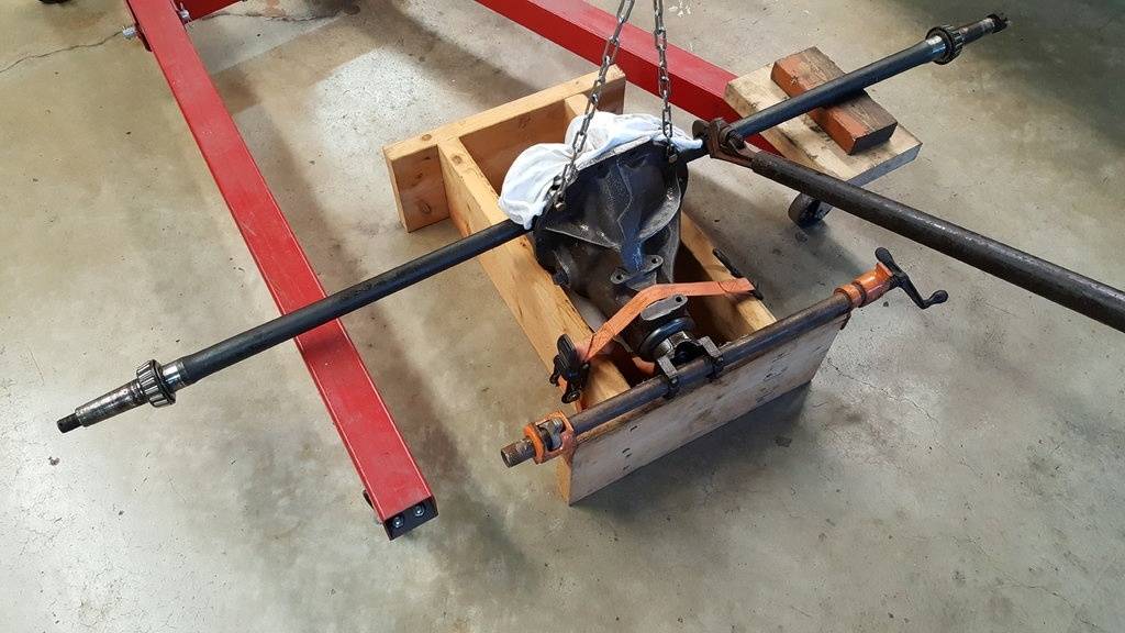

You must be doing it wrong KK. There was no swearing, no bleeding knuckles and no bent drum ;-)There's several on YouTube and they all seem to be struggling with the puller. I even saw one guy wrestling with a bar that he sticks between the fingers on the puller. I just had to show how easy it is.
Nice job on the vid, you can't go wrong with the right tool. I recently went through this, separated drum/hub and used later model slip on drums. Glad I did it!
Your car sounds great BTW!!
You were lucky! On my '64, using the exact same tool it took two days and a whole lot of heat to break it loose on the driver's side. The passenger's side was a bit easier. That's the reason I wrote the article on how to switch tapered axle rears to slip on drums. http://www.hotrodsandhemis.com/TaperedAxleBrakes.html Cost was under $100 including drums and believe me... servicing the rear brakes is much easier now.

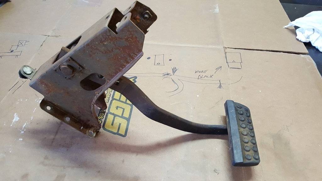

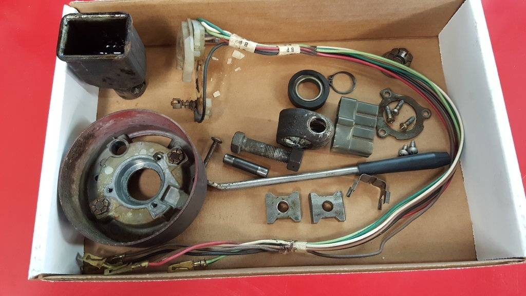

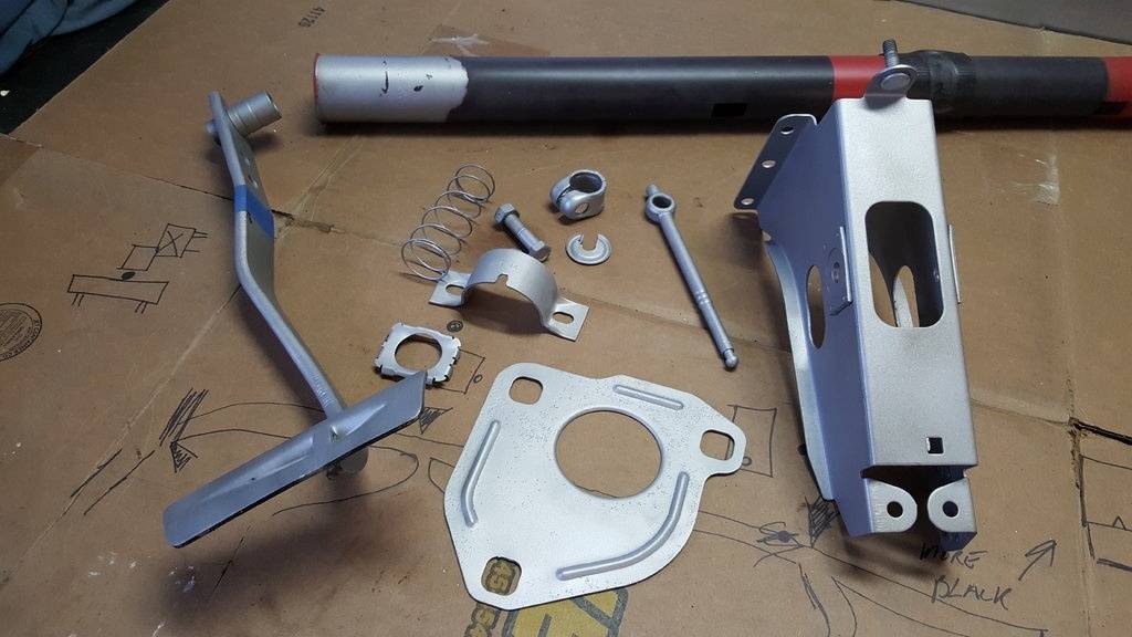

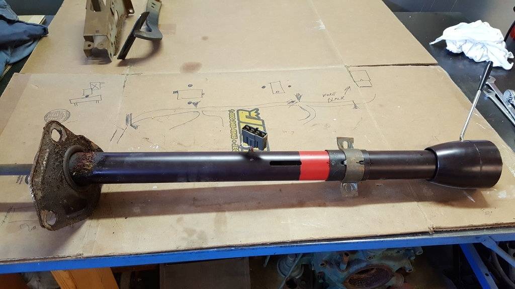

Really nice work Kid!I've been working on the steering column and brake pedal assembly. Time consuming...

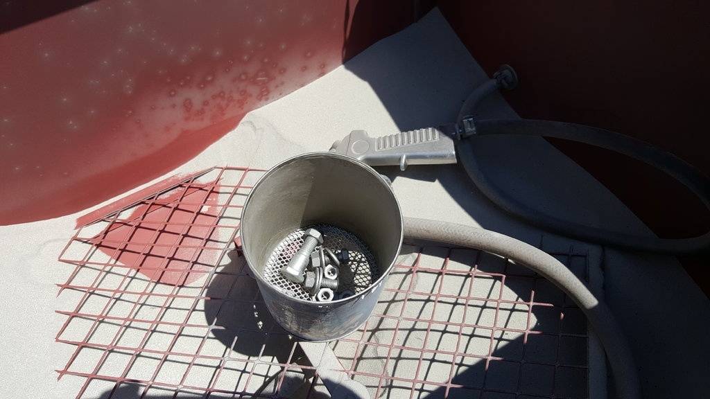

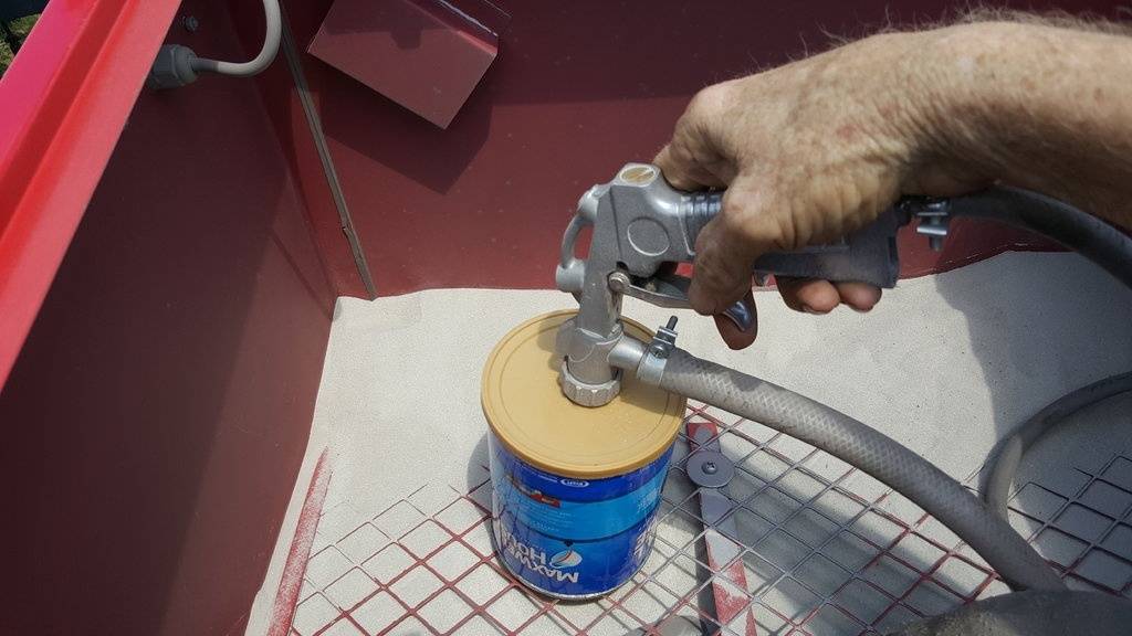

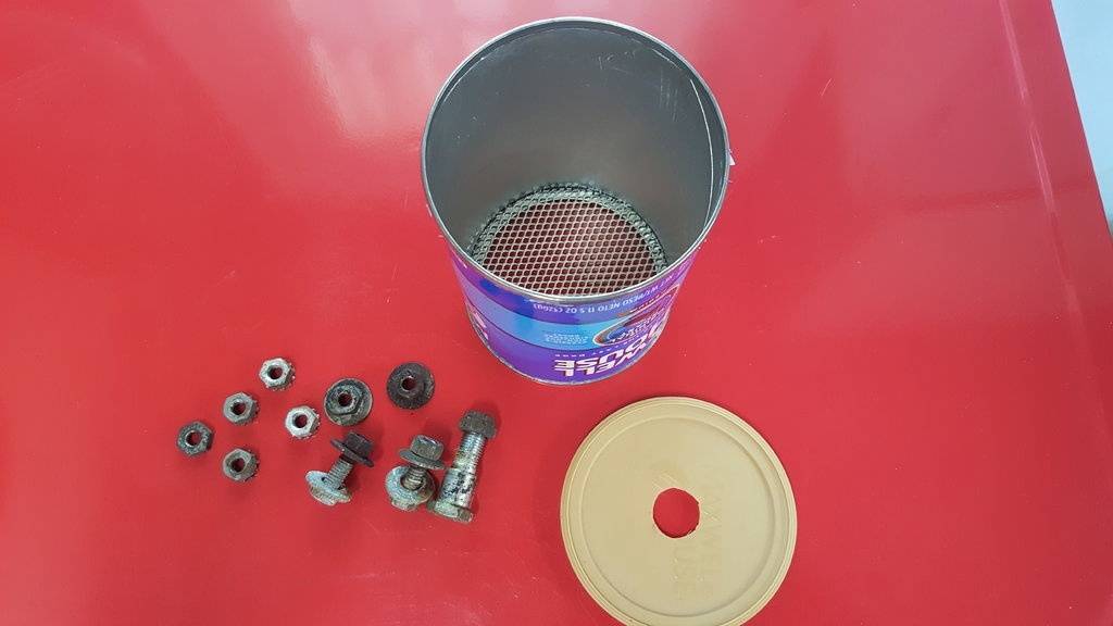

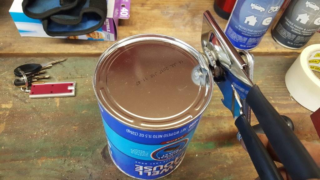

Here's a good idea for blasting small parts and hardware. Saw it on YouTube one day.

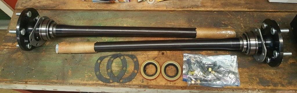

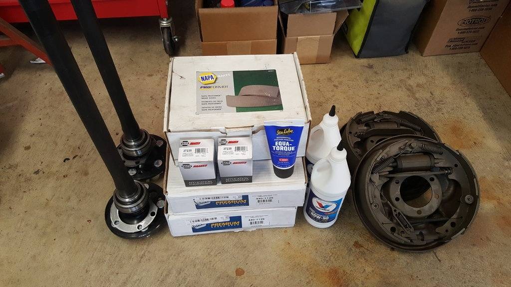

I would have gone that route but I needed the shorter axels to change over to a sure grip. So Dr Diff is hooking me up with flanged ones.
The passenger side was a little stubborn but after putting it under all of the tension that I dared, I took a 8 lb sledge and smacked the puller right on the end. About three hits and she let go. I know some can be stubborn. I did quite a few brake jobs on these and other makes back in the day.
You could have saved some bucks and just had your local machine shop shorten the stock axles. Its a simple job for them. On the other hand Dr. Diff does sell good stuff and he knows what he's talking about. I had to call him when rebuilding my diff. I needed a couple axle shims and found out no one makes them anymore. Had two choices... make my own or shorten the thrust button to compensate and that's what I ended up doing.
