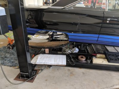

Today's adventure was the install of a new S60 Dana. It definitely is a job best done by two people but I managed it on my own. I ordered it from Doctor Diff with some custom tweaks. The '67s are notorious for the driver side wheel well being tight. To buy myself a little room I had it made 1-1/2" narrower which worked out great. Now my 275-60x15's will fit without rubbing. That's the good news. The bad news is that I ordered it with the heavy duty LPW girdle rear cover which won't clear the gas tank. So now I've got a regular cover on the way. Cass said he never heard of anyone else having this issue so I figured I would share. Bummer because now I have to wait before I can order the drive shaft.
Here's a few pics:

So I got the new cover for the rear end yesterday and it doesn't fit either! Aarghh :wtf:
Everything else measures out fine so the only conclusion I can come to is that the replacement gas tank I put in years back doesn't quite measure the same as the factory tank. I was able to get things to fit by coercing the tank a little with a 1x6 but it was not my preferred fix. I now have to hope that it doesn't "uncoerce" itself when I fill the tank and start driving it down the road. I was going to get a custom tank made at some point anyways so it looks like it will be sooner than later.
