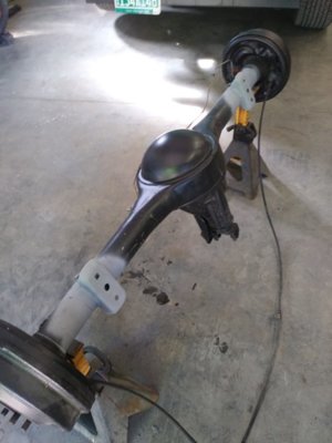

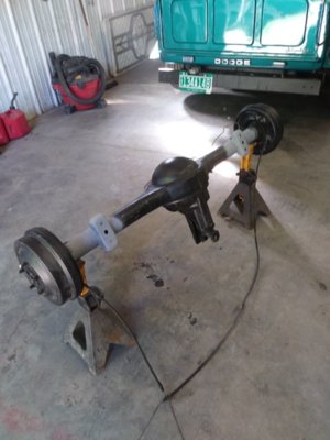

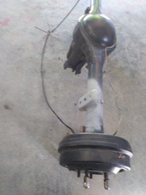

The eagle has landed!!! Well, the rear half anyway...lol. The rear of the Express is on the ground. First time since Oct 2014.
Looks like you got room to get some HUGE tires in there.
I figure 15" section width with 13" tread width and 26" tall. I might have to roll the wheel well lip though...Plus I would need different wheels.
Those shocks are salvaged from the 86 Dodge Power Ram 4x4. Front gas shocks that were covered in surface rust and crud. They operate great though. Push down on the rear end and the car comes up and stops. Need to paint them still.
