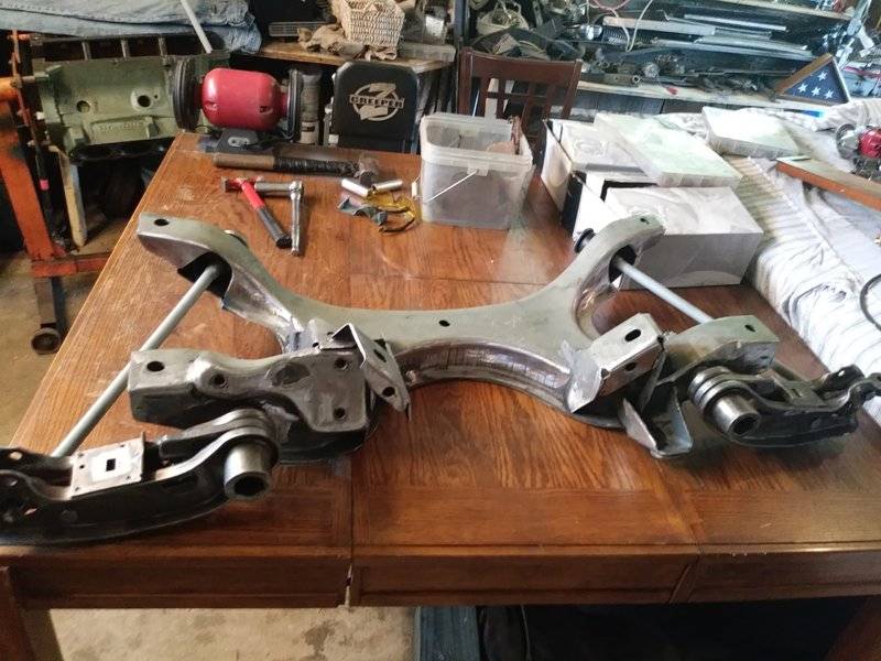

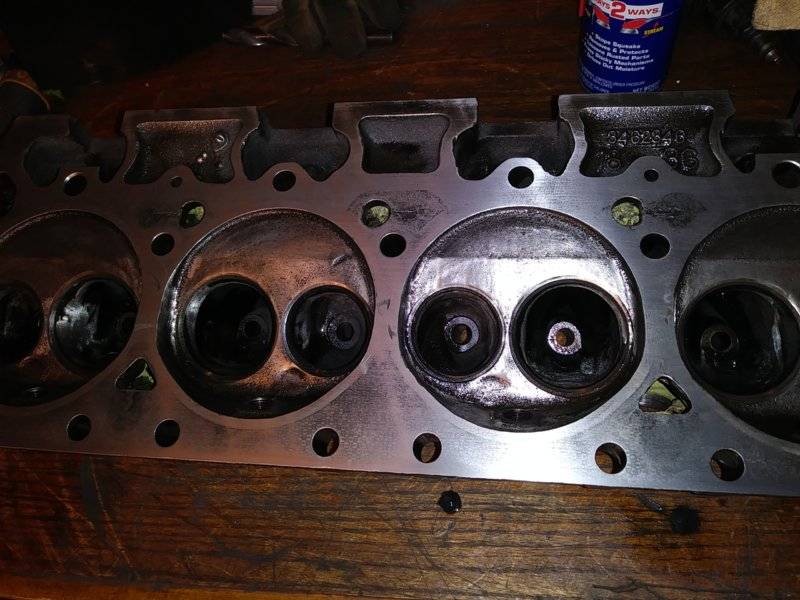

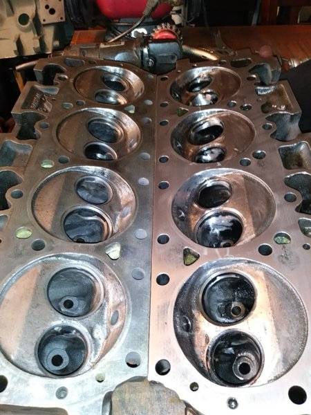

Finished up the other head today, ported, polished, unshrouded valves, took casting crap off water passages, worked the uneven valve cover rail, resurfaced the heads mating surfaces and lapped the valves.
