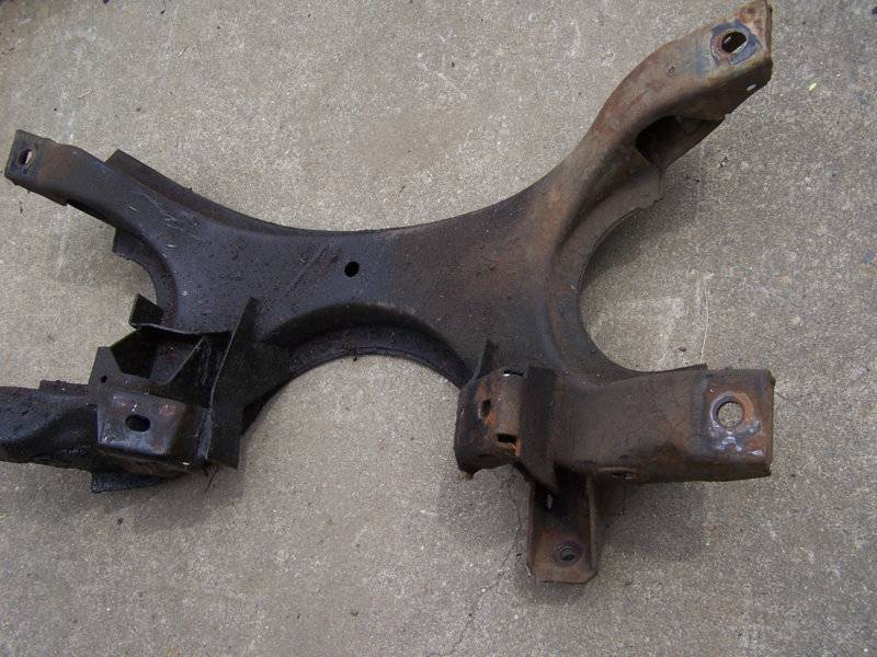

What you talkin 'bout Willis?Hey, why doesn’t that k frame have a double shear for the idler arm?
ThanksYou missed it. It's a rectangular 16 gallon steel tank that goes on the axle hump under the rear window in the trunk. The filler neck will go up at the rear of the left wheel well and the filler opening will be on the top of the quarter panel next to the front left of the trunk lid.
it says that's a 70 and up pictured...That looks like a 63-65 k frame.
Take a look at this link to to Schumacher.
http://www.engine-swaps.com/Pages/ProductsType/K-Frames.html
Was thinking the same thing. Great minds!!You are correct, damn 1 eye!

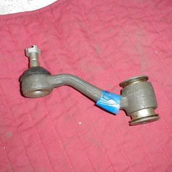

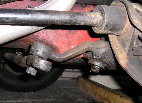

Mock up your steering and weld a plate to the top, that way you have double shear on the idler arm. Not only will it strengthen it, it’s also a safety thing. The factory fixed that screw up in 68’ and up k frames.
In that case it would be an inch higher than what I have, unless that arm is longer...….It should not slide on the sleeve.
