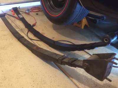

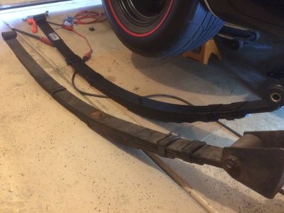

I started my MP XHD leaf spring install today, and it was more challenging than I thought getting the springs off. I recently put new Bilstein shocks on and the rubber bushing must still be nice and sticky because that was a PIA just getting the shock bottom off. To hell with that, so I took the top off and finally got the bottom after using a pry bar and wiggling it. Just wouldn't budge. The U-bolts were next. I've got the rear frame rails resting on jack stands, and the Dana pumpkin sitting on a jack with the tires off the ground. Loosened the U-bolts loose and got 3 off, and as soon as I got the 4th bolt off, BAMM, the spring sprung open and crap went flying everywhere, and the Dana pumpkin just about slipped off the jack (but luckily I left the tires on and if she would have fell, it wouldn't have been far). After that I put a jack stand under the axle side I was working and put the jack under the spring to take some tension off as I got the rear shackle off. None of the Mopar magazine articles discussed this issue, and in the other leaf spring discussions here, it wasn't mentioned. Did I perhaps have the rear axle lifted too high so the leaf inevitably would rebound more?
Not sure if it was my procedure, but for others, read the Service Manual. It states the springs should be hanging down with axle slightly supported so that the springs don't fully snap and rebound once the U-bolts are taken off.
But here's a couple pictures of the tired leafs compared to the new MP ones, and one of the front hanger bolts was actually missing. Glad I got the new AR Engineering ones.

I believe you don't want to load the spring. In other words it's hanging without any lift on the diff when you remove the u bolts.
Did you clean your pants? Yes,it’s happened more than to all of us at times, shaking your head and saying “you dummy”. AND thinking,thank god.
That is the reason no one posts about the spring tension. It's kinda like a, Right of Passage. Welcome Grasshopper.
The jack under the rear is just for safety and no load applied......Once the U bolts are removed than you can jack the rear up a bit to release the perches.....
What broke on yours was the center bolt. Apparently, age and stress did a number on that bolt and the same goes to the straps....
Your lucky and be thankful.....That could have been a bad situation....
As mobster said above.....No one posts the obvious.....lesson learned my friend and thankful you and the car got unscathed...
everybody remember safety first. we all learn some hard knocks but you can't enjoy your ride if you are in the hospital. thank god your o.k. next time someone post needs springs you can be the first to let them know not what to do.
Yea, now that I've had time to think about it, makes sense, should have had the springs stretched out instead of compressed.. I forgot to be smarter than what I was working on. :(
