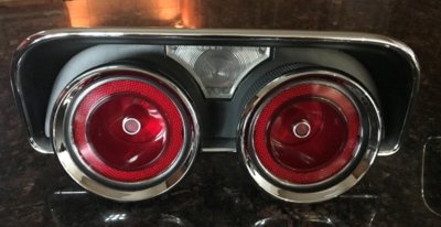

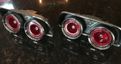

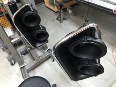

Finally finished up the taillights last night. Been quite a few years since these were fully assembled. More stuff to put on the "finished pile"
Thanks showard. From the looks of your avatar we appear to share sisters. Have you finished it?
What kind of paint did you use to touch them up with
The paint is Matte Gloss Hot Rod Black single stage Urethane. Got it from The CoatingStore.com. Same paint I'm using for the tail panel black out as well. Did a bead blast on the surfaces then applied some DP 90 (epoxy) before the base coat. It looks close to the original paint...but opinions very. The Urethane sprays out nice with a HVPL setup w/35 psi at the gun. I use a full face respirator when spraying this paint...wicked stuff

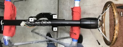

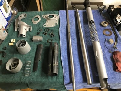

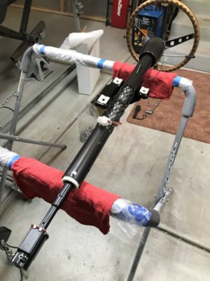

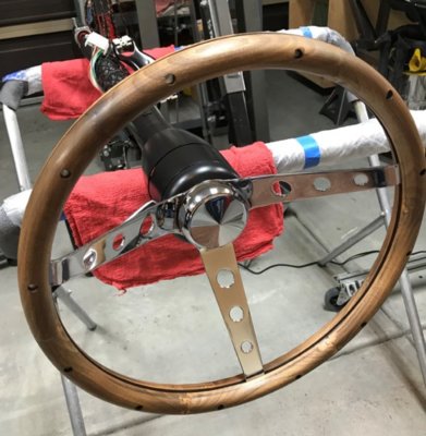

New bearings, wiring, crush capsules lipstick and BOOM a new 50 yr old steering column ready to bolt back in..
Walnut wheel doesn't hurt either.

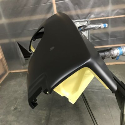

Finished up some of the unglamorous part of this build. Seam sealing is done! On to bigger and better things.
Had a chance this weekend to spray some high build primer on the quarter panels to address some scratches and a minor wiggle. Another round of blocking then on to...something else
