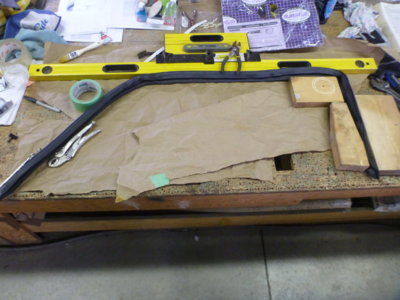

Working the seal into place. To avoid stretching I started at the B post corner as it was the most positive location. Then tucked the A post corner in place and the lower end on the A post where there is a location tab . Then worked the seal in between all locations.
Roof rail seal pegged in place.
Again with the plastic brush handle soaked in window cleaner. Without the "lube" it's VERY easy to mar the surface of this seal material.
Drivers side roof rail seal in place.
Passenger side in place.

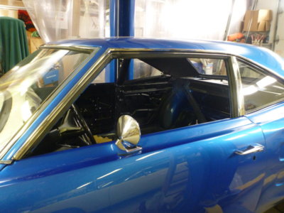

FINALLY, a reproduction part that is spot on with correct details, other than part number! :rolleyes:
Mirror installed to car with new gasket, captive washer 1/4" nut on the stud inside the door and oval head philips screw from the top.

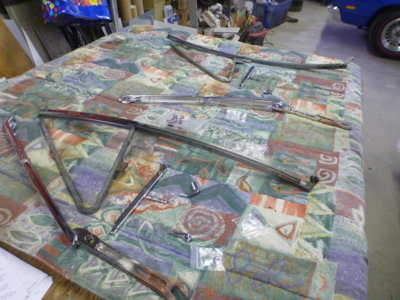

Making sure I've located all the parts for the puzzle to get the door glass done. Gotta thank the dozen + guys before me that documented at least part of the assembly and it's parts... as the FSM is lacking to say the least.
Installing the bracket, that holds the vent frame post, to the door fronts interior. NOTE: THIS BRACKET BELONGS IN THE OTHER DOOR.. UPSIDE DOWN HERE!
Bottom of the vent post sits over this bolt. NOTE: THIS BRACKET BELONGS IN THE OTHER DOOR.. UPSIDE DOWN HERE!
More chromer BS. Driver's side pin left jammed into swivel head and chromed. Pin is suppose to be mounted in vent frame.
Pin clamped in vice and crow bar to remove, of course damaging the new chrome on the swivel head because it slipped.
On the other side, they left the pin in and it got chromed, so is now larger in diameter than the hole in the swivel head it mates to.
Had to ream that swivel head out to #12.
Installing the drivers side pin with some JB weld to keep it in. It's been rotating improperly there for 40+ years.

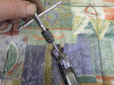

Special screw that holds the post and vent window frame together. 10-24 flat head with threads cleaned up.
Cleaning out the threads after chroming with a 10-24 tap.

Looking at other installs and brackets for sale being identified as "left" side only etc, I think I may have the vent frame attach brackets in the wrong doors. The way I have them they fit nice and are supported by the flange in the door almost like that is what was intended, but others show them unsupported and "flat face" up, not down. Can anyone confirm I need to swap sides?? Thanks!
NOTE: I HAD THE BRACKETS UPSIDE DOWN! THEY GO FLAT SIDE UP AS SHOWN IN PICTURE #2 !
