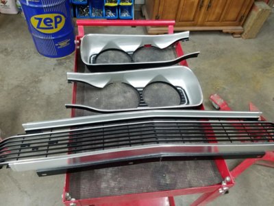

Since my grill wasn't in terrible condition, I decided to try to clean it up with a scuff and repaint. I really like SEM paint and went with their trim black and titanium silver. I think it turned out ok for a driver and if the small scuffs in the anodizing bother me later, I can always send it off to get restored correctly.

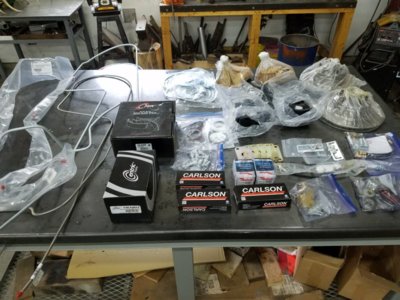

Been like Christmas around here this week. Boxes coming everyday from an order placed with Dr. Diff last Friday. Decided to go with the stage 2 disc conversion with the bigger rotors as well as a 15/16" bore master cylinder, both being a first for me. Waiting to order the Strange S60 from him and hoping Strange runs a special on black Friday like they did last year. Cass is the best . Wish every vendor would copy his business model.

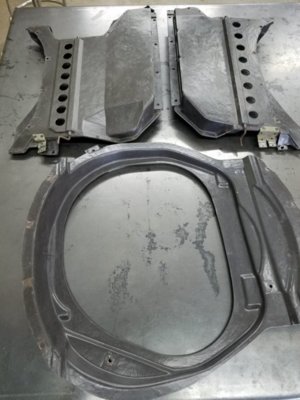

Dug out my Ramcharger ductwork. Cleaned it up with Simple Green. I think it looks really good for 50 years old. Couple of easily repaired minor cracks. One mounting tab that was already broke when I got the car. The car was taken apart 15-20 years ago and went through 2 owners and several moves. I am certain this tab got busted somewhere in that time period. I kind of like the patina and dont want to paint these parts if possible.
Thanks to @Photon440 for the recommendation of a fix for this tab. Had 2 nice contact points left so glued it in place with plastic welder.
I'll let this set for a day and then the plan is to use fiberglass resin to fill in the hole and I think I will build it up on the back side for added strength.
