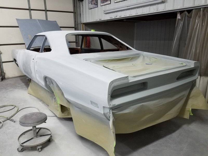

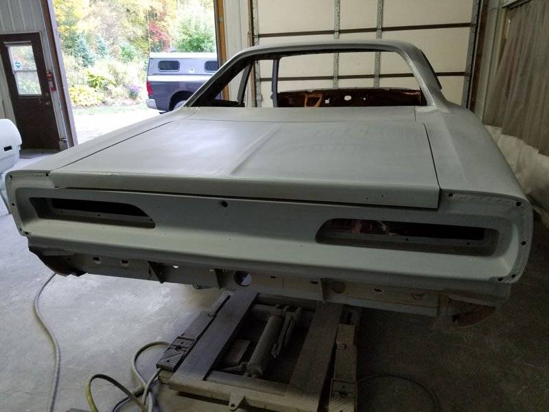

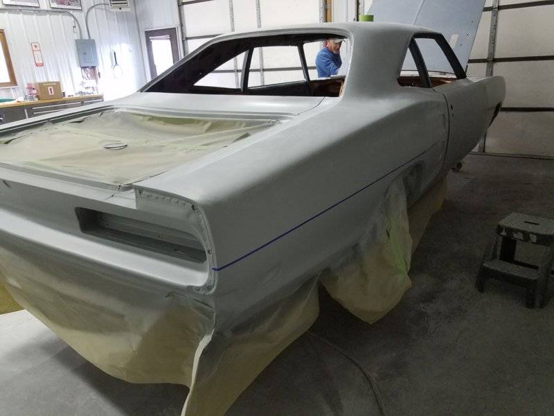

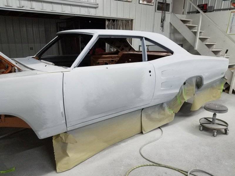

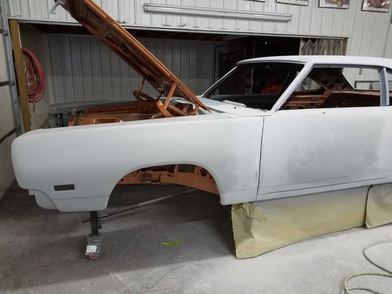

Starting to feel like a little kid at Xmas time over here in WI. Got a call from my buddy asking for more supplies for the Bee. Stopped over to drop the stuff off and helped him take the hood off for the final prime and blocking. AND the best part is that he wants the body color and clear delivered next week. Everything is moving along nicely.
View attachment 856565 View attachment 856566 View attachment 856567 View attachment 856568 View attachment 856569
Great progress, bodywork looks great

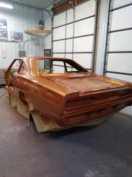

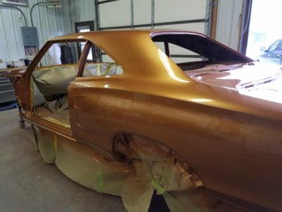

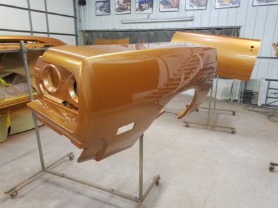

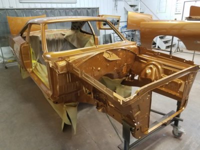

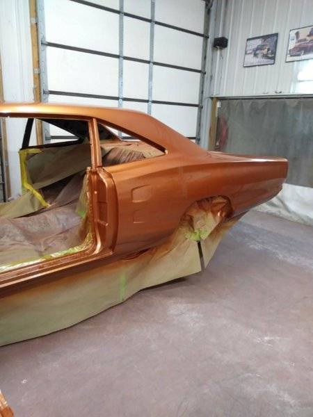

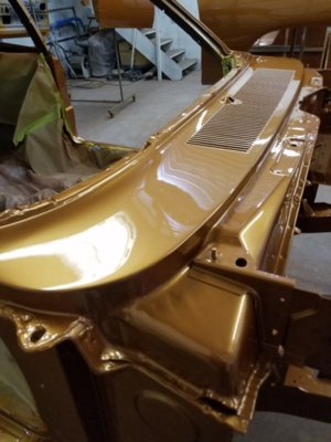

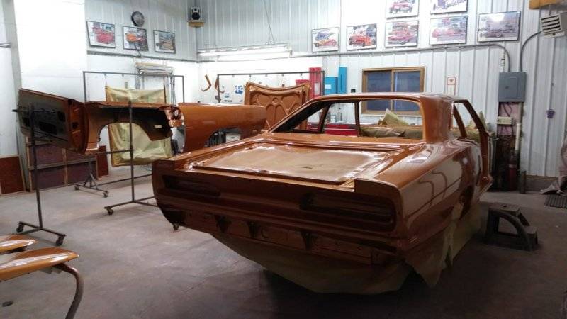

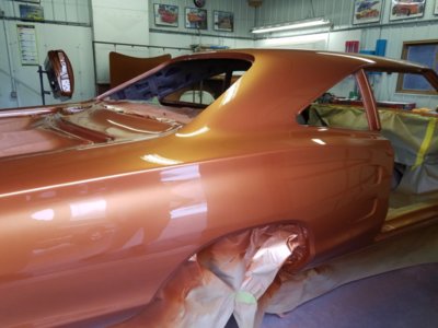

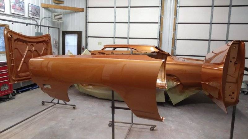

Looks like I got myself a copper Bee. My buddy just sent me these pics 1/2 hour ago. I am going to check it out in person tomorrow.

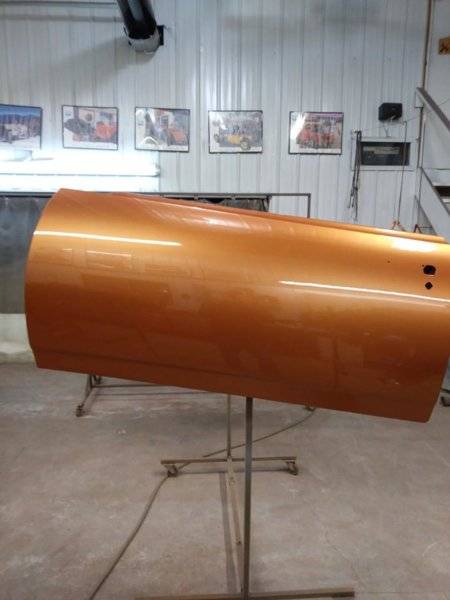

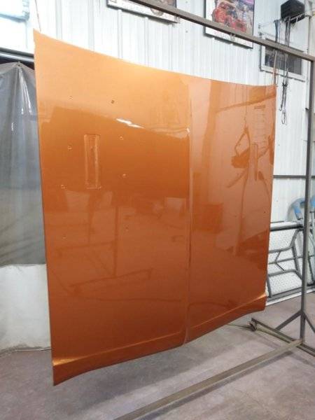

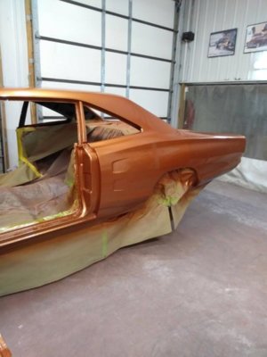

Few more pics. He is hoping to paint the black on the inside of the doors, interior upper quarter pieces, and inside of the B pillar posts today. Then a cut and buff and haul it back to my garage!
20191117_100934.jpg 20191117_102003.jpg 20191117_100856.jpg 20191117_100656.jpg 20191117_100732.jpg

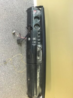

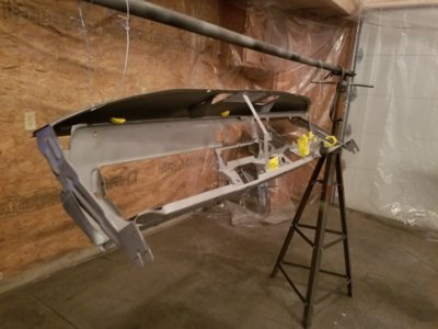

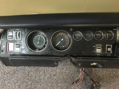

Been getting the dash in order while the car is away getting painted. It was a normal crusty 50 year old piece. Stripped it apart, blasted, epoxy primer, and painted with textured PPG black.

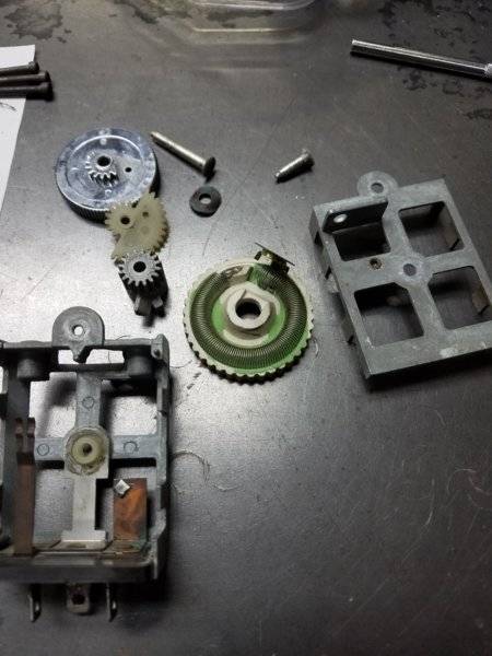

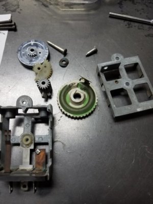

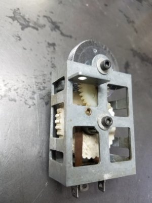

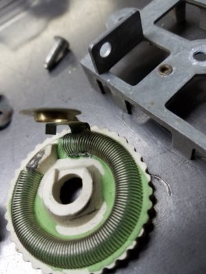

I always take all the switches apart, clean the contacts, dialectric grease, and check that they are operational. The only difficult one is the light dimmer switch. It is riveted together, so a guy has to drill those out. I put them back together with a couple of socket head cap screws.
