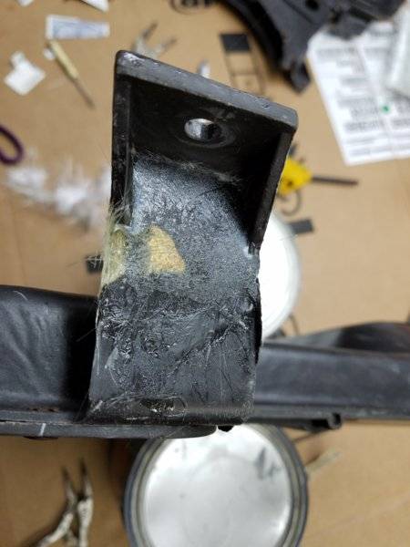

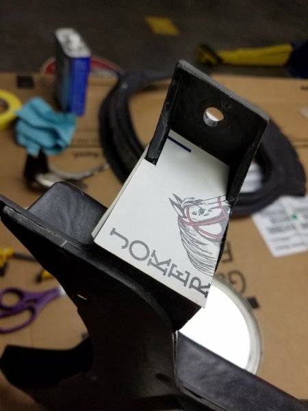

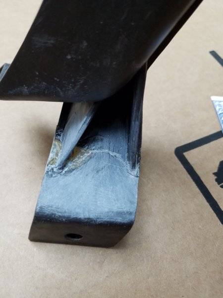

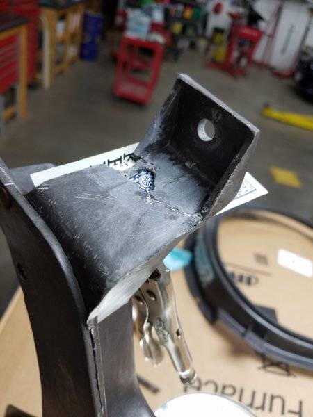

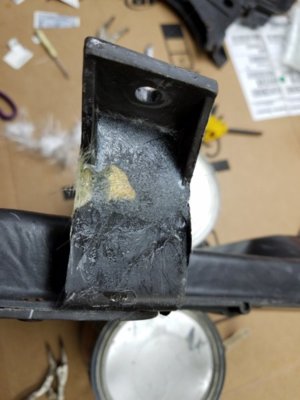

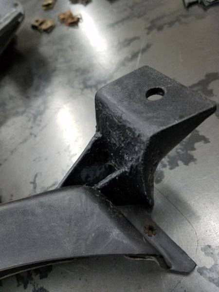

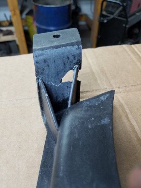

For sure do the repair on both sides. After it has set, you can shape it with rough sand paper, then go to smoother grits just like you were rubbing out new paint. After a fine enough grit and some rubbing compound, the surface will have the same semi shine as the original and you'll even see some glass strands just as the factory made it.
