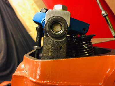

My gross valve lift is .540, half of that is .270. So .270 is where you want the geometry square right? Square means to do this, draw a line on the side of the rocker from the center of the trunion, to the center of the roller tip, am I still right? Now at 1/2 valve lift, in my case .270, you want that line I drew on the side of the rocker, 90° to the valve stem, that is what square is, do I have that right?
I got tired of waiting for a friend to get back if he had a valve spring compressor to use on the engine, or even make one myself, so I just bottomed out the lifter with the adjustable push rod checker and rotated the crank till I had .270 lift on the valve I am measuring. Now look at the pics. This is the best I can get with .045" shims under the shaft. Shim kit from Mancini. The shaft still needs to go up more, and the roller tip is way off to the exhaust side. There is no way to get the roller to sit in the center of the valve stem, and maintain square at 1/2 valve lift, by raising or even lowering the shaft.
This pic is at max lift
And, If I use a lash cap, the shaft will have to go up even higher, the same amount the lash cap raised off of the valve stem. Is that right? Using a .060" lash cap, I need to raise the rocker shaft .060" too?

The stripe. It does not change much. Always rides on the exhaust side of the valve tip. Yes, up and back. Up gets the rocker square with the valve stem, back puts the roller in the middle of the valve stem tip once we have achieved square. We can shim the rocker shaft up, but, we have no way I know to move the shaft back or toward the intake side to maintain square. That dimension must be built in to the rocker arm. If I keep going up with the rocker shaft the roller will eventually ride the middle of the valve tip, but we will no longer be square.
It seems like the only thing I can do to use these poorly designed and expensive rocker arms is to put a .060" lash cap, and get a B3 rocker shaft shim made about .095" or more.

When measuring for square at 1/2 lift it tells you which way the shaft needs to go, up or down. In the pics you can see my line across the rocker, center line between the roller tip and fulcrum. The roller tip is higher than the rocker shaft. The shaft needs to go up to get the 90° angle between the valve stem, or spring retainer which I am using to measure the valve side, and rocker arm.
Top pic shows roller tip on stem at max lift
Center pic is checking square at 1/2 lift
Bottom pic shows roller tip on the valve stem at 1/2 lift
You cannot make the geometry correct with those stupid Mancini shims before you run out of/off of the valve tip. And you can make it worse with lash caps and lowering the rocker shaft. Run what you have and you will have no problems with your cam. Or you can make it better by working with B3RE!!!!
The Mancini shims have issues. They were just used to verify what happens when raising the rocker shaft. Those shims do not seat well between the shaft and pedestal. I can only imagine how much oil will leak past the shim and never get in to the rocker shaft.
Ordinary shims do not do the trick.
See how the B3 kit moved my rocker shaft, up and away from the valve.
See the contact pattern before and after.
Micheal from B3 is a helpful guy and will set you up with a kit to get it right.
He will send you a sheet to complete some measurements.
A side note is, that you must be prepare to elongate the bolt holes of the rocker shaft to give space for it to move off-center.
View attachment 914800 View attachment 914801 View attachment 914802 View attachment 914803 View attachment 914804
Those are nice! I sent the measurements back to Michael. Lets see what he thinks.
Harland sharp rockers don't necessarily 'suck', but on these big block Mopars they almost always have to be relocated up and away from the valve stem. B3 will make the proper spacers to get you all set up. One thing to note here... It does require enlarging the mounting holes in your rocker shafts. B3 will do that for you (recommended) or you can do it yourself with a burr, but it's messy and noisy! Kind of a pain if you don't do that stuff all the time
