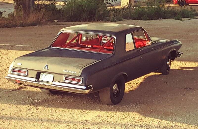

If I shift from 2 to 3 gear ( full manual valve body ) I get a big loud bang coming from the passenger side , there where I have one layer more leaf springs ( XHD) .
I try many adjustments already , normally I like on street drive to make the caltracs full “ open lose “ so like you not have one Installed.
But the gap between the Aluminium sleeve and the lead spring I think is to short , and if I shift from 2-3 gear under not full load ( wot) it’s bang very loud from the passenger side .
I think the rods specially on the passenger side a little to short , so I can not bring the Aluminium sleeve far enough away from the leave spring , and so if I **** by normal street driving is a big loud bang every time , specially from 2-3 gear .
So, now I try to give the caltracs some pre load , first I try 1/4 turn , 1/2 turn and after also 3/4 turn , for see maybe the loud bang goes away if I shift , but it’s don’t go away .
Any idea , or same experience ?
