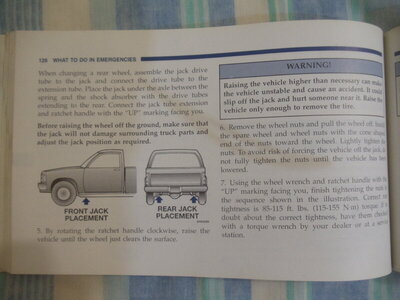

I won't know for sure until tomorrow morning, but I believe I strained my lower back. One front tire on the '96 Dakota had 10 pounds less air than the others so I pulled it off at home. Instead of using the wimpy factory lug wrench, I brought out my extra large star wrench.
I could just barely remove the theft-proof nut with the special key. Then I struggled like hell to break loose the first regular lug nut. The second regular lug nut would not budge, but my back was about to snap in half. Forget this, I brought out my Craftsman 1/2" breaker bar and six-sided 3/4" socket. Not much better, I could feel my back straining as I successfully removed the remainder of the lug nuts. No way an average female could have changed this tire. And with the provided factory lug wrench, I may have failed as well.
My owner's manual specifies tire lug torque specs at 85-115 ft. lbs. That seems like an extreme range for such a critical item. Anyhow, I recently purchased a four-tire set of new Michelin tires at a local chain tire store. Don't remember if the tires have been rotated on their premises for the first time or if the tires still remain as initially installed. Regardless, I hate to see tire "tech's" using the same impact wrench to remove/install tires on all customer vehicles. Ought to be a law (there are laws about tire pressures). My poor aching back.

If that one was blasted, 3 more to go! I'd go back to tire shop and have them break them loose. Then hand them star wrench to snug the nuts then torque wrench.
At my buddies shop he uses torque sticks (they come in different foot pound ratings) with his impact gun on tire nuts. It limits how much torque you can apply when using a impact gun. I guess they do not use them!!!
Torque sticks work pretty good, I use both the sticks and the wrench and never have a foul word on my stuff
I changed many tires on my Viper when I was racing the road courses in the southeast. I always torqued the wheels to 100 ft.lbs. That is not extreme and as hard as you described to get off. Sounds they laid on it hard with the impact. The tire shop I use now uses the torque sticks. I was told the color marks indicate the torque.
Yep...overtightened is more dangerous than under tightened. When the lugs are lose you get plenty of warning in the form of noise and shaking....over tight and "BANG"....the wheels off! First thing I do when I get home from the tyre place is recheck with my torque wrench.
