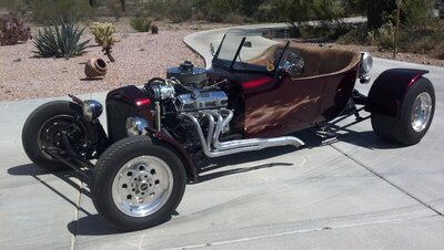

I just had a major scare. My '23 TBucket's big block Mopar 383 was running the best it had in a long time. My neighbor and I had taken it out around town for the evening, setting off a few car alarms in the process...
When I started the car the next morning I was met by a horrifying 'rod knock'!!! It sounded like someone was inside the engine, trying to beat their way out with a sledge hammer!!! Tweaking the timing didn't change anything. My heart sank...
I drained the oil and found no metal shavings. Whew! Then I pulled the pan, fully expecting to find a crankshaft or rod that had committed suicide. In order to remove the pan, I had to remove the dust shield on the front of the 727 transmission. It was about then that my neighbor and I found that 2 of the 4 bolts that mount the torque converter to the flywheel had backed out about a 1/4", just enough that the stampings on the heads of the bolts were hitting the edge of the block!!! Added Loctite and re-torqued all 4 bolts. Disaster averted!
NOTE TO SELF (and you!!): Add checking those bolts to the Routine Maintenance Schedule!!!
As much as I love these cars, THAT is a design flaw that should have been corrected years ago. There should have been more offset to the flywheel. This would put the converter rearward by a greater amount and offer more clearance for the heads of the bolts.
I've had this happen before and it is always a sinking feeling.
Not the first report of that happening here. Glad it was minor.

You can add me to the list.I had the converter bolts loosen too.
BUT only once. Loc-tite ever since.

I had the dust cover itself lose all but 1 small bolt. It shifted enough so the corner was hitting the flywheel. On the highway. Made a very spooky sound. But crawling under one could quickly see what was going on. I removed for the rest of the trip. That was a MAJOR relief seeing that. And car was then purring happily all the way home.
Have a car here now that came in for a 'minor' tune up and a couple of other small issues and it started knocking so it got shut down. First thing I checked was the converter bolts but they were good and tight. Next start up showed it was running on 7 so off come the valve covers and that showed a broken valve spring. The knocking sound was a piston slamming a valve......engine is about to be pulled after pulling the heads and finding many other issues that point to someone trying to pass a POS to someone that isn't on their game.
Buddy of mine bought a 69 Charger R/T, it had been parked since 1980.. Story was the original owner had taken the family on a road trip.... Somewhere in Oklahoma the engine started knocking.... Welded a tow bar to it & dragged it back to Barstow California & stuck it in a barn.... Never got back to fixing it... My buddy bought it in 2001-2002 time frame... We stuck a battery in it & it turned over... Added fuel & it fired up & ran.... Weird knock... I'd heard a similar knock before, lets check the torque convertor bolts... Yup...
I use a drop of blue loctite on the converter bolts and never had an issue. 440'

I had that sound on a small block one time. The damper pulley was loose, knocking back and forth on the bolts.
