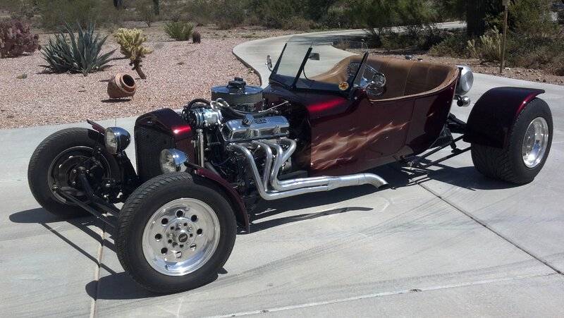

I like this one, sloped windshield and not a stinkbug stance with the stretched frame.
I'm about a foot and a half longer than all the other TBuckets in the Phoenix area (except one which has a back seat and looks like Santa's sleigh...) I also sit lower than those with a bench seat. I sit on a cushion on the floor and my legs are extended so that brake and gas pedals are controlled with ankle movement. My knees don't touch my cheeks like so many others do! Great for long distance rides!
Hey John, beautiful ride you have. Being from the "Gates of Hell" also, my eyes immediately fell to the a/c compressor. How much relief do you get when it's 115*. LoL
It (Vintage Air under-dash unit) blows enough cold air to survive 115+ temps. But I still pray for a tractor trailer at stop lights to get a little shade!! :)
Beautiful ride!! I bet its loud ! Have a video ?
I have several videos - my favorite is my granddaughter driving it! - but the site doesn't seem to allow video uploads...
But to answer your question - Yes, it is loud! Before the exhaust tips were welded in place, I took a step drill to the center baffle in the glass pack and enlarged the hole until a Harley rider next to me at a stoplight had to check his tach to see if his bike was running! :)

View attachment 1054439I just had a major scare. My '23 TBucket's big block Mopar 383 was running the best it had in a long time. My neighbor and I had taken it out around town for the evening, setting off a few car alarms in the process...
When I started the car the next morning I was met by a horrifying 'rod knock'!!! It sounded like someone was inside the engine, trying to beat their way out with a sledge hammer!!! Tweaking the timing didn't change anything. My heart sank...
I drained the oil and found no metal shavings. Whew! Then I pulled the pan, fully expecting to find a crankshaft or rod that had committed suicide. In order to remove the pan, I had to remove the dust shield on the front of the 727 transmission. It was about then that my neighbor and I found that 2 of the 4 bolts that mount the torque converter to the flywheel had backed out about a 1/4", just enough that the stampings on the heads of the bolts were hitting the edge of the block!!! Added Loctite and re-torqued all 4 bolts. Disaster averted!
