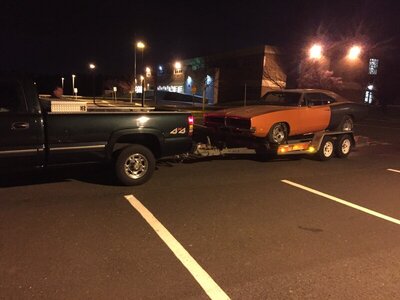

So like everyone else I’ve been wanting one forever. I bought this right in the middle of March as everything was closing down. I remember bringing food going to pick it up just because everywhere was like a ghost town.

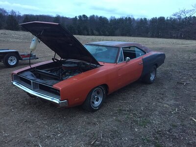

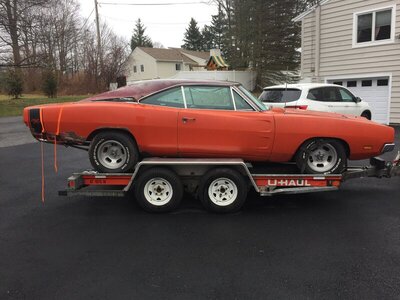

Saw it on marketplace, looked pretty clean other than someone cutting it up to fix. Otherwise nice and clean. Being in the body/resto world for a long time it wasn’t a problem.
It’s a 318 car. Someone put a ‘69 340 and 727 in it. So that’s a big plus. Runs nice but leaks everything. It was an A/C car. It’s got power windows too.
I’ve been working on it here and there while at the same time finishing the insulation and interior of my garage. Air lines, insulation, ceiling and walls, and lighting. So progress is kind of slow.
I’m starting a thread to show what I’ve done and to help me get back into the groove.
My goal is to get all the metal installed, primed and back together so I can enjoy the car this coming summer

The person I bought the car from had been trying to buy this car for almost 15 years. He found another and then this car became available, however he couldn’t keep both and it was killing him to have to sell it. I could read it all over him. I feel lucky to have been able to buy it. These cars sell in a matter of minutes on the web.
It’s also a pretty clean car for the east coast. It has never been undercoated and is pretty clean!
