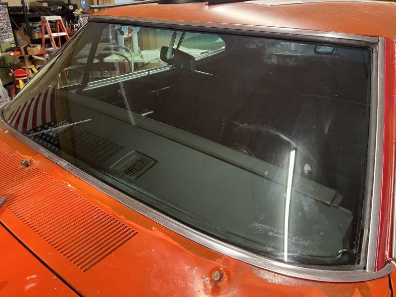

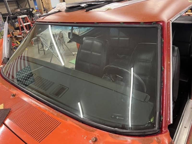

Put the new AMD windshield in this afternoon. Was easier than I thought.
I used 3m bedding and glazing compound in the gasket where it slips over the pinchweld.
I also put a bead across the cowl and extra in the lower corners and installed the gasket on the car.
Dropped the glass in the bottom, hosed it with some glass cleaner, worked the glass into the seal 1/2 way up each side.
Then I moved to the top, pushing the gasket up from the inside with a wood paint stirring stick, then from the outside popped the gasket over the edge of the glass with a body filler spreader. Smacking the glass all over with my palm while I worked my way around.
Zipped up the lock strip and done! Took about an hour.
I cleaned the trim and put it all back on and I’m one step closer!

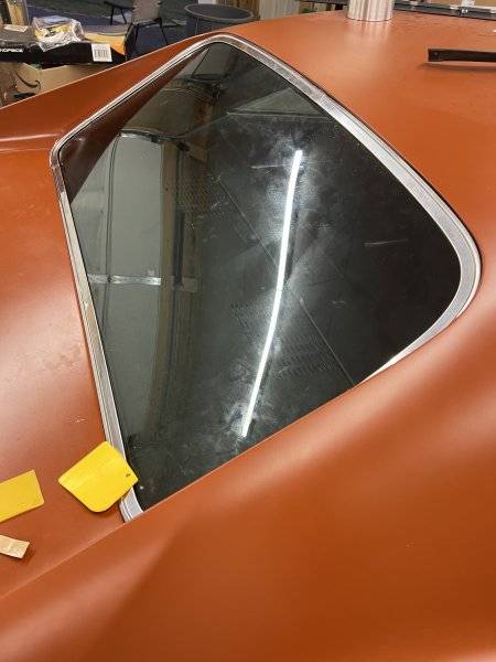

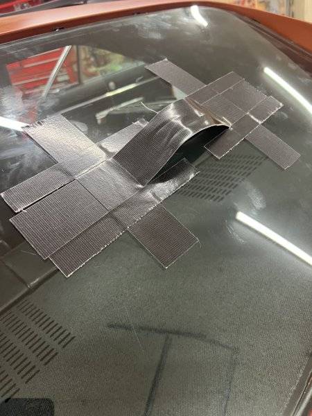

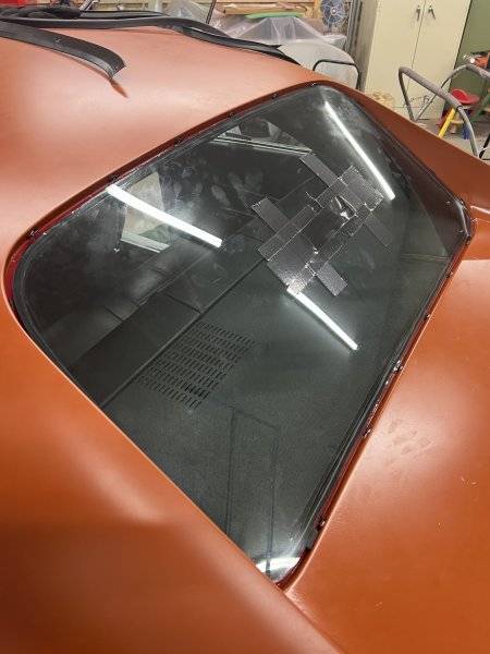

Rear glass is in. I bought both 5/16 and 3/8 butyl. I cut a piece off each, stuck it to the glass and the 3/8 was the way to go when I compared the measurements to the pinch weld and trim clips.
Worked out well, trim went on nice and tight. I still have to fiddle with one corner but I’m done for the night.
Only a couple loose ends and I’m ready to run it and go from there

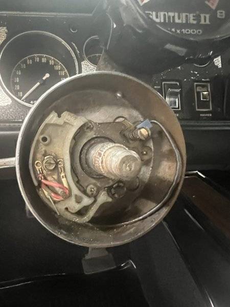

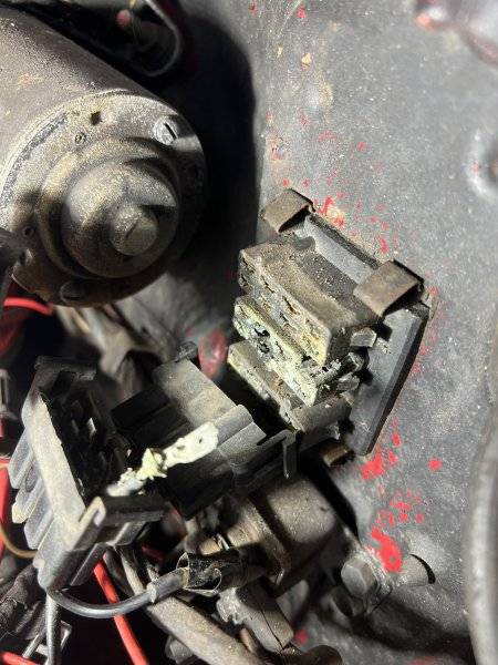

I’ve been on the charger hard the last few days. Chasing electrical problems. No turn signals, no hazards. Sprayed the switch and got front hazards and no rears. Saw the rears go once. Stop, park and headlights work.
Bypassed the dimmer and got most of my gauge lights.
I have a new turn signal switch on the way.

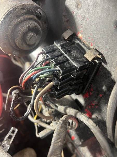

I found a melted firewall connector and repaired it for now
I made a new wire for power from the starter relay. I was able to tighten the connection and slip that wire thru, connect it and then slip the harness plug over the wire. Went well, nothing got warm once power was applied.

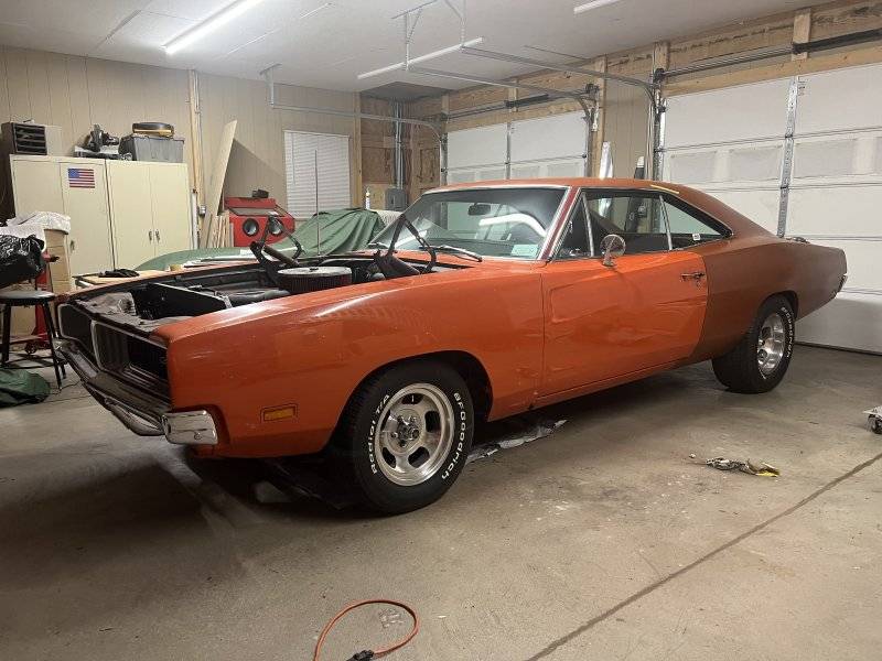

Today I finished getting my tailpipes back in and tightened up, put my steering wheel back on, put 5 gallons of gas in and it’s running!!!
It’s been a couple years since I heard it run. Sounds good, idles good. New shifter set-up seems adjusted well.
I backed it out, moved it around in the driveway. The brakes feel funny. It has some kind of aftermarket 4 wheel disc set-up installed before I got it. I’ll start with bleeding them and go from there!

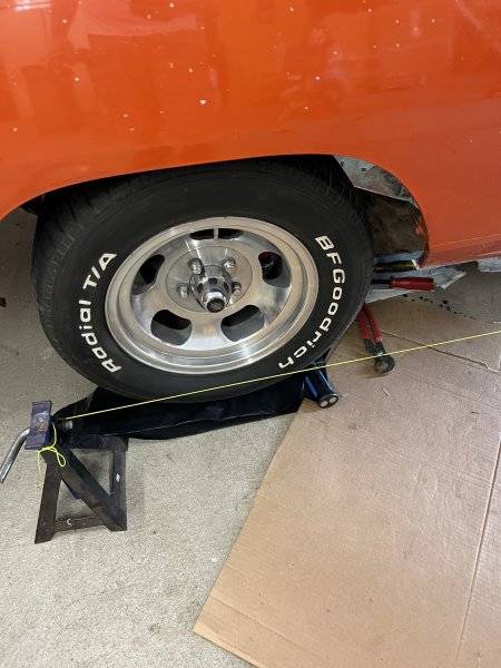

Alignment time— well toe anyway. I could see the front left toed out in the driveway yesterday.
Set up some strings and jackstands and sure enough the front left was out 1/4 of an inch. I’ll be rebuilding the front end soon enough.
I got it to about 1/16 to 3/32nd using various measuring tools including my own eyechrometer.
Drove the charger today. Goes good!! The new turn signal switch doesn’t return to center 100% and I’m going to need to do the rear. It’s got a 3.91 sure grip and it hoooowwwwllllss!!!! I’m going to check the oil in the rear tomorrow and change it.

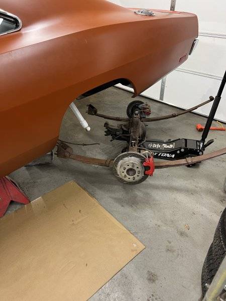

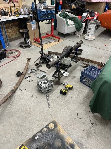

I pulled the rear for the noise, it howls loud.

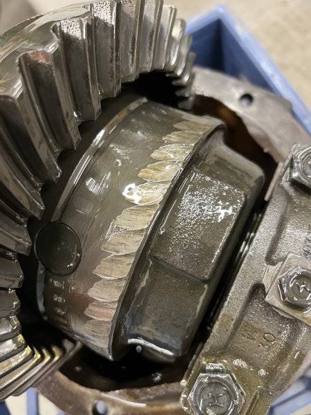

Popped that out in an hour. Then took it apart and found this!!
But… turns out it must have been past damage, everything here looks good. I cleaned it out and seems like it’s pinion bearings.
I’ll get some parts and have at it. The outer axle bearing seem nice, so I’m going to leave those, for now anyway.
