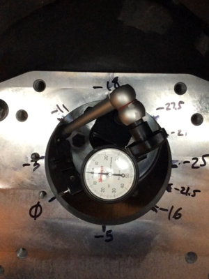

The base of the dial indicator is magnetic with an on/off switch. I had to mess with the damn thing for quite awhile to get the rods and knobs to clear as well as the gauge itself. Some suggest to get someone to rotate the crank from the front while another person reads the gauge and records the numbers. I did it myself using a breaker bar and socket, moving the crank about 1/8 a turn at a time. It is also suggested to remove the spark plugs to allow the engine to spin easier. I had the right side plugs out to get the header loose but the LH plugs were still in.
The first thing I did is to set up the gauge and pick a starting point. I started at the 10:00 position and set the gauge face to ZERO. I had some contact to the pilot hole with the knobs which affected the numbers so I wiped the numbers off and started over.
The goal is to start somewhere, set the gauge to ZERO, make a full revolution and have the gauge return to zero.
When the gauge dial was not in view, I used a mirror to see.
The above picture was my 3rd attempt. The 9:00 position was my ZERO point, from there the numbers grew. This means that The bellhousing is half of the .027 off center to the right horizontally. To be perfectly centered, it needs to shift .0135 to the LEFT. The offset dowels that I bought are the ones with the smallest offset, .007. I need to call Summit and order the next size up.

You have one to many zeros to the right of your decimal point.... .0007 is 7/10 of one thousandth of an inch....
Also either your readings are off or your hole in the bell housing isn't round...
27 + 0 = 27
20 + 2 = 22
13 + 10 = 23
20 + 8 = 28
26 + 4 = 30
If the hole is round (I'm betting it is) they should all be equal...
I rounded up on the numbers. There were a few that were at 1/2 a number.
I'm going to order the .014 offset dowels. That is the next size up. This will put the bellhousing to almost zero runout.
The measuring points don't all oppose perfectly either. I might see about doing this another time with the Wife watching the dial. I could put marks at equal distances to get the math right.
The way you have your indicator set up isn't going to make your job any easier, you want that thing close to centerline and as close to a 90 degree angle to the bore as possible. Weird angles can make them chatter or pull. I agree with 1 Wild R/T, check in 4 locations to simplify. I'm sure you already get this but always end where you started and make sure it still reads what it did previously, those magnetic bases move pretty easily.
I agree. It can't be done with this dial indicator. The rods are too long, the brackets and clamps are too big and clumsy. A smaller and more compact unit would have made setup much easier.

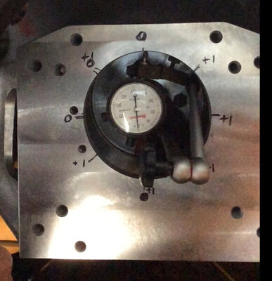

i did my alignment with flywheel on and the following mag base from amazon - looks like it will work with your gauge - Clockwise Tools MGBR-01 Magnetic Base Stand for Digital Dial Indicator Gauge 176lbs Max Pull
by Clockwise Tools:
https://www.amazon.com/dp/B07KPY6ZC3/ref=cm_sw_em_r_mt_dp_jGYbGb13AKH4G?_encoding=UTF8&psc=1

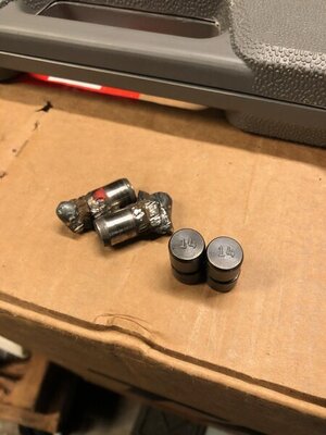

also i used the Summit 14’s dowels in my 440 block no issues. hardest part was getting out the originals....i heard a big whoosh of 1966 when each got pulled out.
and i found it easier to video the alignment and check every few pulls of the crank....tedious but got it within a thou
