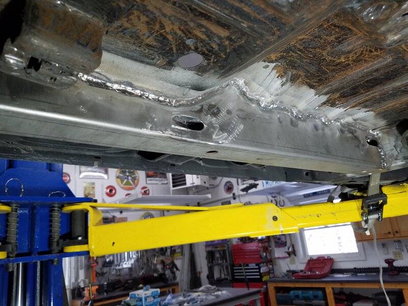

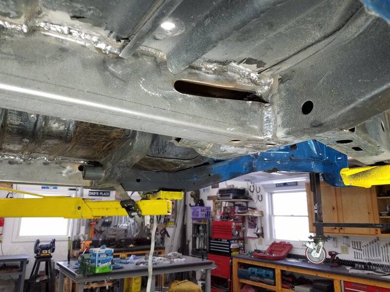

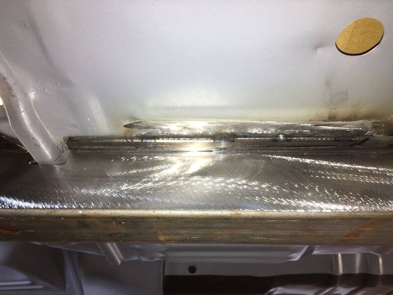

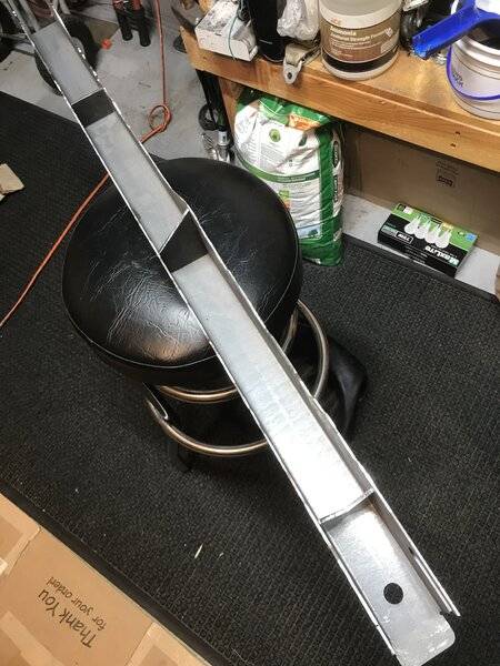

I just installed my first set of those connectors. I, like you thought they should have more reinforcement. Did about the same as you with 1/8" flat stock. Also added a 1/2" pipe diagonally through the drivers side for the e-brake cable and cut the slots out bigger to be able to get the fuel and brake lines th through later. After all was said and done, I know that I'll never use them again. 2.5 x 1.5 tubing, a flat piece at the front, and a u channel in the rear works just as well. All brake and gas lines work with no mods, and a whole lot faster to install. Not to mention the cost savings.

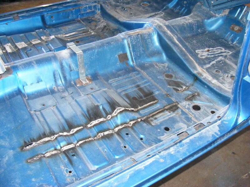

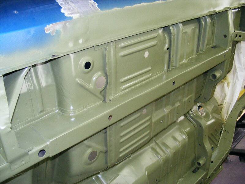

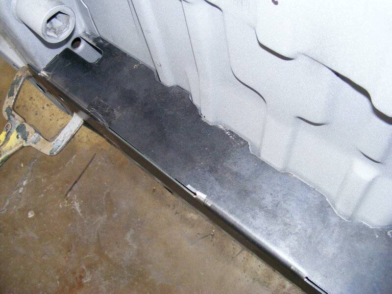

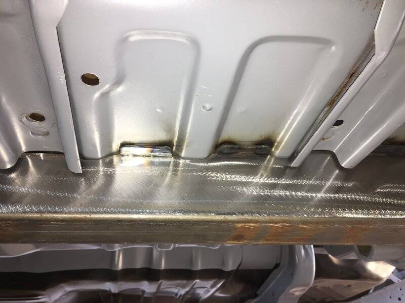

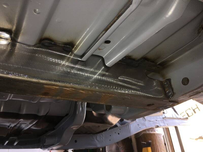

Sell those pieces of crap and use 2 x 3 square tube and you'll never regret it. The fit on those is marginal at best. When I asked the US Car Tool guys how they compensated for gaps as wide as 1/2" they replied "get a guy inside to push down on the area" !! Hmmm, isn't that putting stress where it doesn't belong !! Here's how I did mine:
IMG_1474 (2019_07_25 23_14_58 UTC).JPG IMG_1476 (2019_07_25 23_14_58 UTC).JPG IMG_1477 (2019_07_25 23_14_58 UTC).JPG
Ive installed 3 sets of USCT SFC's and would say that while they do require some fitting I really like them. Of course there is more than one way to accomplish a given task.
Thus allowing flex in the pans.
Yikes !! So you cut HOLES in the pans and then you don't reattach them. Makes NO sense at all ! You're installing connectors to make things rigid - including the floors !!
Take into consideration the original stiffeners were bolt in units. No cutting required. Wish I had taken a picture of those but had no camera that day many years before cell phones with cameras.
John at US Car Tools said to run a full length bead all around the frame connectors. Thats how mine are. And it turned out very nice.

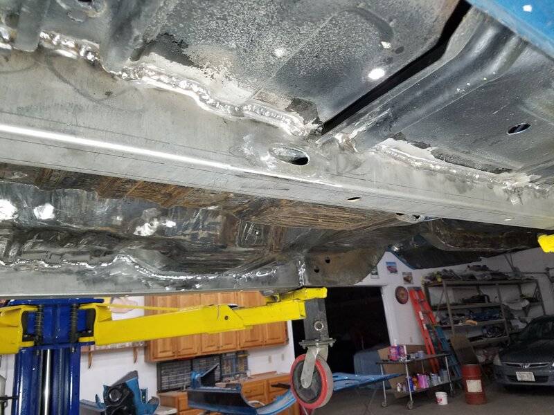

When using 2 x 3, the 2 is width and the 3 is height. The pans get cut in the rear floor area and then welded to the connectors.
I usually notch and box the opening area of the 2 x3 height so i don't have to enter the floor pans. Us car tool has their way but sheet metal floor pans provides no Structural value in tying to the floors.
The floors ARE the structure on a unibody. Their the only thing that ties the front and back of the car together, that and a little bit of roof, again sheet metal. By welding the sub frame connecters to the floor it's way stronger. Imagine grabbing a wall stud, it's only nailed on both ends, it's wouldn't be that hard to rip one out. Now imagine grabbing that same stud that also has plywood nailed to it, your not going to move it. Try it with just sheet rock, less strong, some may argue like a sheet metal floor, you still aren't going to move it.
The floors ARE the structure on a unibody. Their the only thing that ties the front and back of the car together, that and a little bit of roof, again sheet metal. By welding the sub frame connecters to the floor it's way stronger. Imagine grabbing a wall stud, it's only nailed on both ends, it's would be that hard to rip one out. Now imagine grabbing that same stud that also has plywood nailed to it, you not moving it. Try it with just sheet rock, less strong, some may argue like a sheet metal floor, you still aren't going to move it.
Actually you would think so but not in reality ther heavery sub frames are the structure. The floor pans always have had a buckle problem in the past. But hey your entitled to your opinion.
