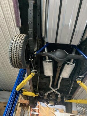

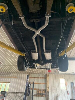

I went with Wrapped TTI 1 7/8" into the TTI xpipe exhaust everything fits no "Adjusting" was needed and have not hit them once on the road. More worried about smacking that 7 QT oil pan TBH.
