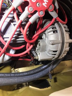

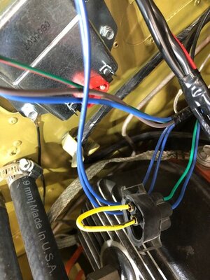

Hi folks 69 GTX here with 70 style voltage regulator. I just replaced the regulator because it refused to send any signal to the field wire (green). The blue wire is definitely getting power. The case is definitely grounded. If I jump the field wire the alternator charges, ammeter shows it charging.
1st pic: Here is the regulator with the jump wire to field - its the only way I can get the alternator working
2nd pic: The single field alternator

You can't use the later style regulator with a single field alternator. The green field wire varies the ground side of the field, your alternator has the field grounded by the case. Get a later style alternator or earlier style regulator, you can't mix the 2.

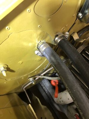

Run that ground wire to the engine. There is an open bolt hole at the top rear of the right side head. Near the intake bolt. The factory had one there and you need it also.
Right now the firewall connected to the firewall with a wire. It’s doing nothing.
Do you have a blue connector at the alternator? Do a continuity check between it and the regulator. If that is wired correctly it will be easier to change the alternator.
The ground strap you see there goes to the bolt you are talking about.
That's the type he has which won't work. He needs the earlier type. I checked rockauto and they show Standard Motor Products VR101 but it is not in stock, you may find it elsewhere. Check through the wiring harness to make sure the previous owner didn't screw anything else up!!! Get a manual here: Service Manuals – MyMopar
I think you are right on the VR101 - I'll try to locate one. But just to be super clear the box is definitely grounded and the blue wire is getting 12V clean. If I jump the terminals she charges. So the idea of a mismatched regulator / alternator combo just makes sense. I'm no electrical expert and I had no idea they changed the way the regulators worked after 69 - apparently neither did the previous owner who told me he "just changed the alternator". Clearly he was struggling and being a classic "seller" passed his problem to me.
It seems that he got the wrong alternator. Check to see if you have both the blue and green wires and if so check continuity to the plug for the regulator. It may be correctly wired for the later style alternator.
The earlier style alternator had one side of the field in the alternator grounded to the case. The regulator for that only had one field wire going to the alt. that varied the voltage to control the output.
The later style alt. had 2 field wires connected to the regulator. The blue wire supplied the positive voltage, and the green wire varied the ground in order to regulate output.

Partially correct.....the current flow is thru the BLUE wire TO the alternator. The GREEN wire runs FROM the alternator to the regulator which, thru an internal transistor to ground, which completes the field current circuit. The BLUE wire at the REGULATOR provides the reference voltage to the regulator for the control point (~14.5 volts at the battery). The alternator's output is controlled by varying the rotating field's current thru the regulator to ground. A verified ground at the regulator is required. Both alternator brush holders MUST be isolated from the alternator's case or frame.
I see a heavy braided ground cable from the firewall that bolts to the engine.
Looks ok the way it is to me.
