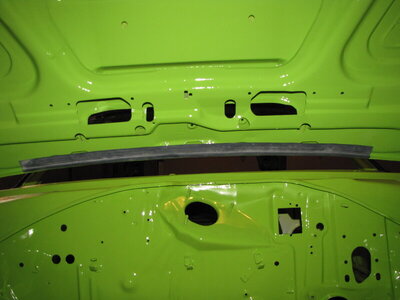

Well, it seems things are going slow. Summer hit and I got busy doing other crap! But, here is one project that was easy enough to get done. The trunk weather strip is glued in! I used the 3M yellow super weatherstrip and gasket adhesive. It worked great and the clothes pins helped keep it in place nice. I spread a thin layer on the car and weatherstrip and let it tack up. Then, another very thin layer on that and pressed them together.
Yes, I know it is supposed to be offset from the latch but I didn't have enough material to work with. This strip came back with my car from the bodyshop and it looks like real nice stuff so I used it.

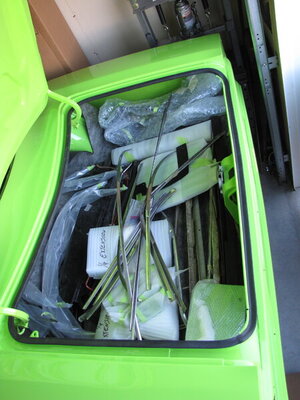

So, I haven't posted much lately but that doesn't mean I haven't been busy. Here are a couple easy enough things that I got done. I ordered front and rear hood seals from Detroit Muscle. I never had the rear one to compare to but the front one looks very close to the original as do the clips. Snap the clips in and you're done. Easy, and I have a bit more shelf space!

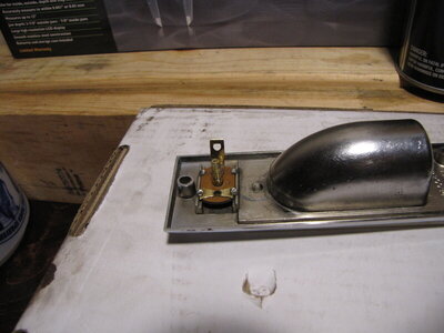

The dash light found its way to my bench so I figured I'd put some work into it. The hardest part was getting the clip that holds the plastic in place off with out breaking the plastic. The chrome is not perfect but I felt it was good enough to bypass a trip to the chrome shop. You could say I cheated by painting the clip rather than get it plated. Oh, well... I polished the chrome, plastic and the electrical contacts. I have a blackening product from Caswell that seems to work pretty good. I'll put the screws in there when I have more hardware to blacken.
