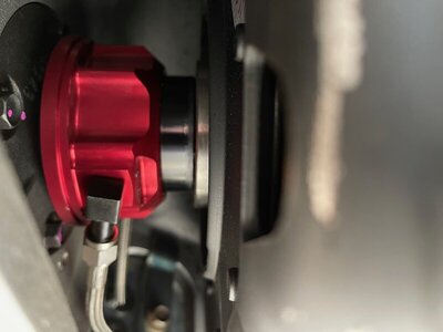

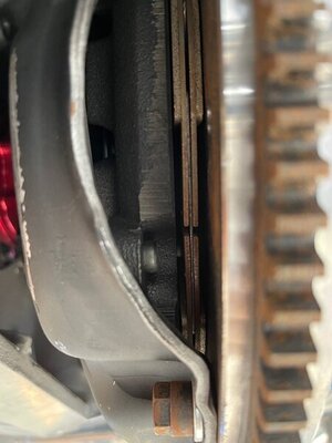

I can not figure this out or maybe I have an idea what's wrong here. Brand new Mcleod hyd bearing and Ram pressure plate/clutch from Silver Sport. Here's a pic of the bearing fully engaged (over .50) of travel and another pic of the space in-between the plate and flywheel. Shouldn't this be a bigger gap? Goes into gear easy without the engine running but tough while running almost like there's no clutch at all. I'd love to talk to someone with good experience here. I'm perfect with 727's but rookie with manual stuff. Thanks!!

It certainly appears you have enough disc clearance. Is something else causing a drag on the input shaft? Try turning the transmission with the clutch pedal depressed to spin the clutch disc.

Looks like plenty of clearance, I only propose this because you mentioned your not as familiar with manual stuff. Was the disc clearly marked flywheel side ? Disc won't function if installed flipped.

Yes. I had it 0.125 then after a few pushes on the pedal it went to almost touching.

Nice thanks. I talked with the guys at Mcleod and they said that their hydraulic clutch is designed to ride on the fingers which mine is so close to doing. I can reach up and spin the bearing with my fingers.
Right they all do. But if you did not set yours up like the instructions say you may not have enough travel on a full pedal stroke.
This bearing is not shimmed. You spin it on the input shaft and it moves in or out.
I think you are wrong. Not seeing your bearing on the bench it is hard to give you exact information. Did you measure like the instructions say?
