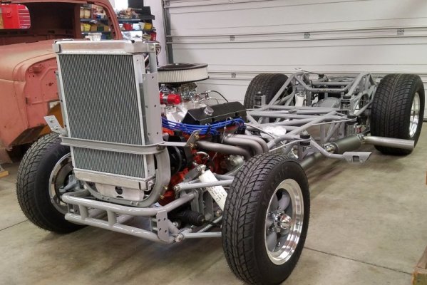

I still get crowds around this
ol' gal. The majority want to
know the year and make.
It's taken a long time to get
it to this point with
everything in this build being
custom. It turns out, the
single most expensive step
is going to be the paint,
which I'm terrible at
applying, and don't have the
money, time, and energy to
complete. I'll leave it up to
my son if he wants to see it
thru.
