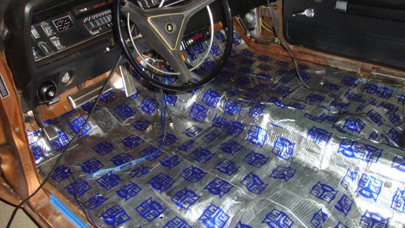

I've seen people cover every inch of their interior with this stuff, I even did it myself.

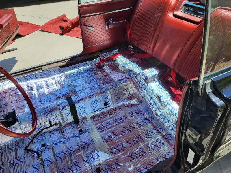

I used Rattle Trap in my red car.

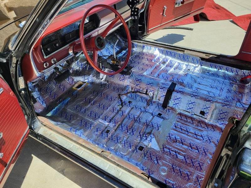

I used Second Skin Audio Damplifier 40 sq ft box on my floor before I replaced the carpet. 200 bucks from Amazon. I'm sure the others are great as well, but it literally feels like I'm in more of a capsule vs riding in a big piece of metal.

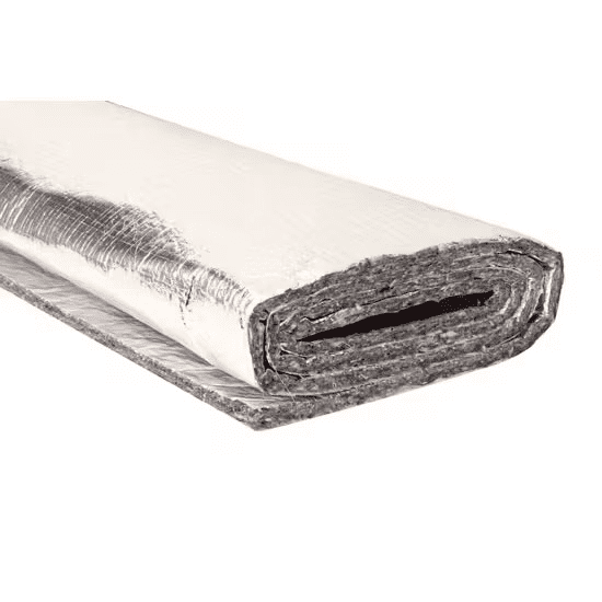

FatMat for noise and foil-backed recycled denim insulation by Bonded Logic for heat barrier.
