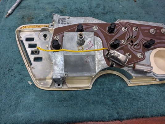

K.. brought my cluster to work to clean it up and put in the new bulbs and stuff (i have a lot of dead time at work) and when i pulled the cluster this yellow wire wasn't hooked to anything, grou although the whole dash seemed to work.. i looked on a schematic/layout but can't find it.. where is this supposed to go? Ground that was behind one of the cluster mounting screws that i didn't notice?
P.S. looking at the trace it looks like a ground, just wanna make sure, hate to let magic smoke escape..

P.S.haven't hooked up that yellow ground.. need to find a spot for it, doesn't seem like it's needed though..
