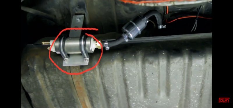

I mounted my old Holley pump on one of the fuel tank mounting bolts. Bent over a header collector flange.
View attachment 1938331View attachment 1938332View attachment 1938333
Very interesting…..i need to come up with something like that…. This is my pump on a different car IMG_7742.jpeg
Yes 66 Charger, it's probably 1" below the tank.

Very interesting…..i need to come up with something like that…. This is my pump on a different carView attachment 1938337
Wow.. that's exactly what I did before moving to the frame. It worked quite well... until I started really putting demand on the systems and went a different direction. But, what's pictured is a solid solution... been there, done that and was happy with it.

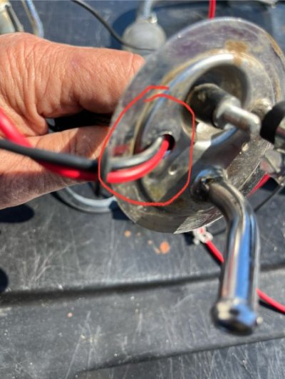

Yep, but here is what I’m up against. The car came to me unfinished, and tank empty, thoroughly cleaned. The picture here is where a 5/16 hole drilled into the sender base plate for the pos and neg wires. Note only a rubber grommet used … so im sure once fuel gets to that level it will pour out. I’ve searched and searched for a gas proof leak proof fitting to use there, but all are about 3/4 hole needed. The base plate is not exactly flat, that hole size will not seal. Hence my wanting to go externalIMG_7757.jpegIMG_7756.jpeg

Yep, but here is what I’m up against. The car came to me unfinished, and tank empty, thoroughly cleaned. The picture here is where a 5/16 hole drilled into the sender base plate for the pos and neg wires. Note only a rubber grommet used … so im sure once fuel gets to that level it will pour out. I’ve searched and searched for a gas proof leak proof fitting to use there, but all are about 3/4 hole needed. The base plate is not exactly flat, that hole size will not seal. Hence my wanting to go externalView attachment 1938356View attachment 1938357
Must be some gas resistant silicone that you can seal it up with?
Ive heard “seal-all” is good, not sure if I would seal the hole using a rubber grommet, and I don’t even know if the rubber grommet will stand up to being in gas…:BangHead:
Tanksinc sending unit eliminating kit.
Has the best gasket for gas.
I know Summit has them.
Threaded C ring, bolts with o-rings, metal cap, gasket, not the cork gasket, the other one, neoprene iirc.

Ummmm. IM not looking to eliminate my sender, just want to seal the wires where they pass thru it
